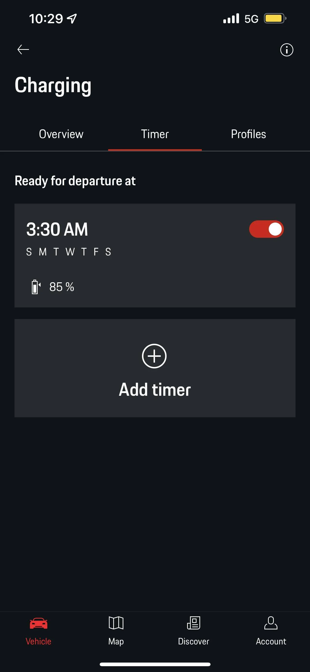

Except it didn't for me this week, I double checked and woke up and it was at 100%. I believe something rebooted and it lost what I had set it to. :mad:
Must be, because I have used that method on both of my Taycan and it has worked 100% of the time for over a year.

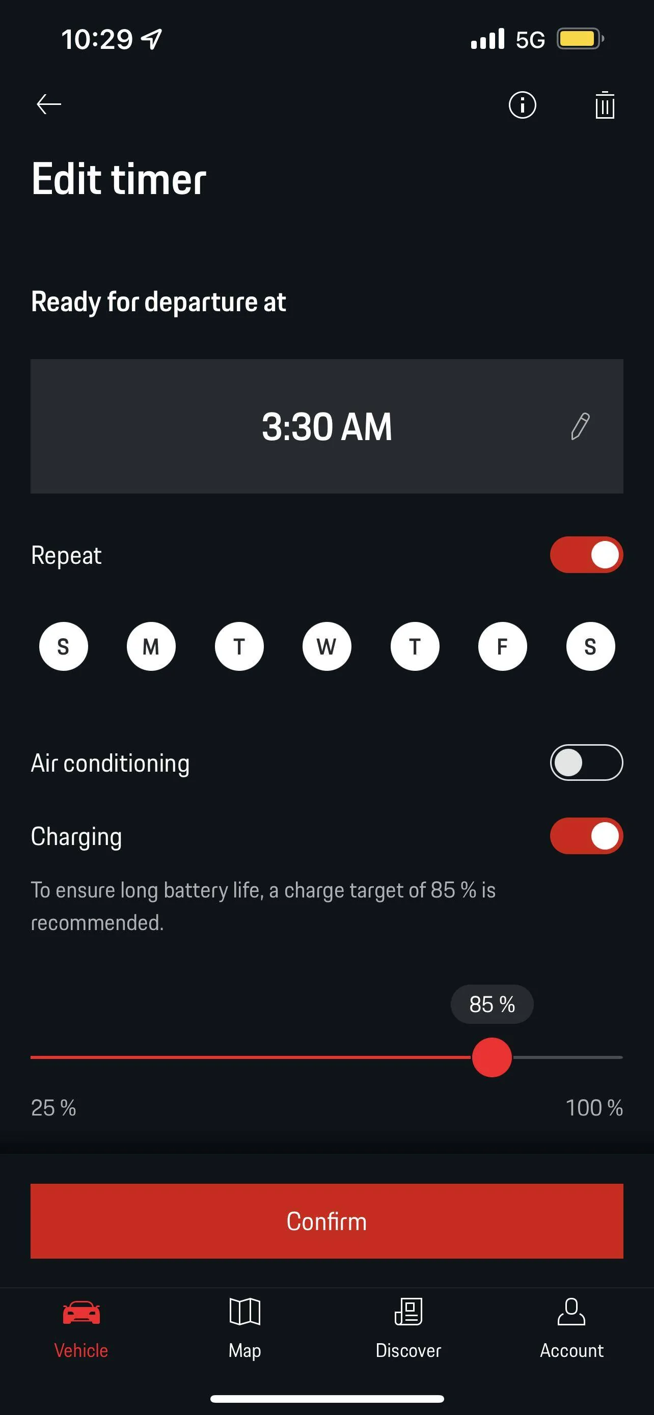

Yep, just timer works best for this purpose. Set it for the target SOC, and end time of your cheap rates. Works 100% reliably.
This works for me.
I believe you need to have the timer "repeat" every day, or after so long (30 min?) the car starts charging again to 100%
