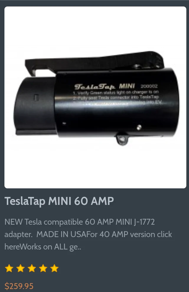

Also I wanted to mention one of the interesting things I saw in the video is that the end where he talks about a new model from Tesla tap that they do charge a premium for but is quite tiny to keep in the vehicle.
http://www.umc-j1772.com/index.php?route=product/product&path=17&product_id=146
Would you recommend to get the Tesla tap Mini 40 AMP or 60AMP if it is intended to be use occasionally at Tesla Destination chargers (i.e. Ski resorts, hotels and such) ?
Is there a risk to use the 40 amp while the tesla charger at destination is more potent ?
160
5,810
8,647
better safe than sorry - the Taycan WILL charge at 48 amps (60 amp breaker) if presented with a 48 amp EVSE (Tesla or Otherwise) - the amp ratings are about heat management - which means if you are charging at 48 amps on a 40 amp rated “thing” - it might heat up and in extreme cases melt/short/catch-fire…
since you really don’t know I believe it’s best to have the “thing” able to handle 48 amps or more - if it fails it won’t fail gracefully if it’s “under specification”
