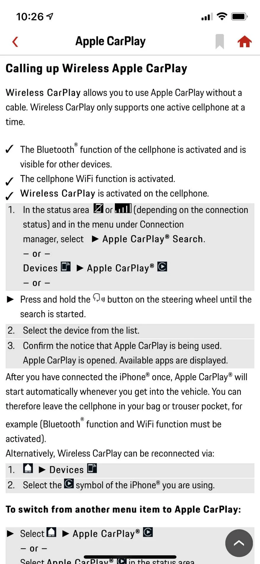

What I have learned is to have Wifi on but not connect it manually to the car. I went into carplay settings of the iPhone where you can establish a wireless carplay connection. After that I just connect my phone through bluetooth with the car and I can start carplay through the carplay button on the screen.

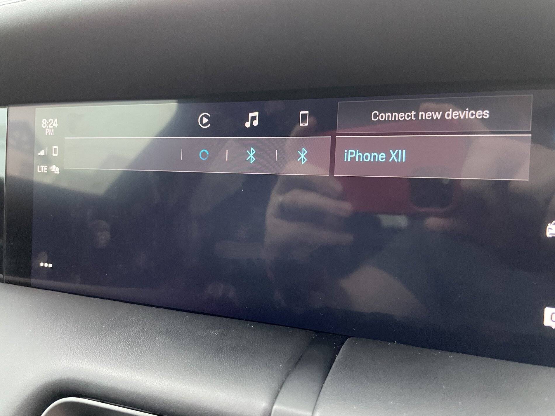

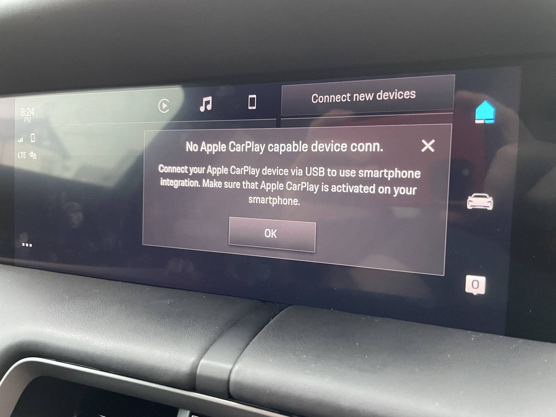

Hmmm thanks for the suggestions. I've tried all the above and it just hangs. On the first photo the CarPlay logo just spins for a few seconds and gives up. I have tried activating by USB as well and it works until you unplug it then won't connect wirelessly. Such an unintuitive process!
Interestingly I have slightly different menu names to the ones in the guide from submatrix ?
Porsche Taycan How to get Wireless CarPlay working? IMG_1132
Porsche Taycan How to get Wireless CarPlay working? IMG_1133

Delete the device from the PCM and PCM from your phone.
Start over using the instructions from the Porsche Good To Know App posted above.
