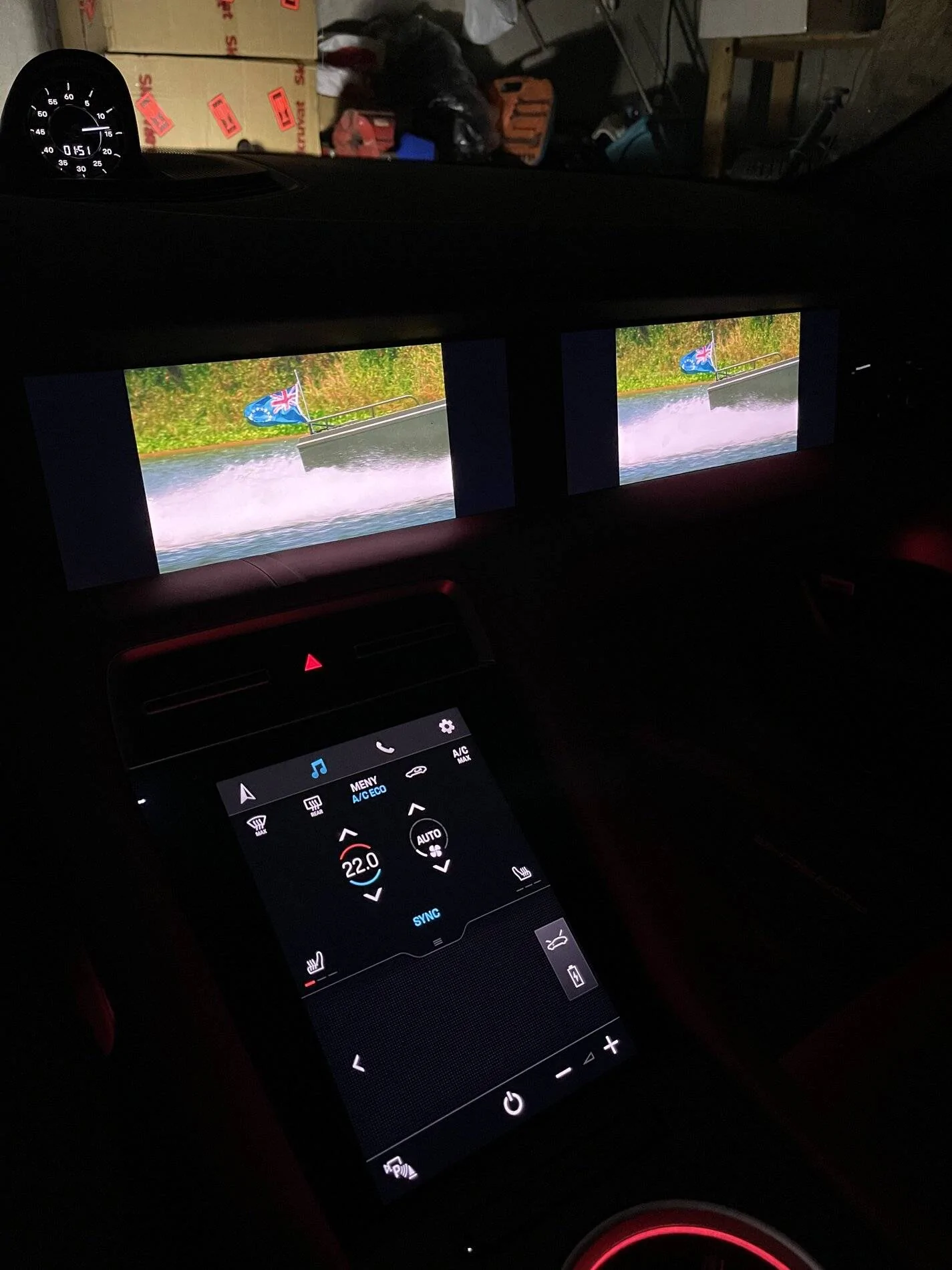

I took a photo of the screen and tried to calculate the aspect ratio. I seem to have landed on around 64:25, so 1080p would be 1920x750, and 720p would be 1280x500. This is, however, not the resolution of the screen. Can't be assed to count pixels at the moment. Perhaps someone with some spec sheets could chime in and also help us get the pixel perfect ratio.
It's 6am and I've yet to sleep. No way am I going out in -10 to verify if I'm missing a few pixels or whatnot.
Now, cropping movies that are 16:9 down to this would be heresy and I'd advise only doing so on movies running any form of ultra wide aspect ratio (2.39:1, 1.66 etc etc). A 1080p ultrawide would be about 1920x800, so taking off 25px at the top and bottom would be acceptable.
If using Handbrake I'd advise just sticking to the Fast 1080p30 preset and doing the following:
Under Summary:
* Check "Web Optimized"
Under Dimensions (if cropping) See edit at the top
* Set "Height" to 750
* "Cropping" to Custom
* Top to 164, Bottom to 166. EDIT: These are kind of dependent on your video. You want PAR to be 1x1. My values come from a 1920x800 resolution movie that has the black bars baked in so it's detected as 1080 while actually being 800. So 1080 - 750 = 330. 164 + 166 = 330. :)
Under Video:
* Set "Framerate" to videos framerate (if VLC: Tools -> Media Information -> Codec tab, under "Stream 0" find "Frame rate".
* Set to Constant Framerate.
* You can change from "Constant Quality" to a variable bitrate if you'd like to save some space. I'd say an average of anywhere between 5000 - 8000 for 1080p would be decent enough since this isn't, well, a movie theater experience. Just be sure your USB can actually be READ this "fast". Many drives can be very slow.
PS: Write doesn't matter (though transferring TO the drive will be annoying at low speeds.)
* There's no need to change Encoder Preset to anything higher than Fast. The screens are too small, and we sit too far away. If you have a good enough CPU and extra patience you can set it to Medium. Your choice.
Under Audio:
* No clue if the various sound systems supports REAL surround or if they're always set up as all-channel stereo, but the car will play audio with the mixdown "5.1 Surround" at the bottom. Yet to try "Dolby Surround". Again, 6am as I'm typing this. ?
Under Subtitles:
* Ehh I don't use 'em ever so not familiar with what you'd want to do here. I guess you'd have to use "Burn In" as the car didn't seem to have a way to enable subtitles.
Once you're done you can hit "Save New Preset"
Pictured: grand tour 16:9 on both screens. Passenger just has to hit the "Media" button and then the fullscreen button.
Under Summary:
Under Video:
Under Audio:
Under Subtitles:

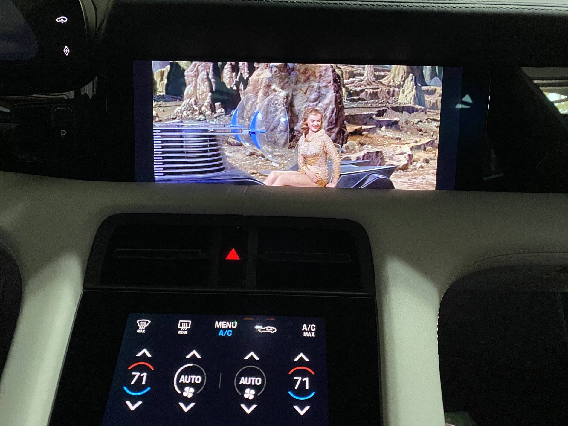

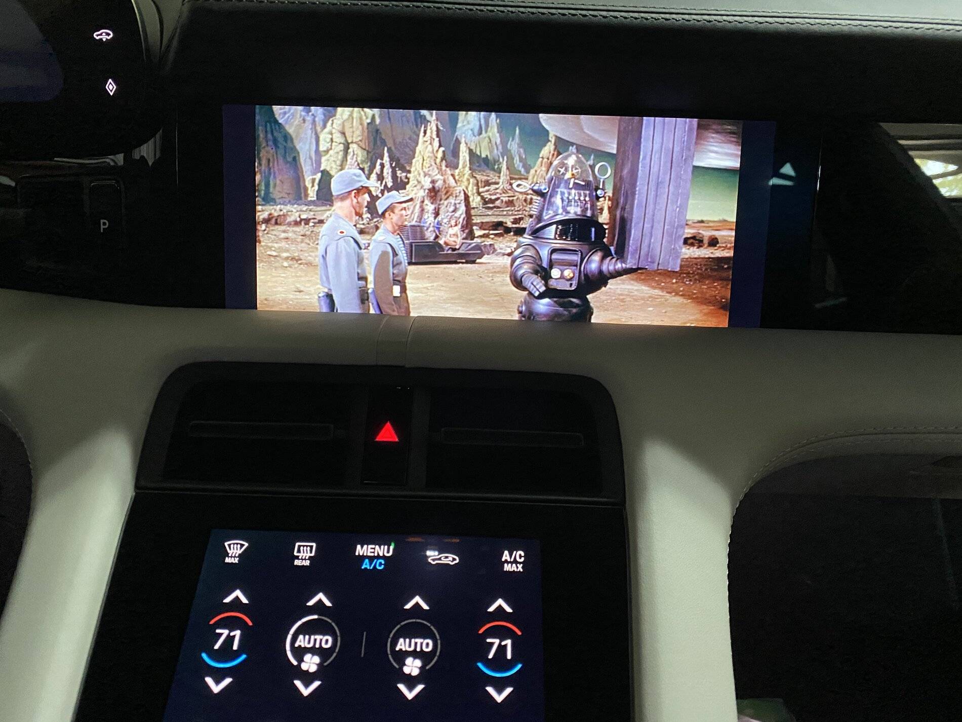

I’m getting pretty nice wide screens with movies ripped from DVD‘s using 720p output settings in Handbrake.

Porsche Taycan How to play VIDEOS in the Taycan's PCM Screen 10B238D8-58FC-4864-A8D4-11C575AD077D
