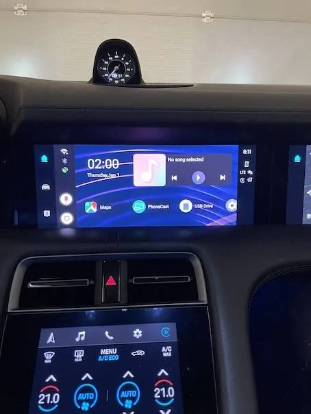

I write to MMB team for the problem of touch.
This is my problem
This is my problem
Very strange ! I don't have this problem and the keyboard is a bit slow sometimes, but it is very usable.
