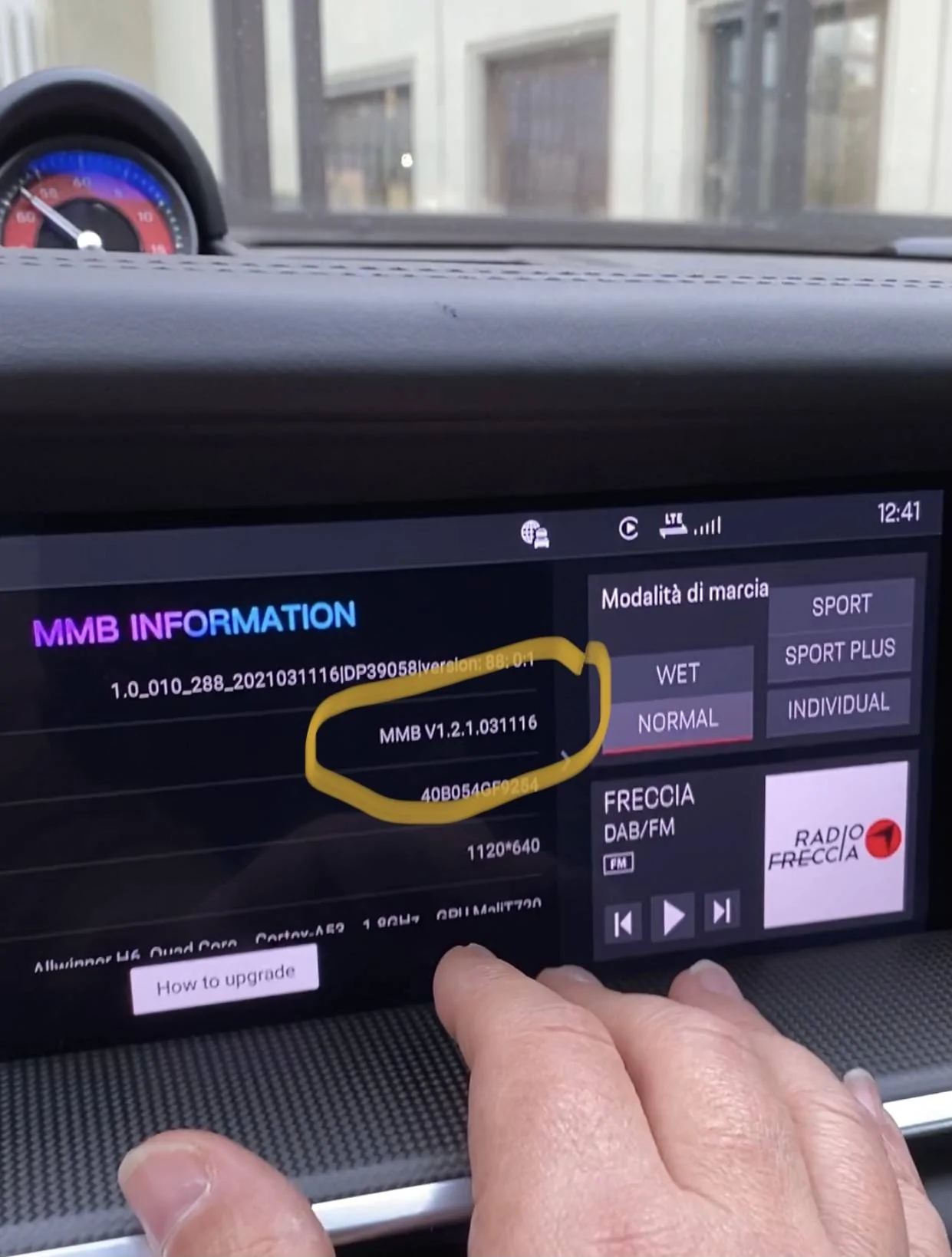

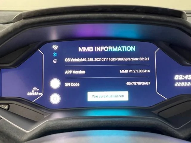

MMB Support told me that the patch is not needed anymore. The latest update will remove the patch.
No, the update don’t remove the patch.
If you made update after patch the patch still remain i attach photo (second photo) after update with patch installed before.
I’ve seen that the patch was still here and i made factory reset.
After this mmb don’t work on taycan and i installed the patch again to work.
If you make a factory reset after upate you remove the patch but without patch with update the mmb don’t work on Taycan MY21
I’ve seen this on 911.(look the first photo).

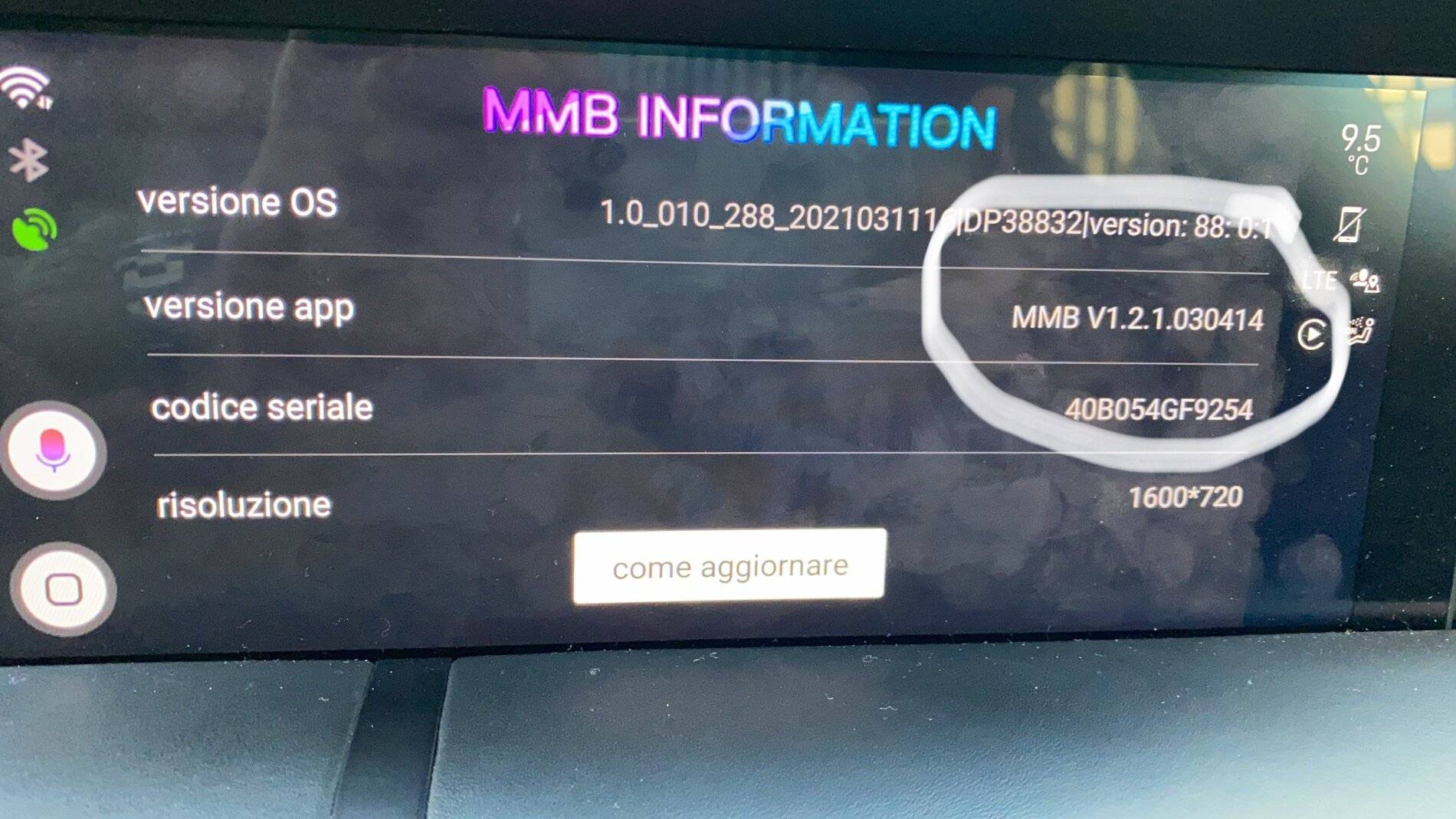

If you can look the version app, if you have MMB V1.2.1.031116 you HAVE NOT patch
if you read MMB V1.2.1.030414 You HAVE patch installed.

checked. its on V1.2.1.030414 but doesnt work on my2021 taycan..

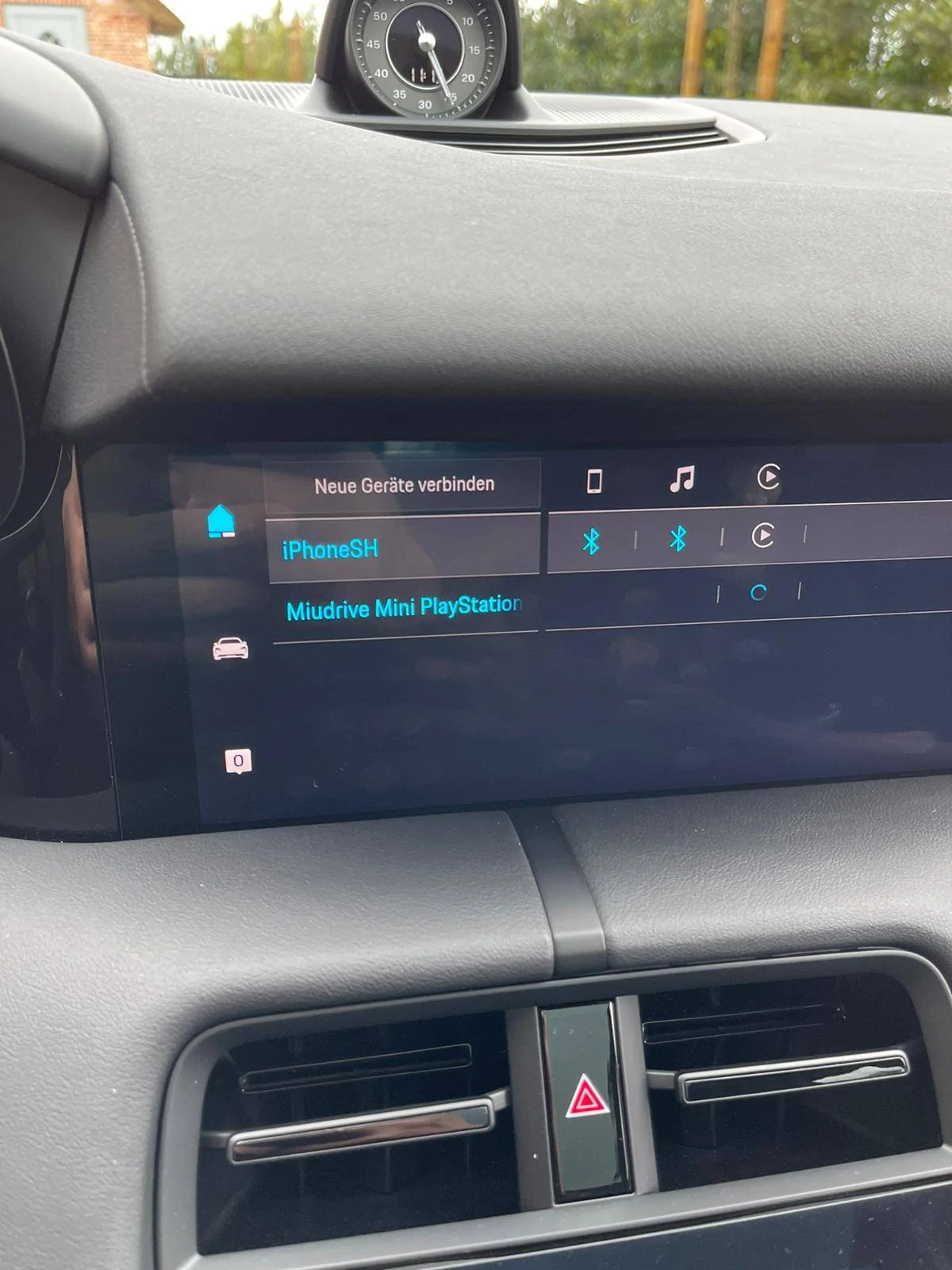

yes, he uses the usb-c cable with the USB Logo on the taycan side. (USB1 connector)
It is detected as Miudrive Mini PlayStation and won´t connect.

Try to delete the Miudrive from connection (with left swipe) and reconnect again
Be sure that the usb logo is on the taycan port
