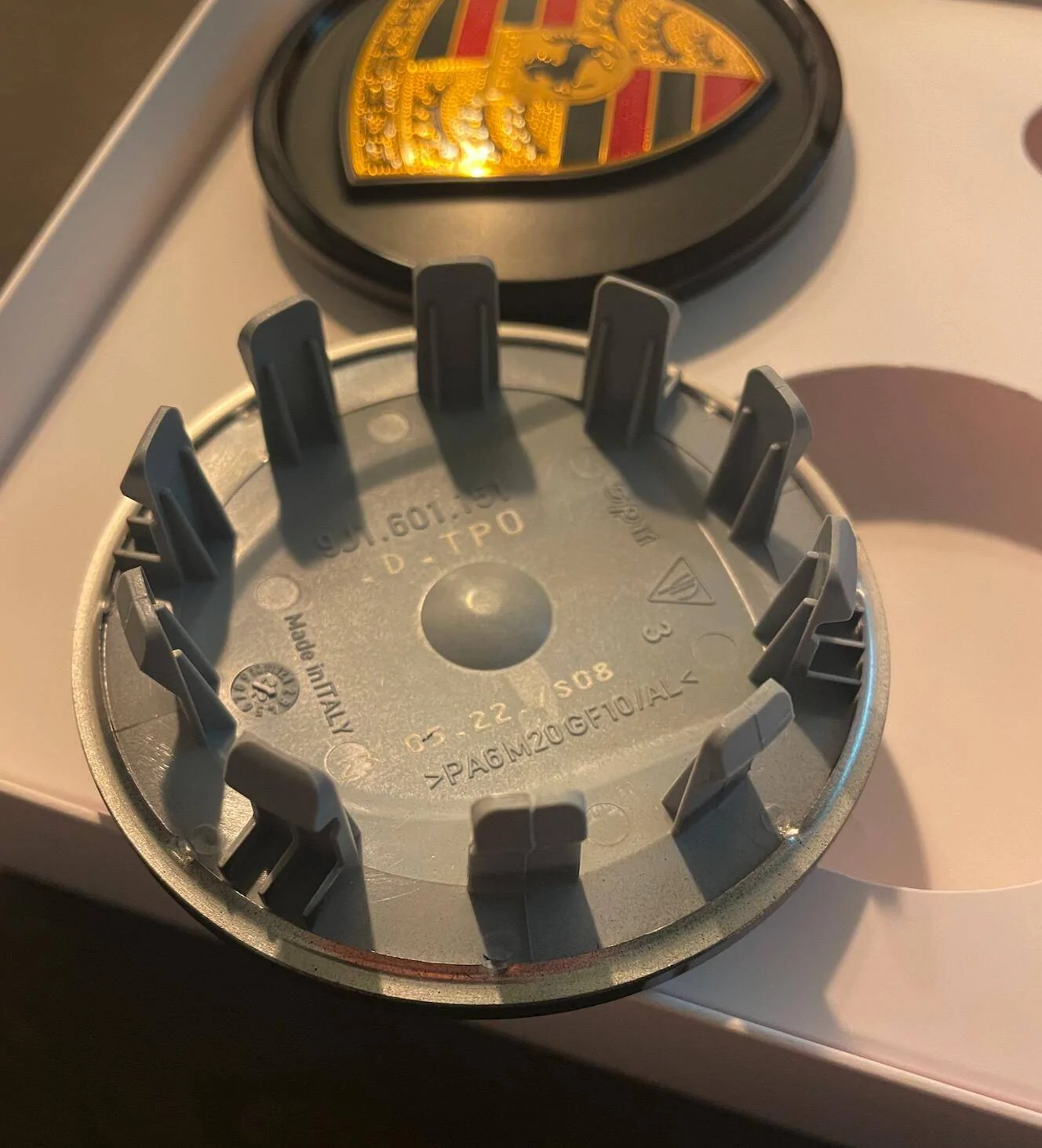

I purchased a set of gloss-black wheel centers for my mission-e wheels, and I was wondering if anyone has successfully swapped them out themselves? Of course I can have the dealer do it but would like to avoid the hassle.

Just push the old ones out from behind (you have to take the wheel off), and push them in from the front. Otherwise, you can use a tiny Allen wrench and put it through the hole, pull, and then pull out. Push new ones in from the front.

No reason to take the wheels off, just use a plastic trim tool around the edge and they pop right off.

I replaced mine without taking the wheels off. I used a plastic tool removal set to slide between the rim and the center cap. It was not easy but with patience you will get them to pop off.

That could be. I only remove them when I swap winters for summers, so I don't use the hole.
Don't try to pry off from the front. Some idiot did that to my Tesla wheels and marred both the caps and the wheels.

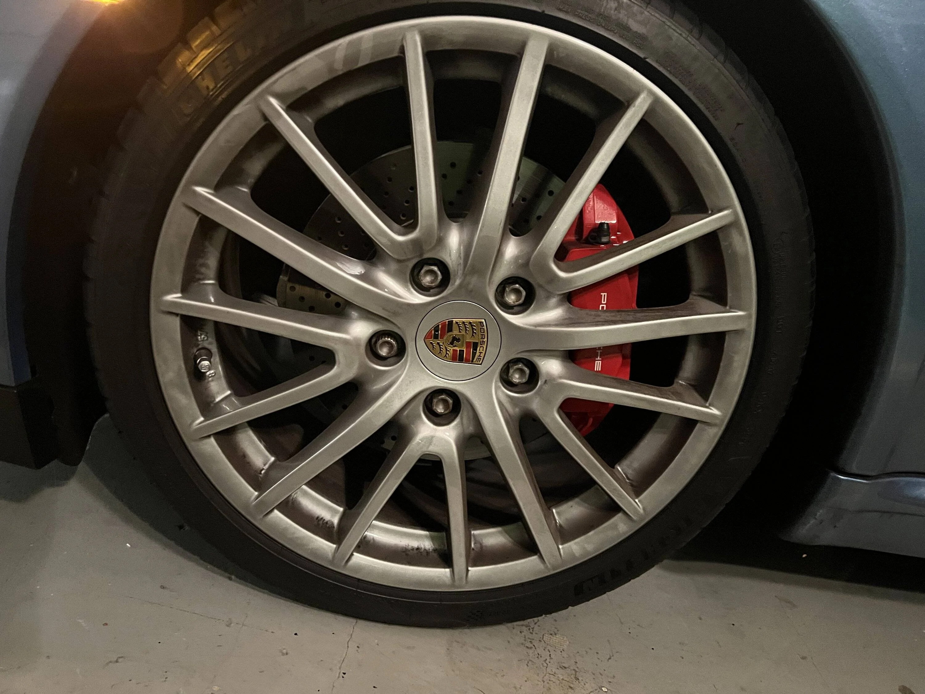

He means this: https://www.suncoastparts.com/product/99957107430.html
also, here are the properly oriented caps;)

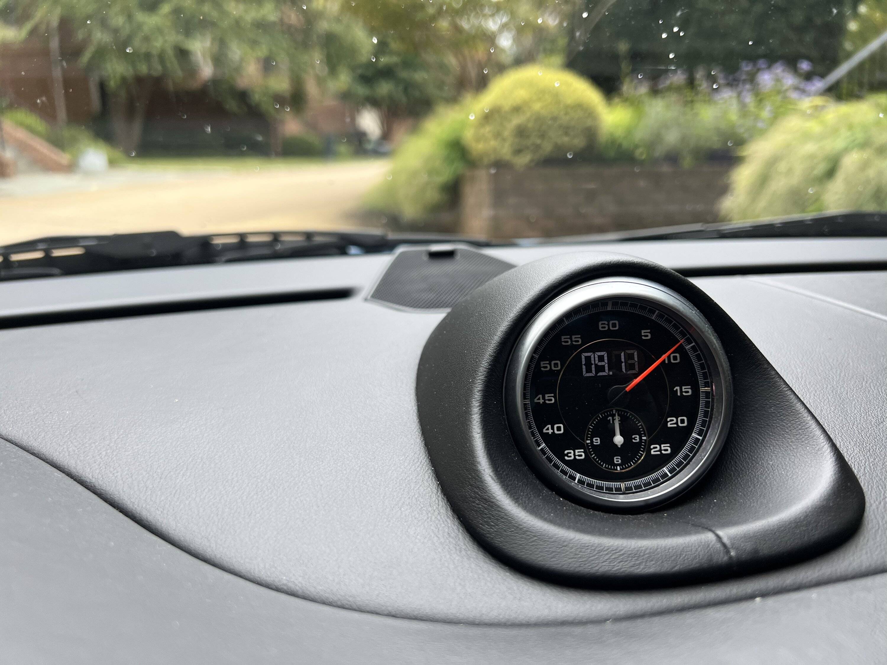

and If you really want OCD, 911 owners setting sport chrono on 9:11:rolleyes:
