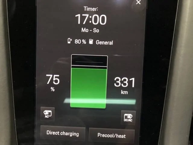

Yes. A normal profile with the "minimum". The naming can be a bit confusing, but in a sense one can think of it as a minimum. Or maximum. Or a target. But what actually happens is that it charges to that number and then stops.
The button to override the profile and to charge straight to 100% is in the main charging interface where one can see the charge level and how fast one is charging (accessed from the screen where one controls the AC stuff and also opens up automatically when you start charging).
There you have 2 large buttons at the bottom "Direct Charging" and "Preheat/cool". The former is the 100% charge button (direct charging means overriding all profiles). Latter enables cabin cooling/heating while charging & car locked.

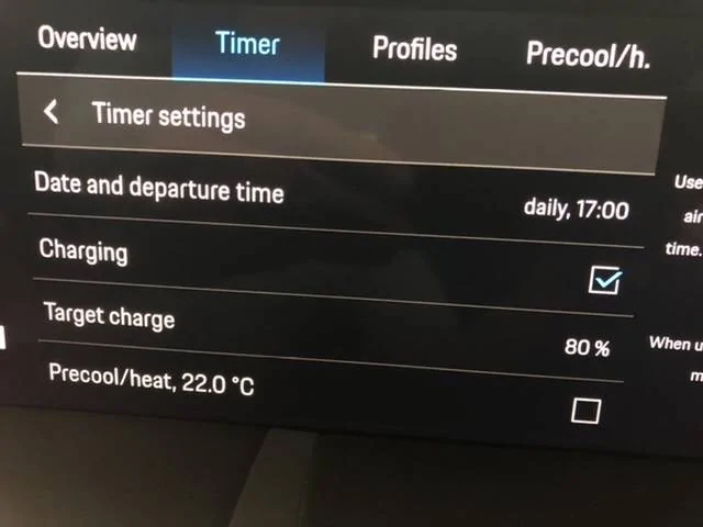

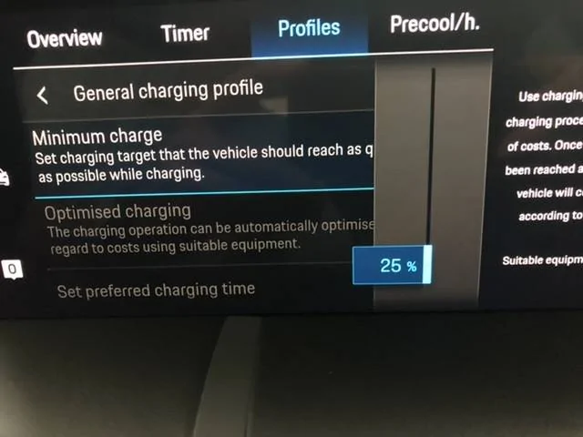

Sorry just to clarify a bit more here. The 85% is a target charge and not a minimum. The minimum charge can be set but in standard it seems to be set to 25%. If you have a charger with say 11 kW then you can set a target charge of 85% to be achieved at say 17.00 hours. If you park the car at say 09.00and the car has say 50 % charge left, it will calculate when the charging should start and be finished by 17.00. If the car is below 25% then it will start directly and charge to 25% and pause there. It will then resume charging so that it is charged at 85% at 17.00.
Atleast that is how my car charges and also the way it is described in the manual.

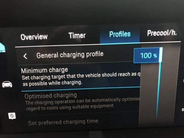

Yes you are correct it is a timed profile. But my general profile is also activated and gives the result I stated. See photo,
Porsche Taycan How to set to profile to only charge to 85% 7CECBE43-AE37-4DFC-A942-8D60167D27E7
Porsche Taycan How to set to profile to only charge to 85% B02564F8-DF89-498A-960F-F20B8DC9D5B7
The benefit I see in this approach is that I can set the precool or heat for wintertime to be at the time I want to depart. The heating or cooling Power is then taking the from the supply and not from my battery.
And in the general charging I can set the minimum charging between 25% lowest up to 100% if I so wish

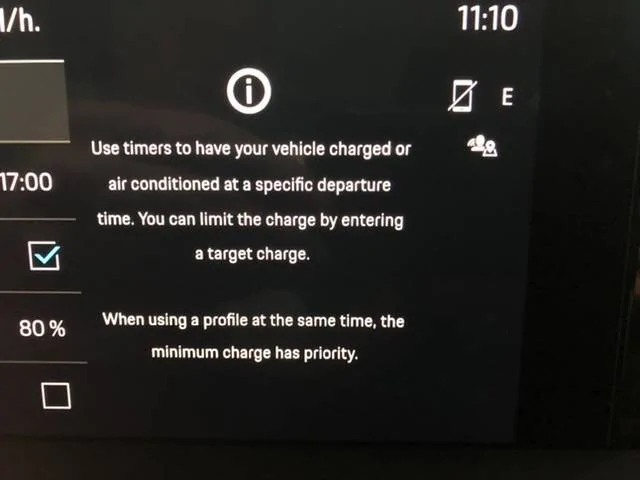

Timed profile must override the normal profile then. Delete the timed profile and set a Daily drive 85% & a Road trip profile at 100%. Assume you can have more than one profile. Just to be clear, I'm learning here as well. I dont have a car yet. Thanks for the pics, seems straightforward enough.
3,087
2,690
I think it actually is the other way around? See photo.. For me the main thing is that it works fine! And I do not want to risk any experience like @louv with the 12 volt battery. So I leave it in peace.
Ah okay, so for me I will only use timed profile to heat the car in the morning, ready for the drive to work. Unticking the charge box.
So the minimum charge in the profiles have the priority. So if the normal profile was set for 50% and timed at 85% the normal profile will take precedence. That would mean the timed profile never really comes into play. I guess some people will use timed to take advantage of cheaper overnight KW charges maybe. If that was the case then they would set a timed only profile. I think I get this, be easier once I have PCM to play with.
