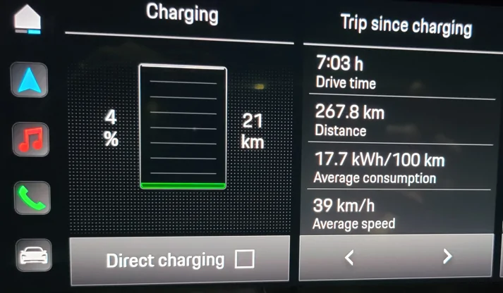

Then yesterday the range went down a lot. When I was down to 4% (almost home)...

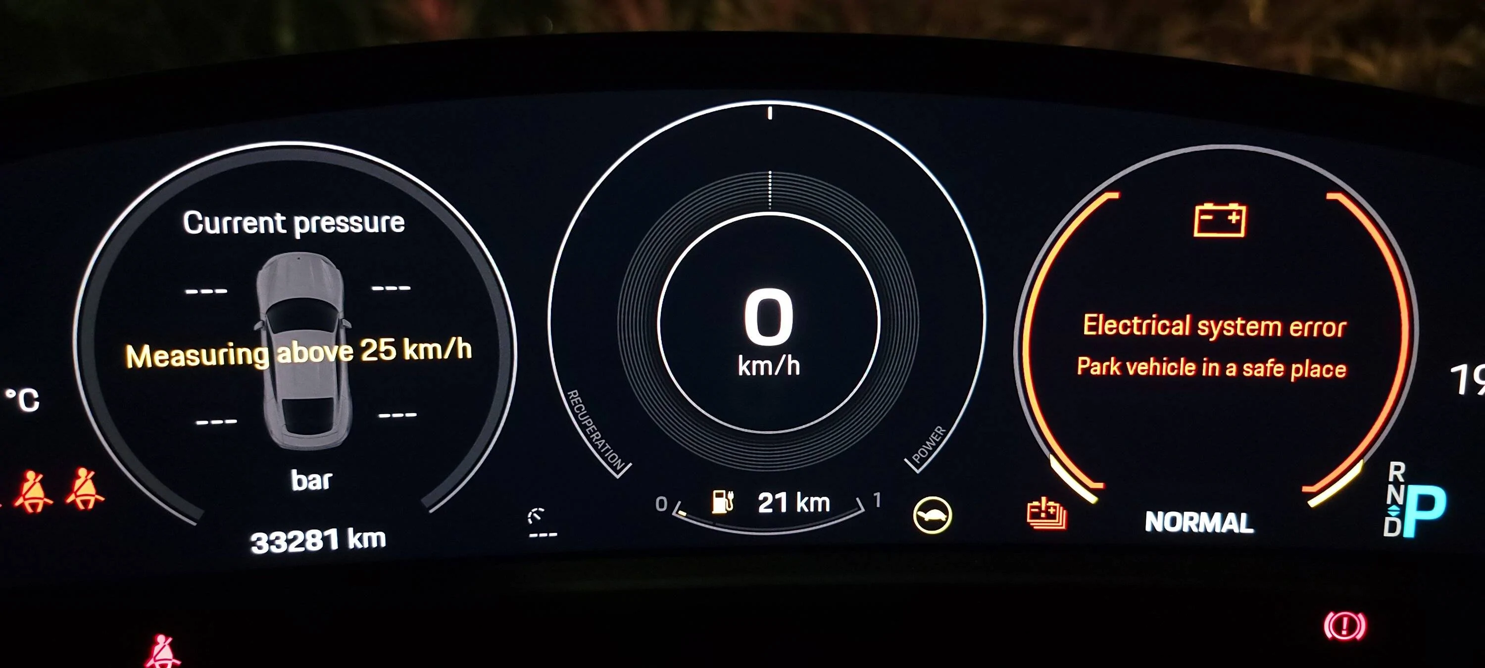

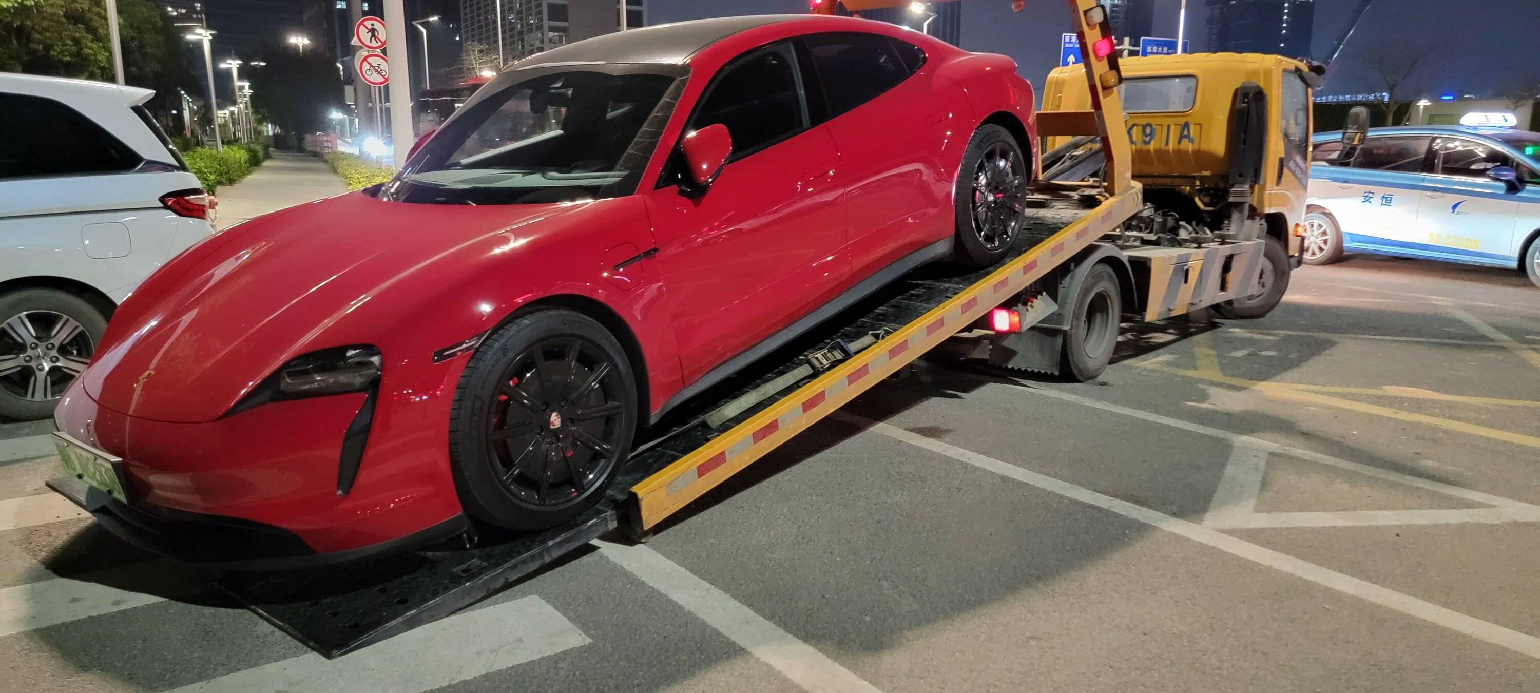

...the car broke down. Switched off and restarted many time to get out of a tunnel and parked at safe place!

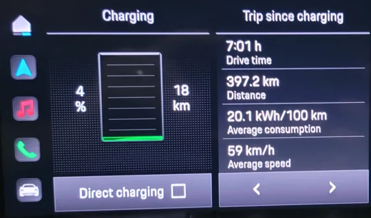

Porsche Taycan HV Battery trouble? 20230219_193808
Dropped it off at the Porsche dealer. They are checking today, but no result so far.
Anyone had the same problem?

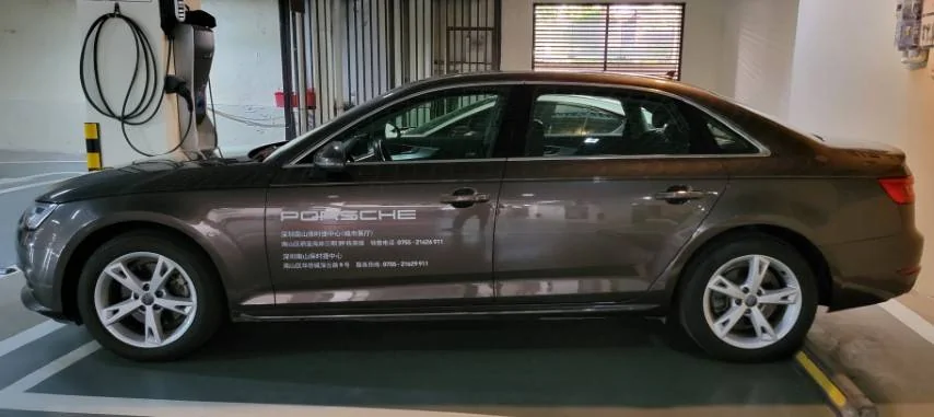

After a week wait, at least I got a Audi A4 as a loaner. Since we are leaving this summer, I most likely will not get the car back before I am gone. When I get it back, it will be sold immediately.

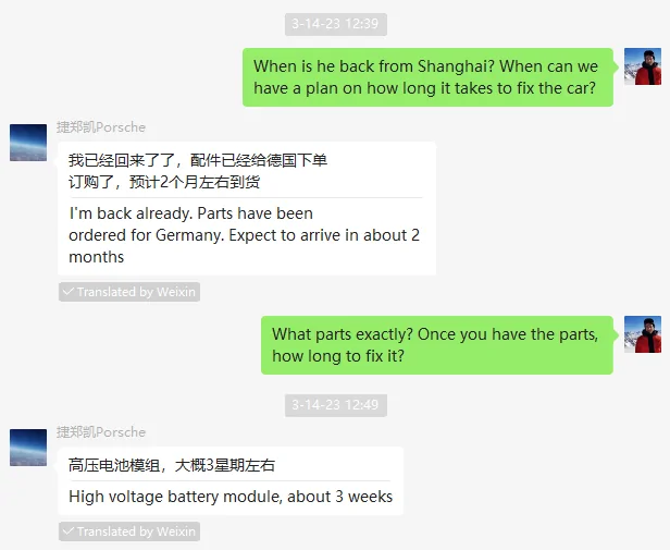

It's been over 3 weeks. The broken high voltage battery module has been ordered from Germany. Will arrive in about 2 months. It then takes them 3 weeks to fix it.
I guess end of May early June, I can get it back. Frustrating to say the least!

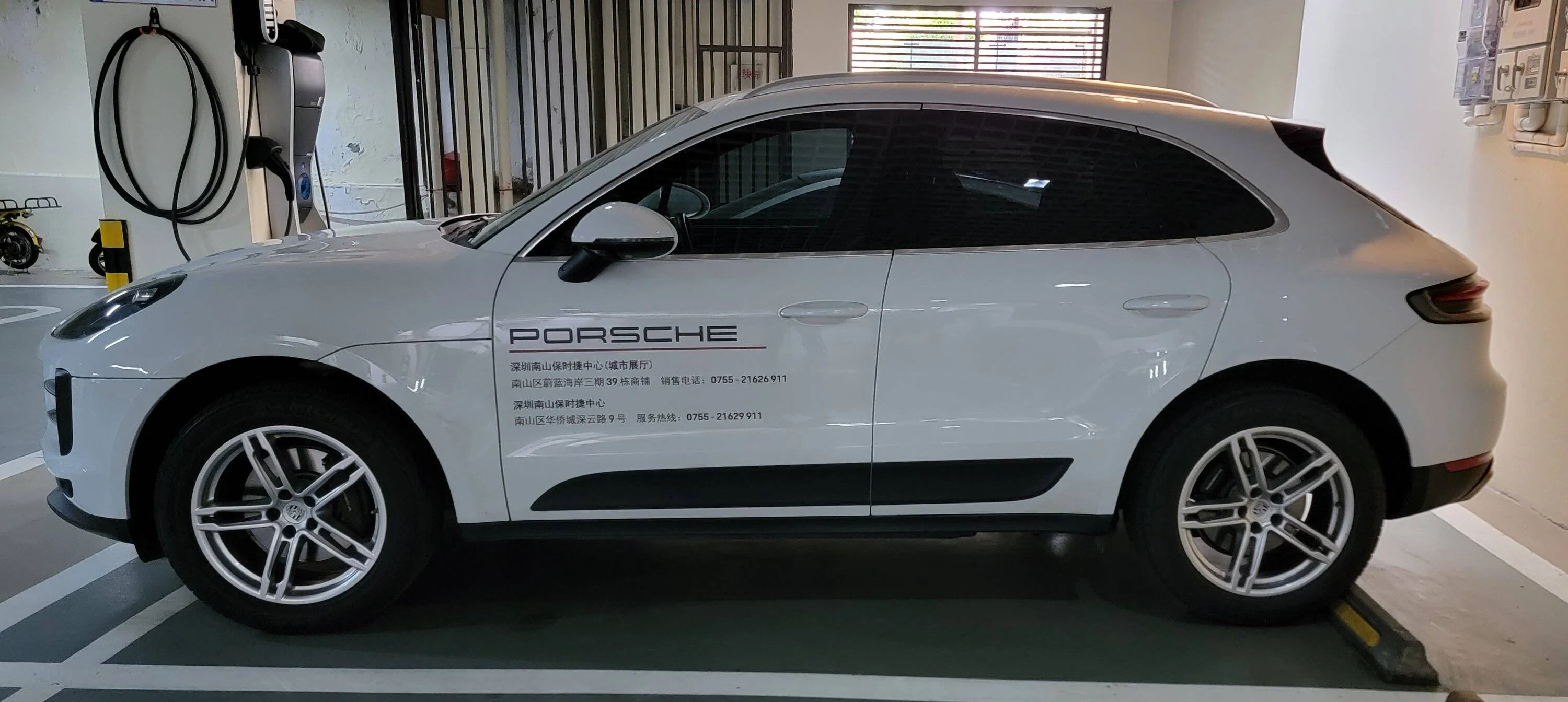

Porsche Taycan HV Battery trouble? 20230226_172359 (Small)
Well... ...since COVID... ...at least driving the Audi doesn't give me motion sickness! o_O
We turn this into a second home for a few years. Having one decent car, when back for work during school holidays, etc, is not a bad idea.

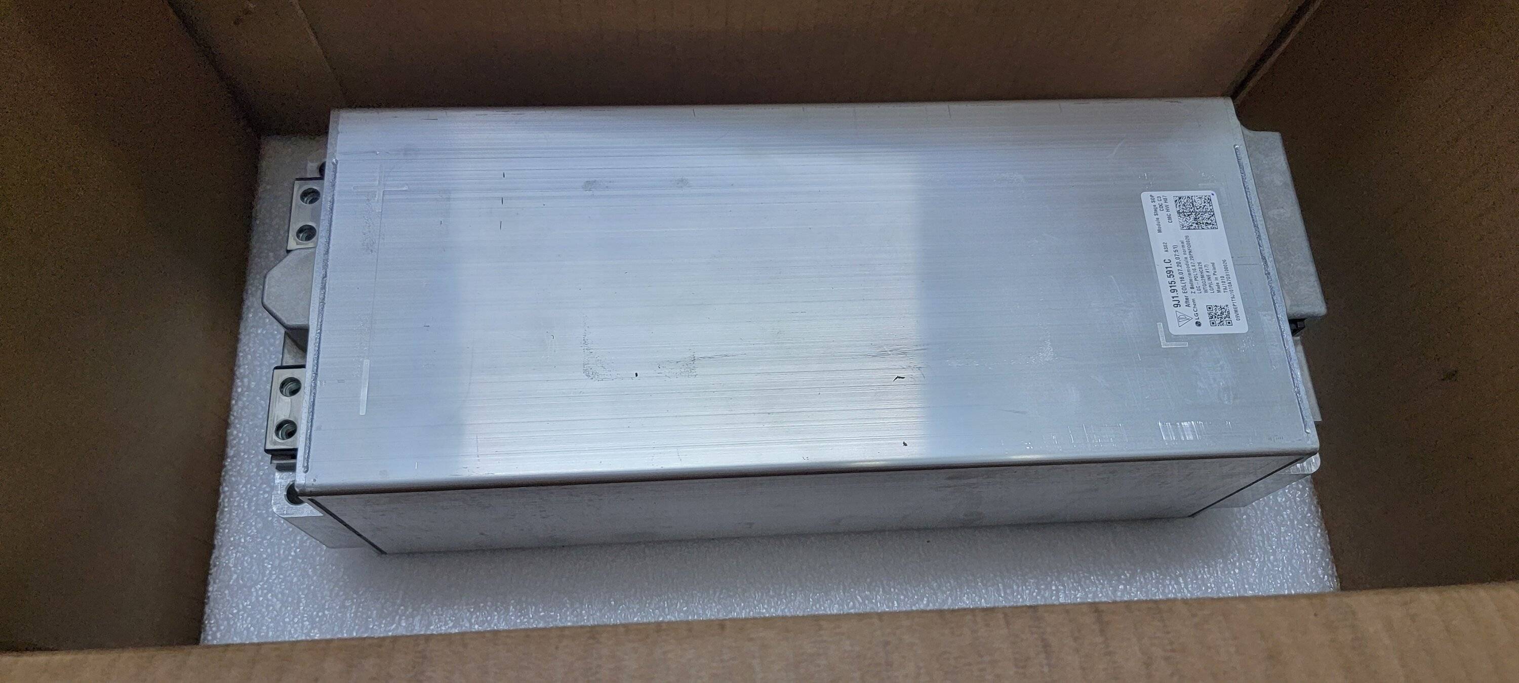

Went to the dealer again, to check the module.
Porsche Taycan HV Battery trouble? 20230423_144359
It was wrapped in a Schenker box, so most likely indeed shipped from Germany.

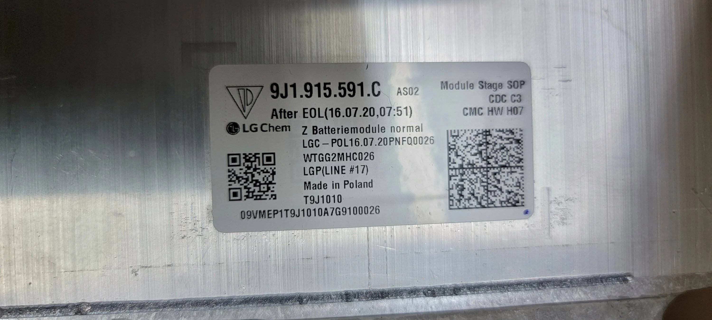

Porsche Taycan HV Battery trouble? 20230423_144416
What do you guys think, original new or second hand?
