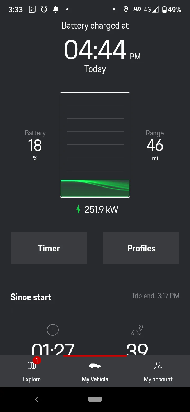

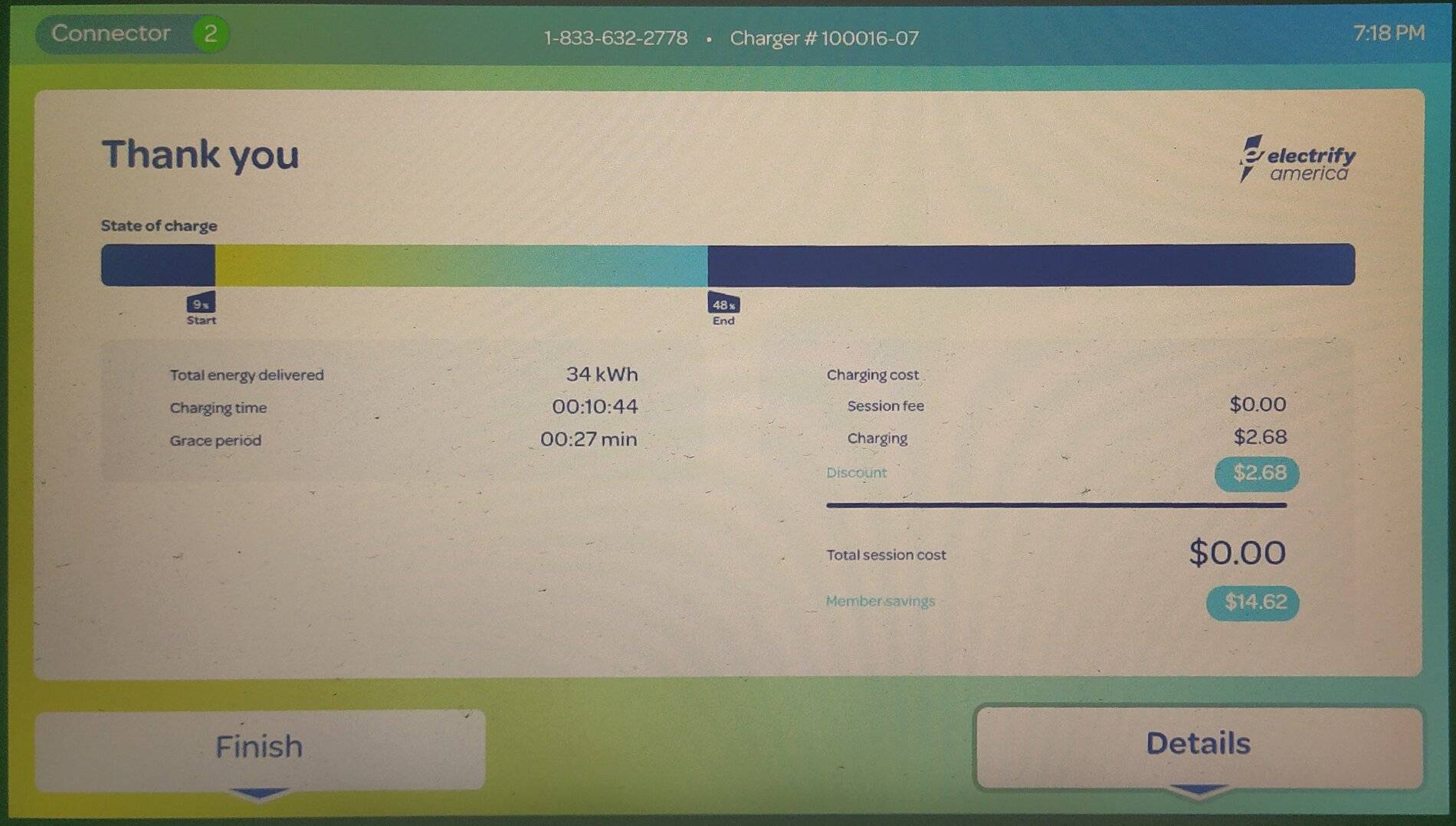

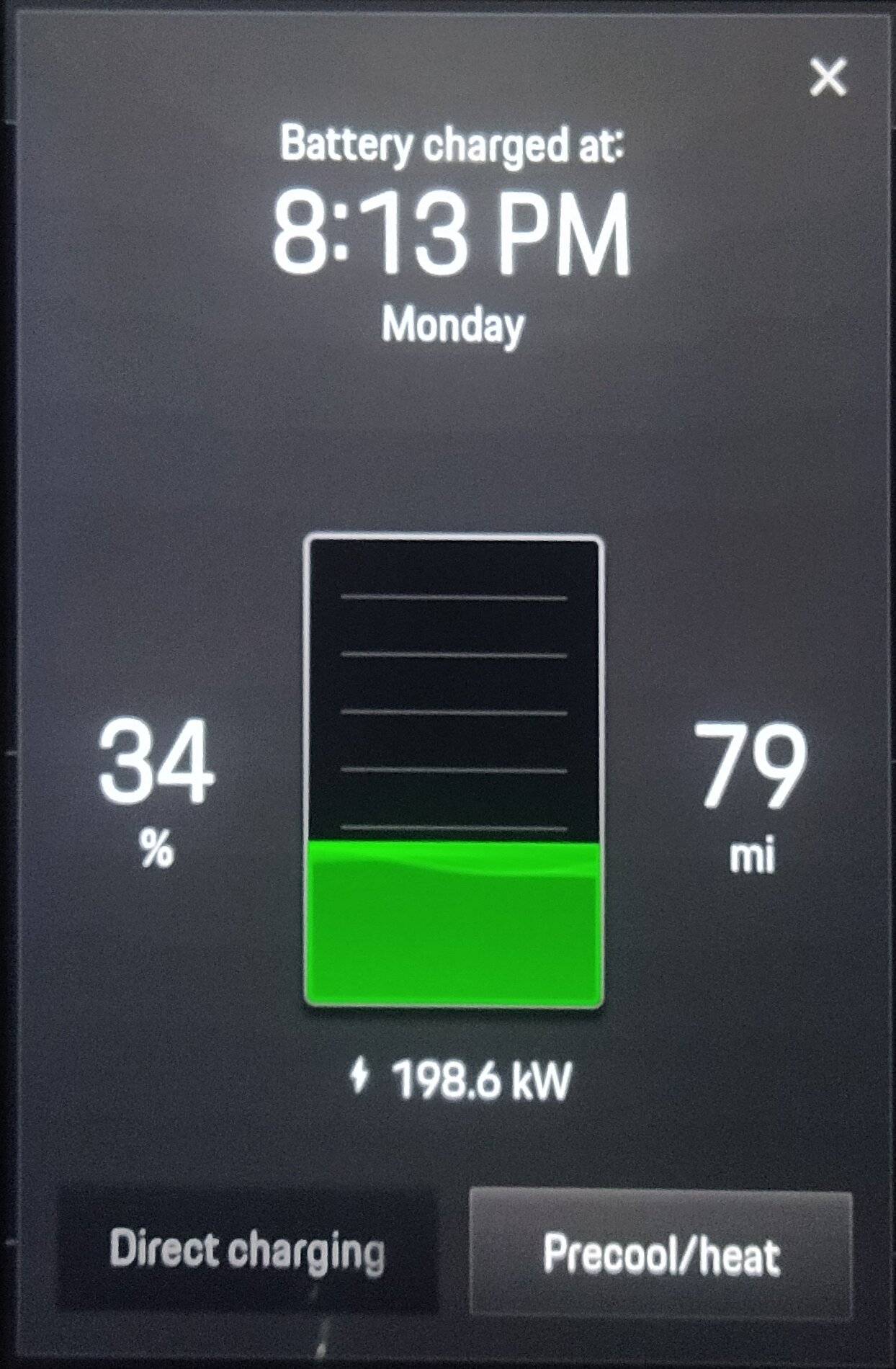

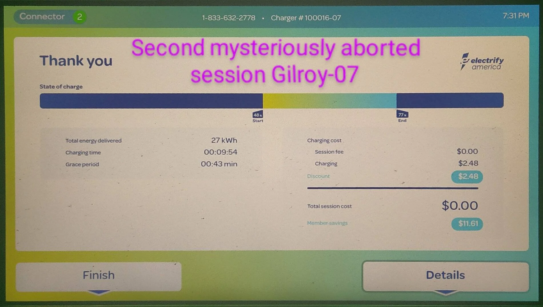

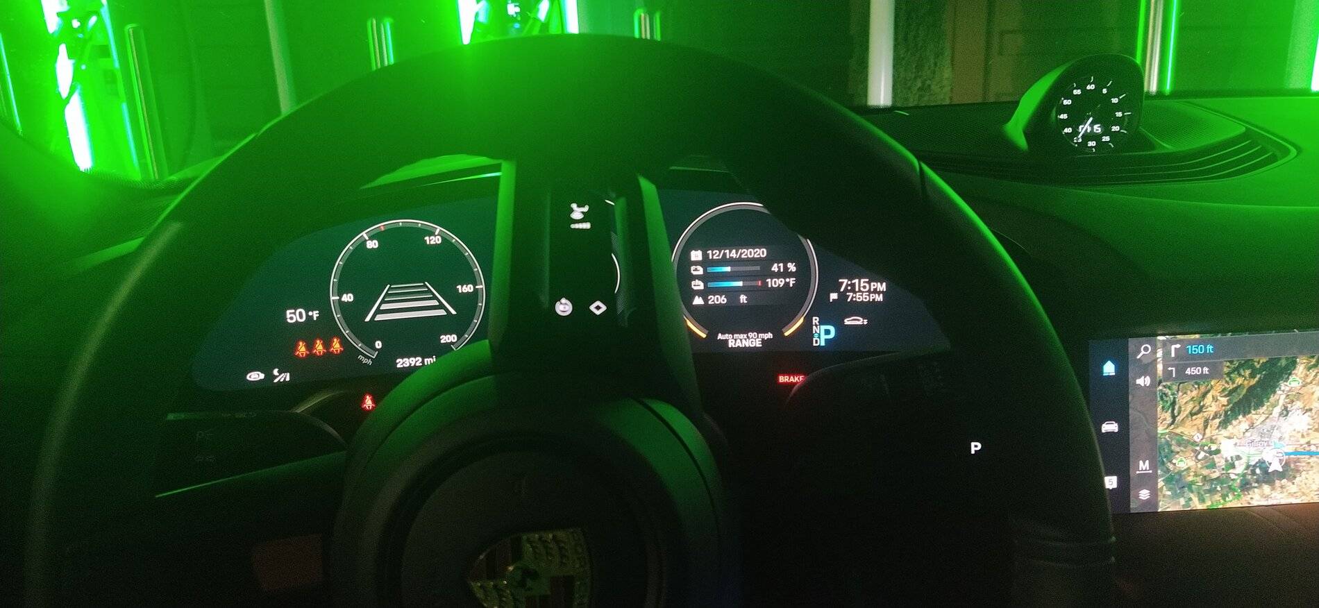

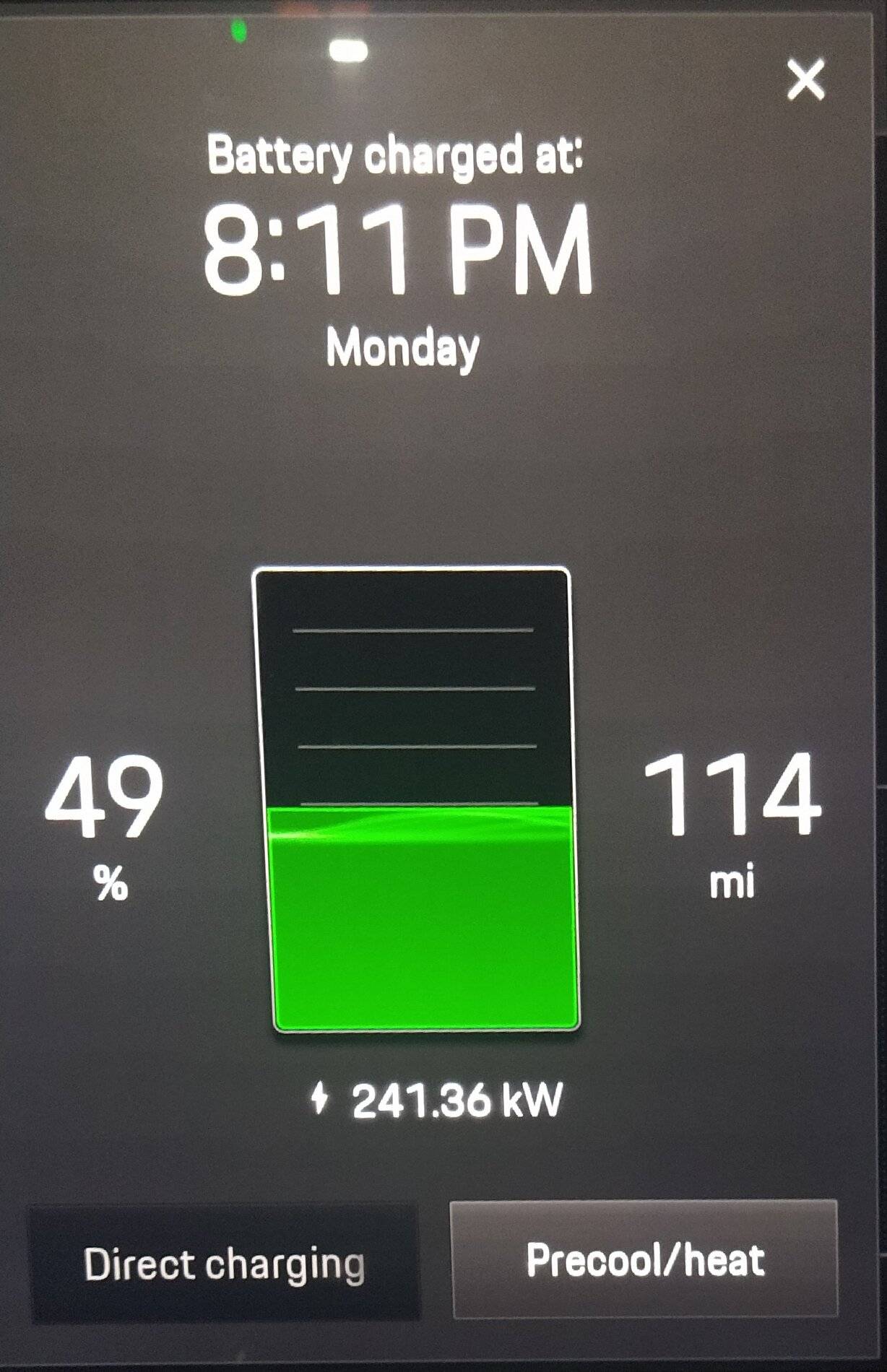

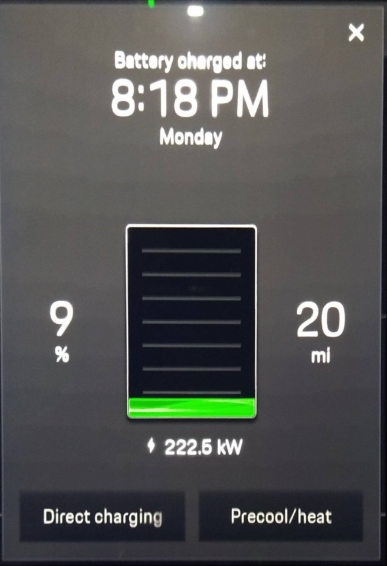

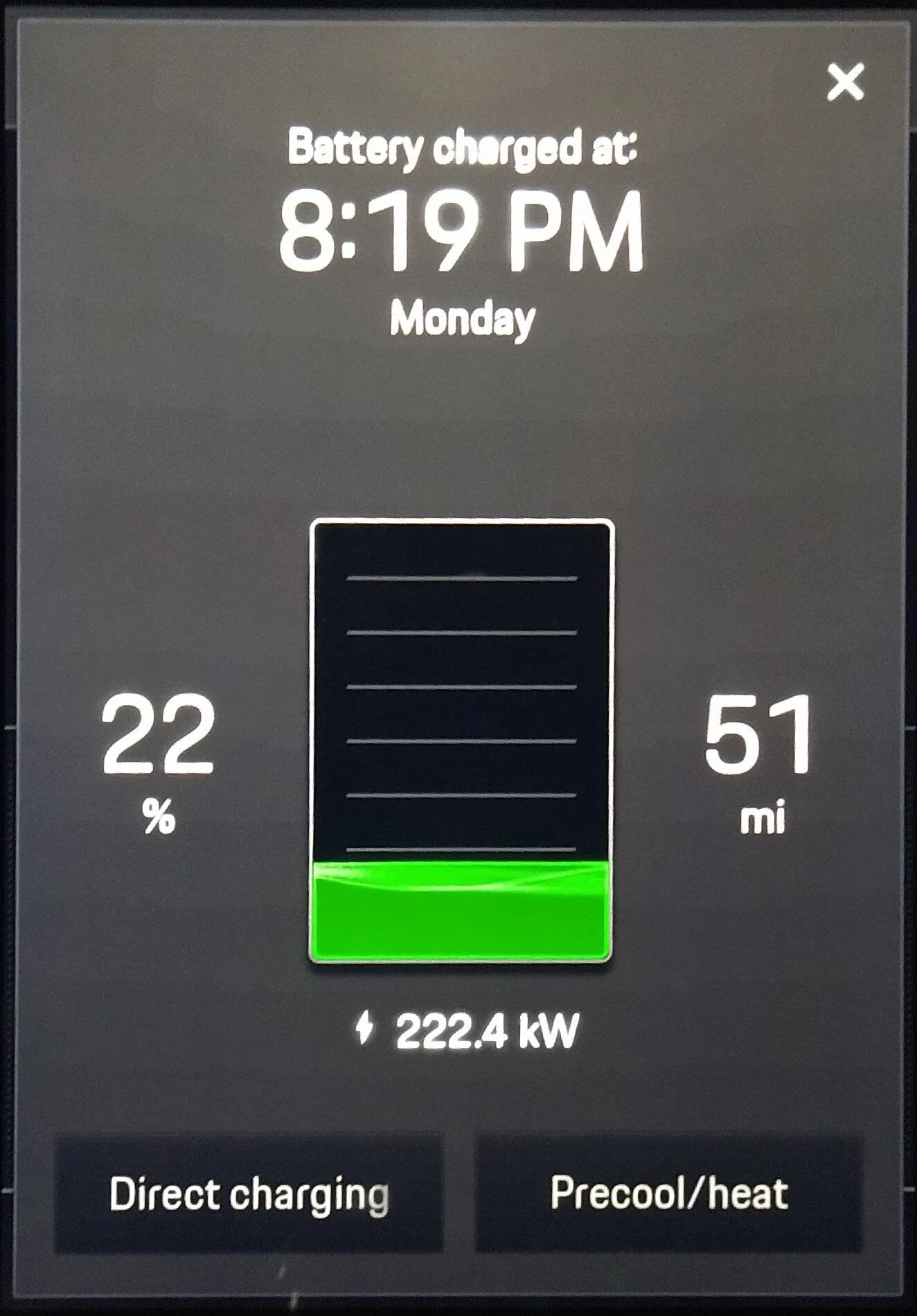

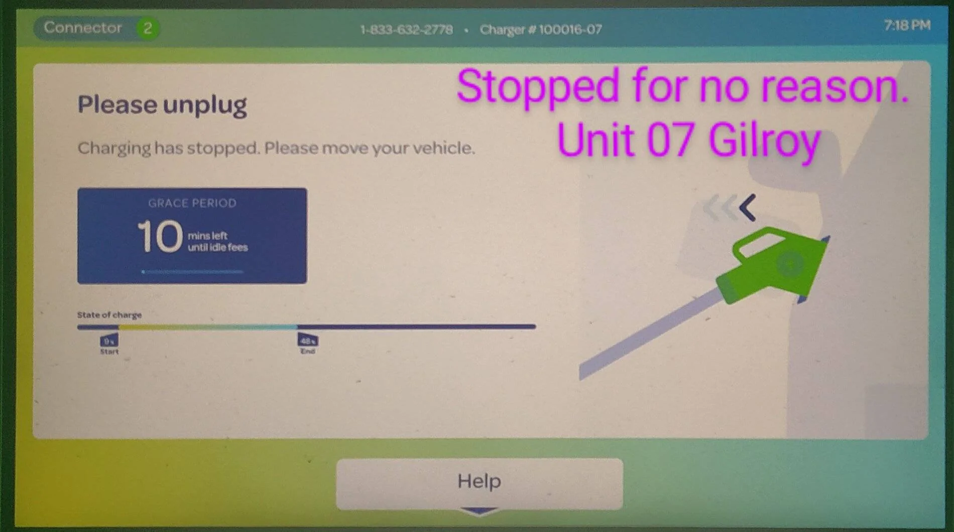

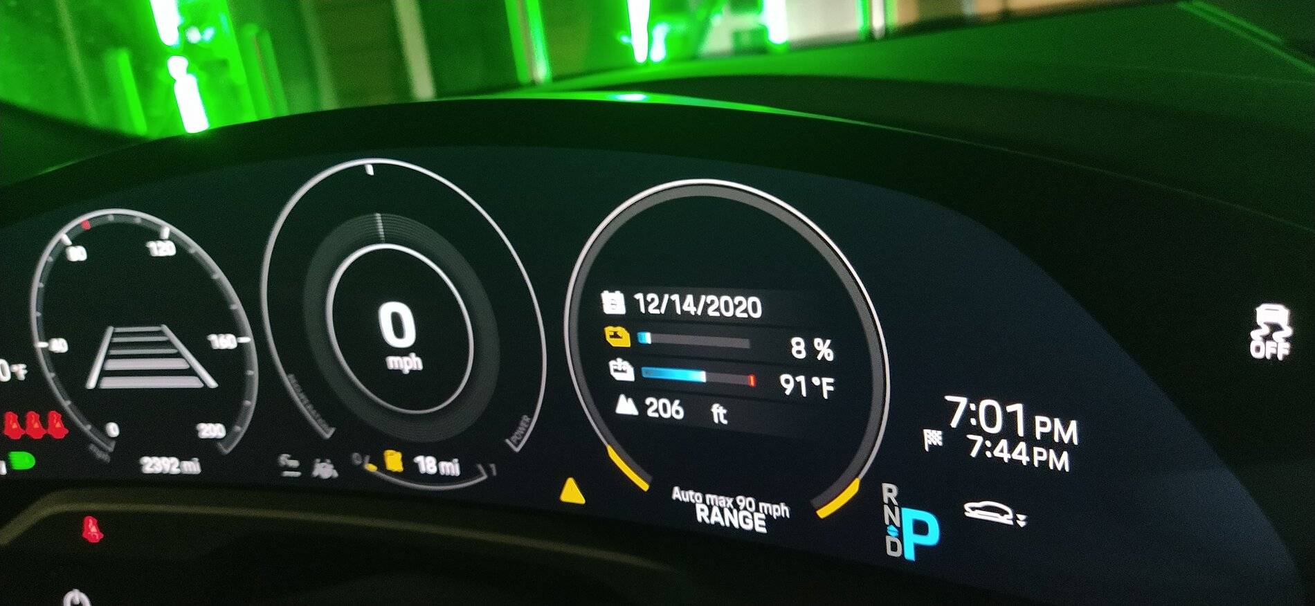

Recent charging sessions have not been going as expected with two problems that I am curious if others have.
1. Charging speed suboptimal in optimal conditions from what I can see.
2. Unexpected charge session termination with no errors or intervention on my part.
Note: I have reported both of these issues to Electrify America as soon as they happen. I'm waiting to hear back more from them and will let you know what I hear.
Details on #1 and #2: just this evening I was on a trip for 150 MI ending at the Gilroy Electrify America at 9% with the battery temperature at 91 F as it was preparing itself for the charging destination even though the outside temperature was 50 F.
It started out at 222 kW and stayed there till 34% when it throttled down to 200 kW and by then it was up to 109 F. As it was nearing 10 minutes I went outside the car to get a picture of the EA screen. Suddenly the charging session ended though I had touched nothing. Wanting to get at least 15 minutes of charge before getting home I attempted to restart the session using Charging NA which now did not show the charger that I had previously activated with it. I then used the Porsche Connect app and was able to start a new session and continue. The mystery here is that though my charging started now at 50%. The car was pulling 249 kW for a little while before the BMS throttled back down but even after throttling it was faster than the end of my previous session. After being on the phone with EA for nearly 10 minutes I wanted to get a screenshot so I open the driver door and suddenly the charger stopped again with just a 10 minute session and the car was at 77%. I reported all of this to Electrify America and hope they can tell me something from looking at their logs (unit 07 btw).
Before going to Central California I had also had an aborted charging session at a 150kW unit after 25min and 80% this time it stopped while I was away from the car and just walking back to it after a small walk around.
I am now concerned whether it is a vehicle issue versus a intermittent charger issue.
I have at several occasions taking my car down to 2% and once to 1% to attempt to see 270 kW. I have seen 260 kW once.
After all these issues, do I still love the car???
Yes of course. But I do not feel like letting my wife take it out if charging were ever required. It's just too temperamental right now and it's only because I have had two and a half years with a Chevy Bolt EV that I can deal with it.
I do still owe this forum a append for the receiving of my vehicle which happened on November 11th, I do plan to do that soon.
Photos before and between and after sessions below:

How did you get the charge value at the bottom of the screen to display?
ron_b
Ron
Dec 30, 2019
327
1,587
1,678
SF Bay Area, USA
Ahh, not obvious. But easy.
You press on the miles/min value and it toggles. Also that same technique works in the Porsche Connect app when your vehicle is charging. See this screenshot.
Note that this screenshot is from a prior charging session, not the session discussed above. The entertaining point for this session is that my car predicted I would arrive at the charger at 0%, but I made it at 1%, I did not have my wife with me in the car during this trip. Even the Boss sound system would not have been able to dround out the anxiety. :rolleyes: I find the car is very good at its estimations and I have developed great confidence in it in only one month of ownership. However, recent charging sessions have not left me with confidence and I feel they need to be babysitted, sadly. :(

In one image the battery temp is over 100 deg. F after charging. IIRC, optimal temp is 85 deg. F. I have no idea the optimal range, but there has to be some upper limit where if the battery is too hot charging is reduced to protect the battery chemistry. Could be indicative of a problem with the battery cooling system (louvers, fans, pumps, etc.) but I would expect an error code in this case. So temps may be just fine. Anyone have experience with charging rate vs. battery temp?
porsche_coyote
Wiley
Nov 23, 2019
366
529
Washington, DC USA
VW ID.4 AWD Pro S, BMW i3
Yes. I've seen that the battery temps climb quickly at high charging rates, which is unsurprising. The maximum battery temp I've observed during charing was around 115°F, and it quickly dropped as the charging rate ramped down. That suggests to me that the cooling system probably can't remove all of the heat generated by max speed charging (in the case where I saw this the charge rate had been as high as 263kW), but can easily handle the heat from charging at closer to 150 kW.
