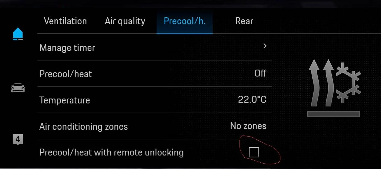

After reading about the unpredictability of settings for months, I got my Taycan Turbo S MY2021 on Friday and after two days I'm as frustrated as everyone else. I can't seem to save certain settings....
- I want regeneration on by default. Can't find how to set.
- I want sound off (Star Wars sound) on Sports Plus by default. It resets every time
- I don't want the steering wheel, seats and rear defrosters on unless I need them yet every time I turn on the car they all turn on (is cold here). Inside the garage I dont need any of those so I have 4 things to turn off every time I get in the car. Can't find how to change that.

As for the heating/pre heating, I’m pretty sure you can set those in the Porsche connect app. In the climate setting, I turn the individual seats on or off as needed for preheating and it works fine for me. You should be able to turn all the seats off and the steering wheel as well in there. Then it will only heat the car to your preferred temperature.

I think this is actually a setting in the PCM - from memory, it's called something like Preheat on Unlock. Took me a while to find it.
You know where I can find it? I'm not sure...

Thanks! I set the preheat precooling to off. Now if I could find how to skip songs without having to go to a CarPlay screen, find the musing app, find the controls and skip.... Every car I have ever owned has skip buttons somewhere on the dash, the center media controls of the steering wheel....
