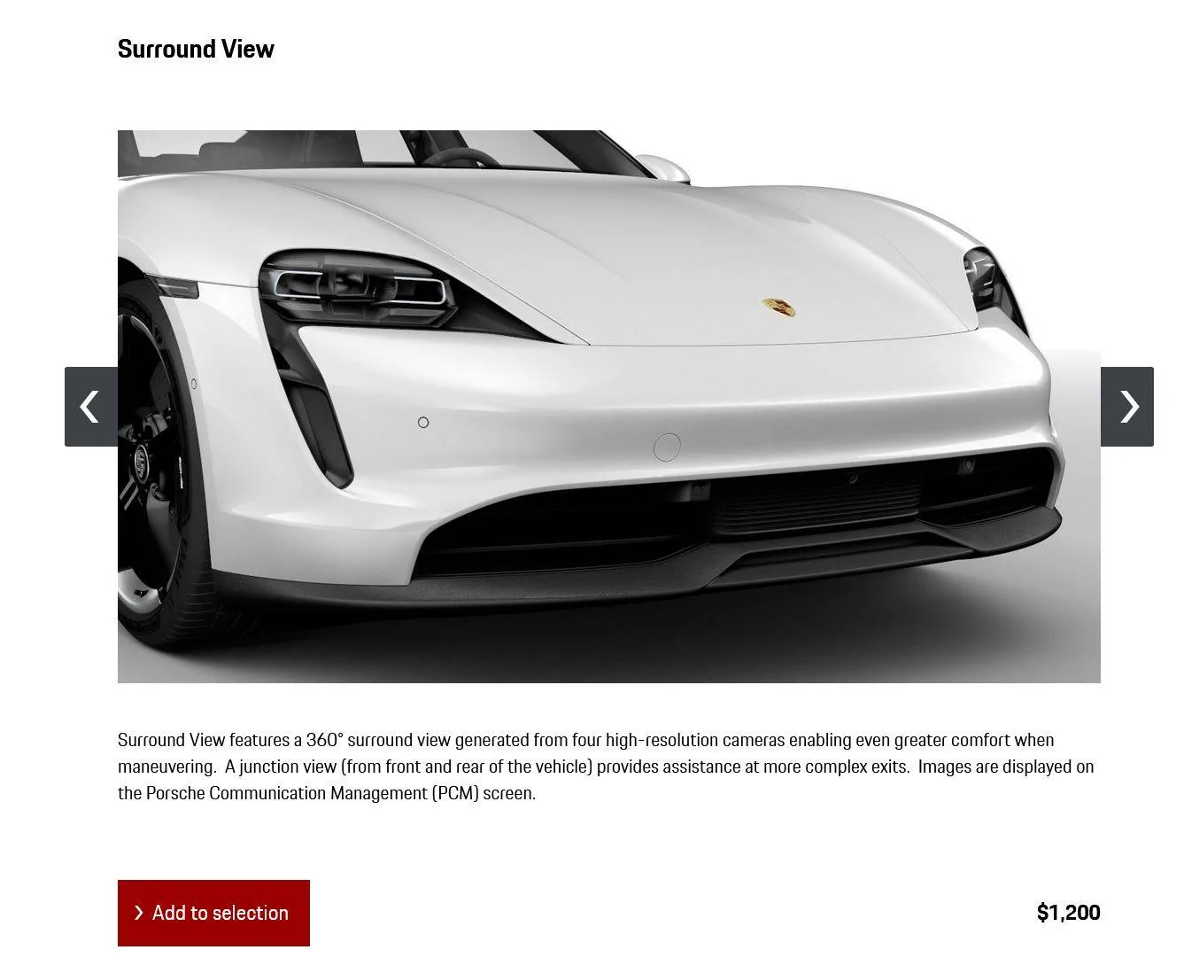

It’s borderline false advertising. Don’t demonstrate features in a car that will be different than the one you can order.
It's not borderline, it is straight up false advertising. The surround view info bubble on the USA site shows this:
It clearly and explicitly states you get a 360 degree surround view with this feature, no qualification that it's only available with auto parking. And the info blurb is the same for both the standalone surround view option or when viewed through the premium package. A backup camera is required by law in the USA - is Porsche under the impression customers are paying $1200 for a front camera view? Owners should show their dealers this option description and insist the 360 degree feature be implemented as described.
I agree with you, but putting a lawyer hat on for a second (I’m not an attorney, I just play one on the Internet) - it does provide a view from 4 cameras which is 360. It doesn’t say it provides a “rendered”, “3D” or “Birdseye” view. Now, if the description on the website has remained this language all along - 2020 and 2021, then they have zero case to stand on.
Regardless, it’s sufficiency vague and easy for customers to be confused. It’s clearly just a software config option. They should enable it for everyone who ordered surround view for the sake of the customer experience and learn from the mistake.
No mention of 3D so no misrepresentation.
Surround view equates to 360 panoramic (birds eye) which is what you have.
3D adds trick cameras in addition to the 4 you get with surround view. There are no icons for the trick ones (I think originally there were). Auto parking is added to "justify" the price premium.
