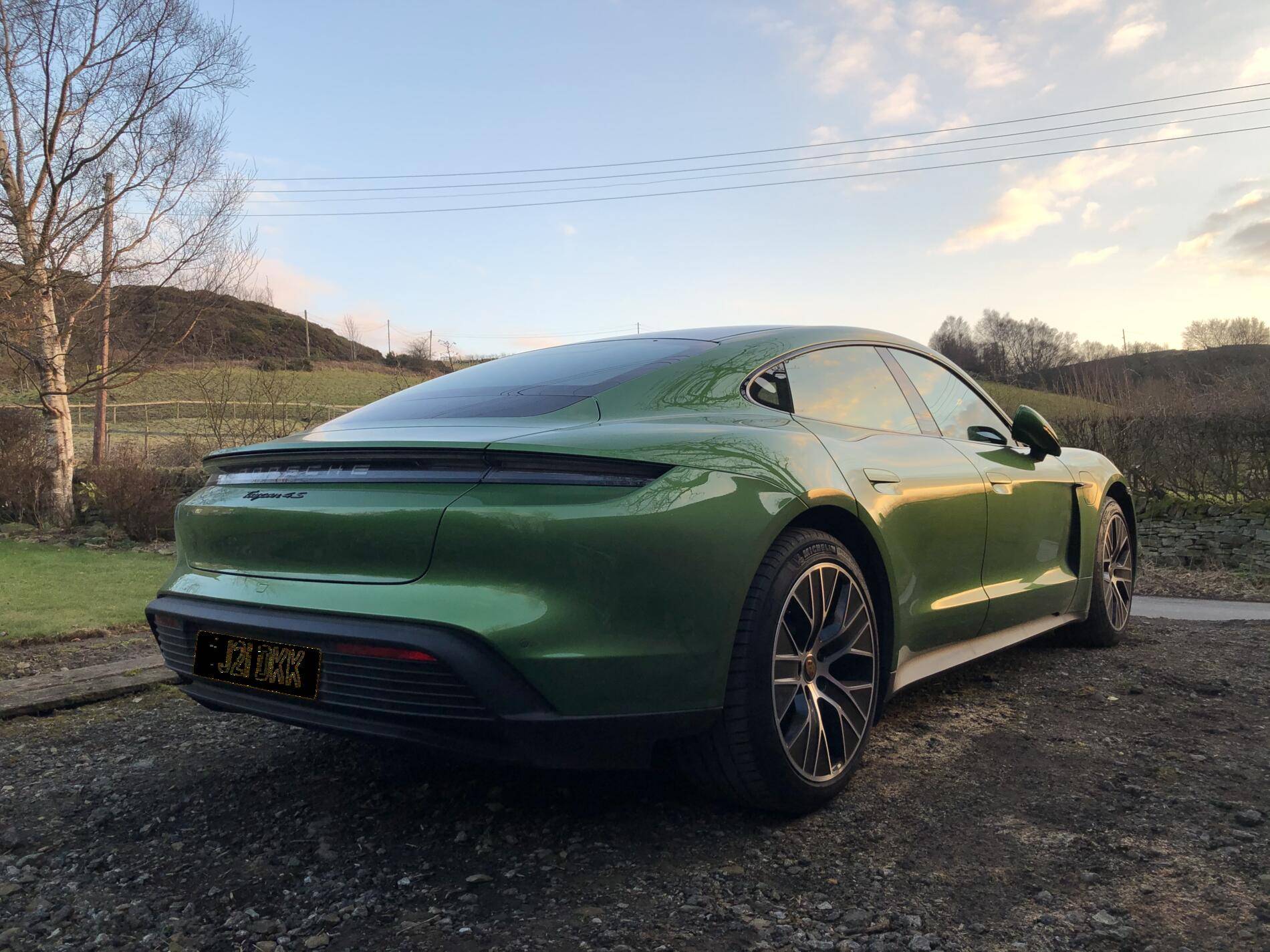

Hi
I just got my 4s MY2021 on Friday - was driving at about 30mph when got the
"Drive system control fault" and total loss of power managed to coast to a semi safe position at the side of the road.
Turned off and on again after a minute and all was fine. Drove carefully home a few miles with no issues.
Any thoughts - bit of a downer after just 48 hours.
p.s. There are no warning messages saved in the notification of the PCM -

Hi

Random thought from me but do you have PVTS+ and if so was the fob with you / in the car?
I have not activated PVTS+ on connect services I do have the fobs and they weren’t in the car at the time. I have driven about 135miles and not had them in the car at all. I didn’t think I needed it in the car if not activated?
thanks for your thoughts

That's correct. I forgot my fob while reversing out of the garage and lost all power with a red failure message. I retrieved the fob and all.was well again.
I just wondered if you had an activated service and didn't have the fob present.
