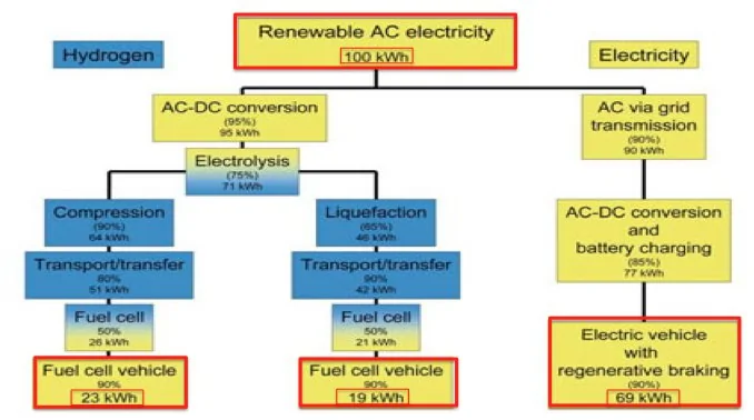

commercial scale H2 has like a 19% overall efficiency - start with 100 kWh of pure electricity - and you end up getting to use about 19% of the original 100 kwh to actually move a vehicle - vs. 65% or better for a BEV

19 kWh usable power for transportation is the "right-hand" side of the H2 flow - liquidation vs. compression is the difference.
Electrolysis isn't even near 75% efficiency.
It takes more energy to make it than H2 can carry.
Also, H2 produced by electrolysis needs additional refining to be 99,9% pure for making it even useable in fuel cells in the first place.
Driving on H2 looks like the holy grail in transportation but the production of H2 is far from that.
the chart is pretty damming even with the wrong H2 assumptions - if you include realistic H2 production assumptions it only gets worse for H2…
