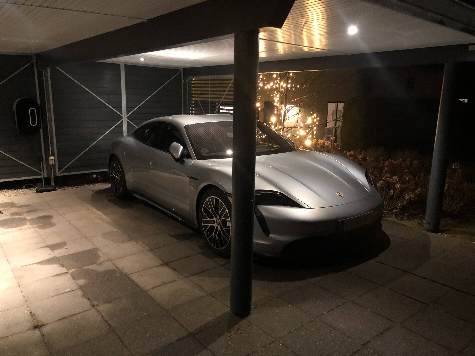

Because we had a sudden snowfall shortly after I took delivery I wen’t out in my driveway and fitted the winterset. I had purchades the 20” Turbo wheel set with goodyear winter tyres (original porsche parts). I read the manual (important info on jacking and securing the suspension in there). Changed the wheels and changed wheel settings in the PCM. Went for a drive to let the tyre pressure sensors to be calibrated and connected. But with no result.
Went to the dealership where I bought the car only for them to inform me that the tyres were supplied with a code on the label that was on each tyre. This code must be programmed in the car (PCM engineering mode?) for the system to work. But I was not aware of it - and did not take note of the codes. The car is going to the dealership for the coding to be done. 1-2 hours of labour. Damn.
Just a heads up to you guys.
