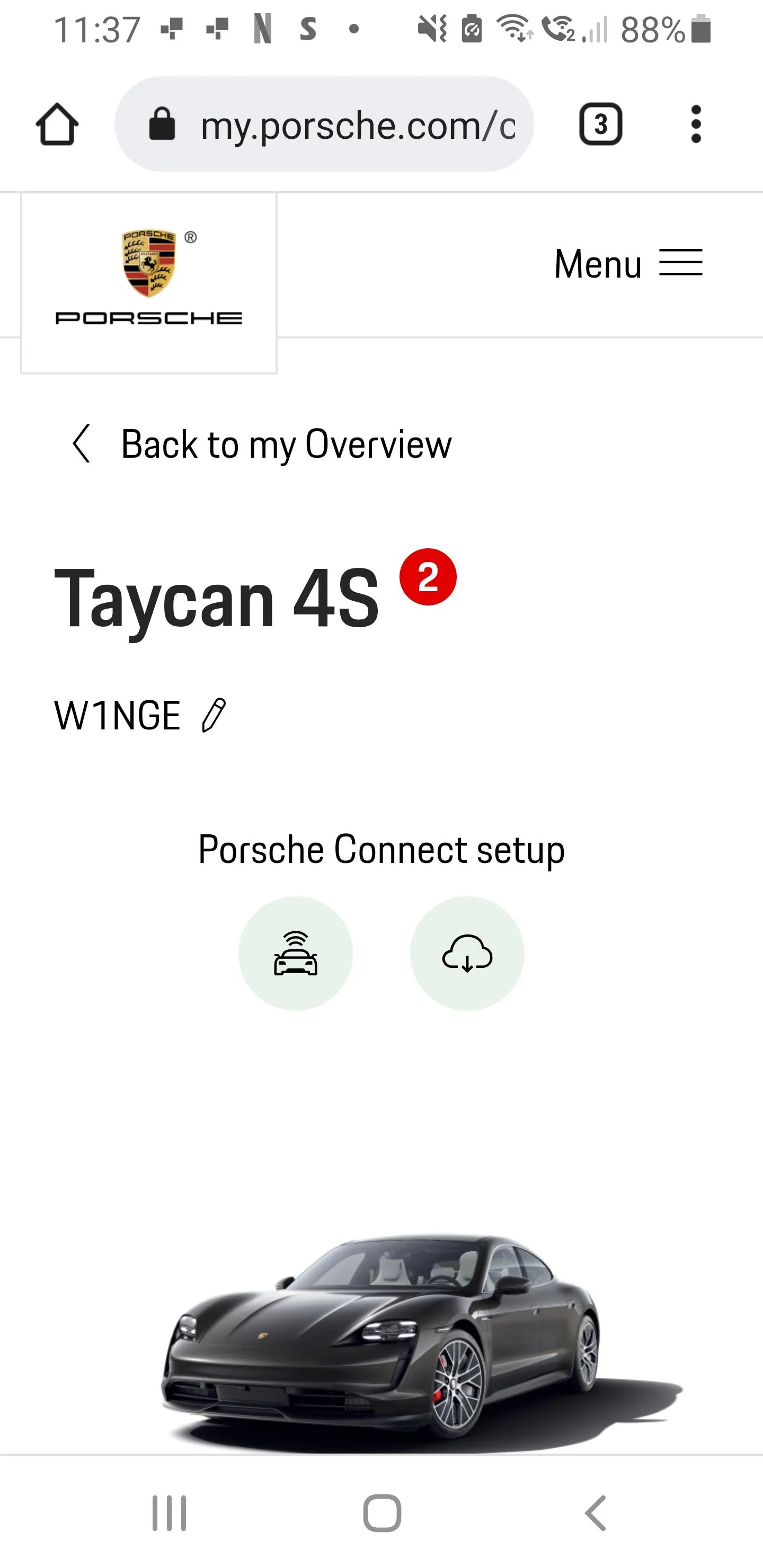

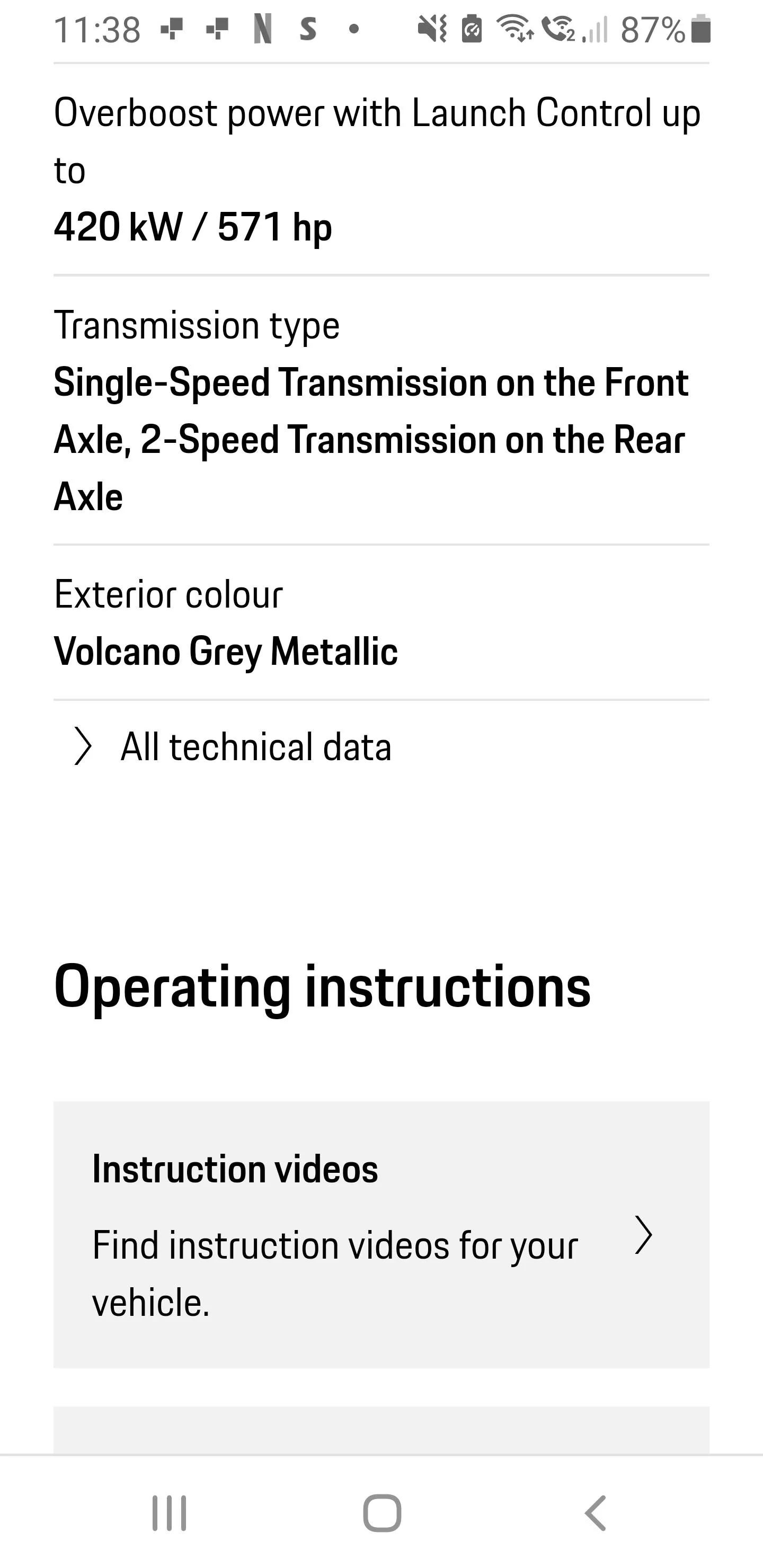

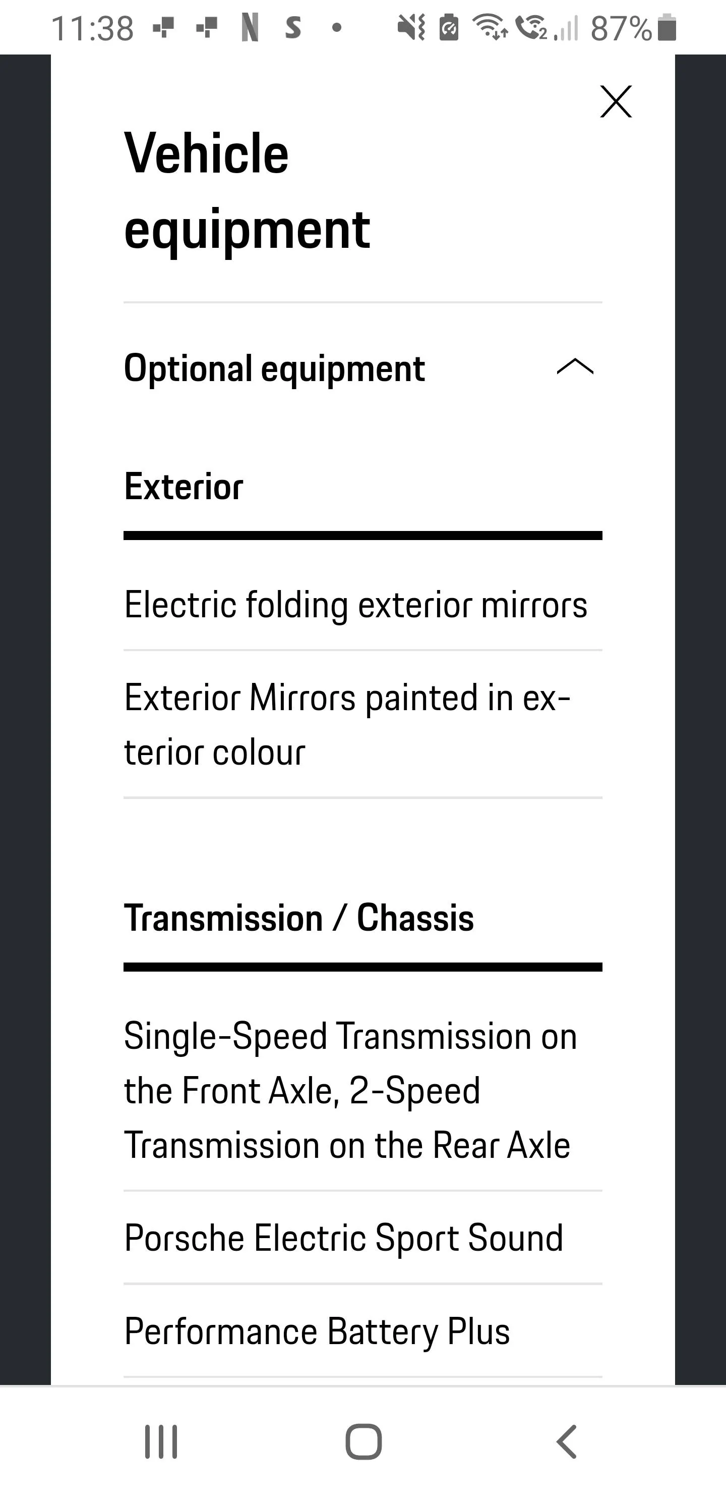

I don't have this information when I view my car details. Would you have a screenshot? Thanks
Launch the My Porsche website (not the app), touch the picture of your car and then scroll.
Then All Technical Data option is aat the bottom after the long list of Porsche Connect services.
