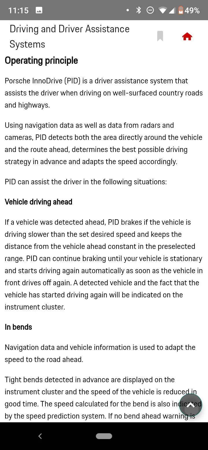

If it doesn't center on lane then I think you are using LKA not Active Lane Keeping. See the Good to Know Porsche app for details. InnoDrive handles speed only, it doesn't steer. InnoDrive is quite sophisticated in handling speed by looking several miles ahead at train and deciding max speed to take corners etc.

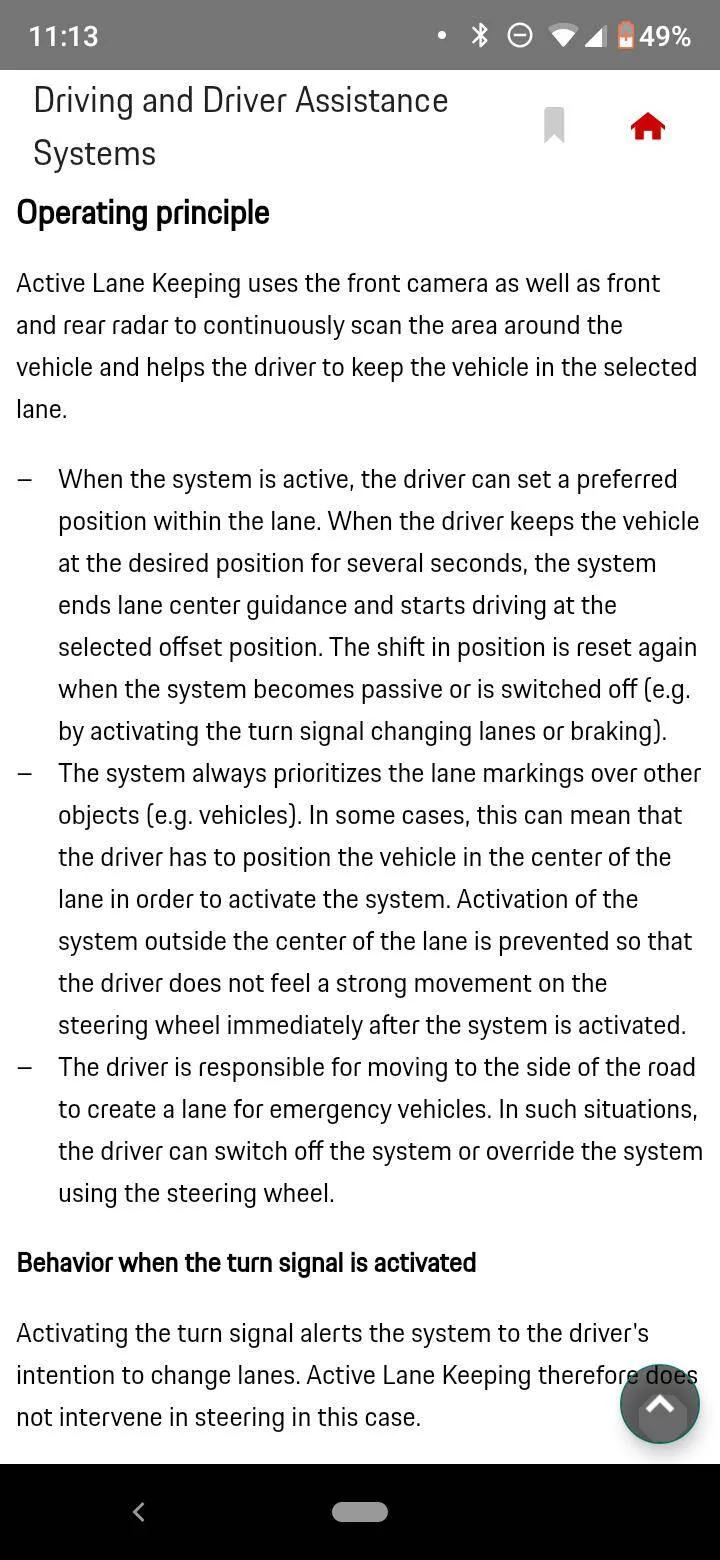

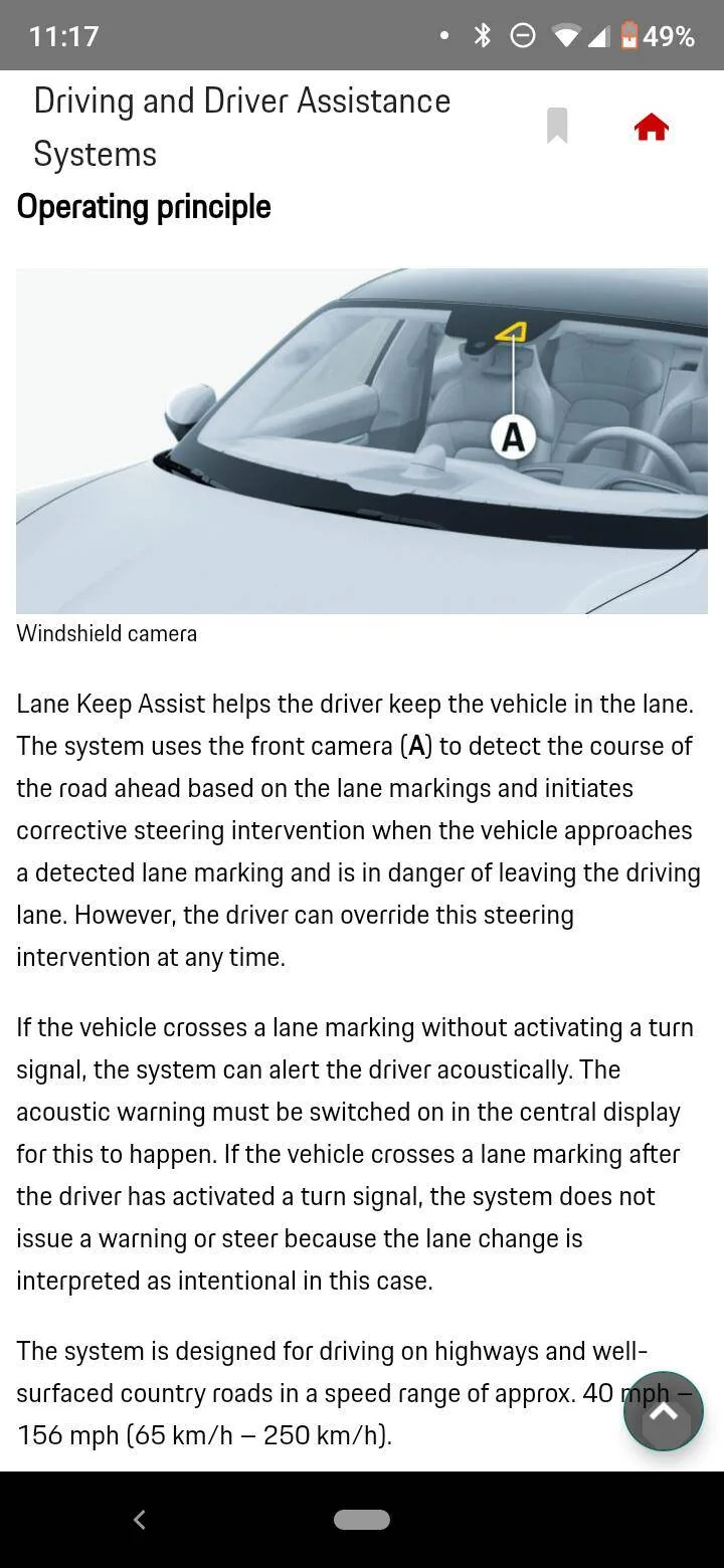

I am pretty sure from the dozen videos I have seen and what I have read in Porsche manual that appears to only be available in USA right now, sorry. I have captured 3 screen shots of related systems. Note that there are dozens of pages and many warnings etc in the manual but here is the top of operating principal.
InnoDrive
Lane Keep Assist
Active Lane Keeping

@BenJL I must admit some confusion on where one system ends and the next begins. Thx for the post @Austin_yeahbaby I did also see that Traffic Jam assist as part of InnoDrive but only at speeds 0 to 37mph, where Active Lane Keeping supports speeds 0 to over 160mph as I recall.
Also to be clear Active Lane Keeping said it only works when ACC or InnoDrive is active.
You were absolutely correct, I didn't have the setting enabled. I tried it today on a tricky road with weak markings and construction and it did very well. I would say as well as Tesla and much better than my Jaguar (but that is not a good comparison).

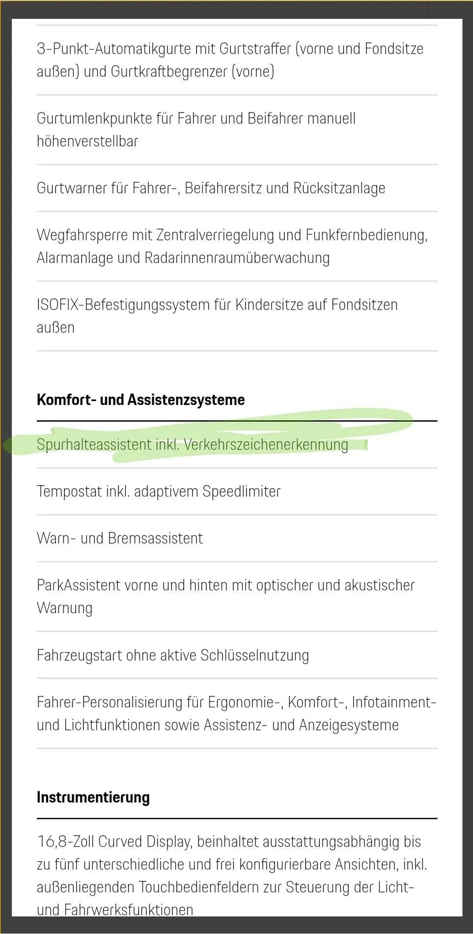

Hello
In my understand and dealer told us
Active Line Keeping standart option
Inno Drive include steer, it write instruduction part

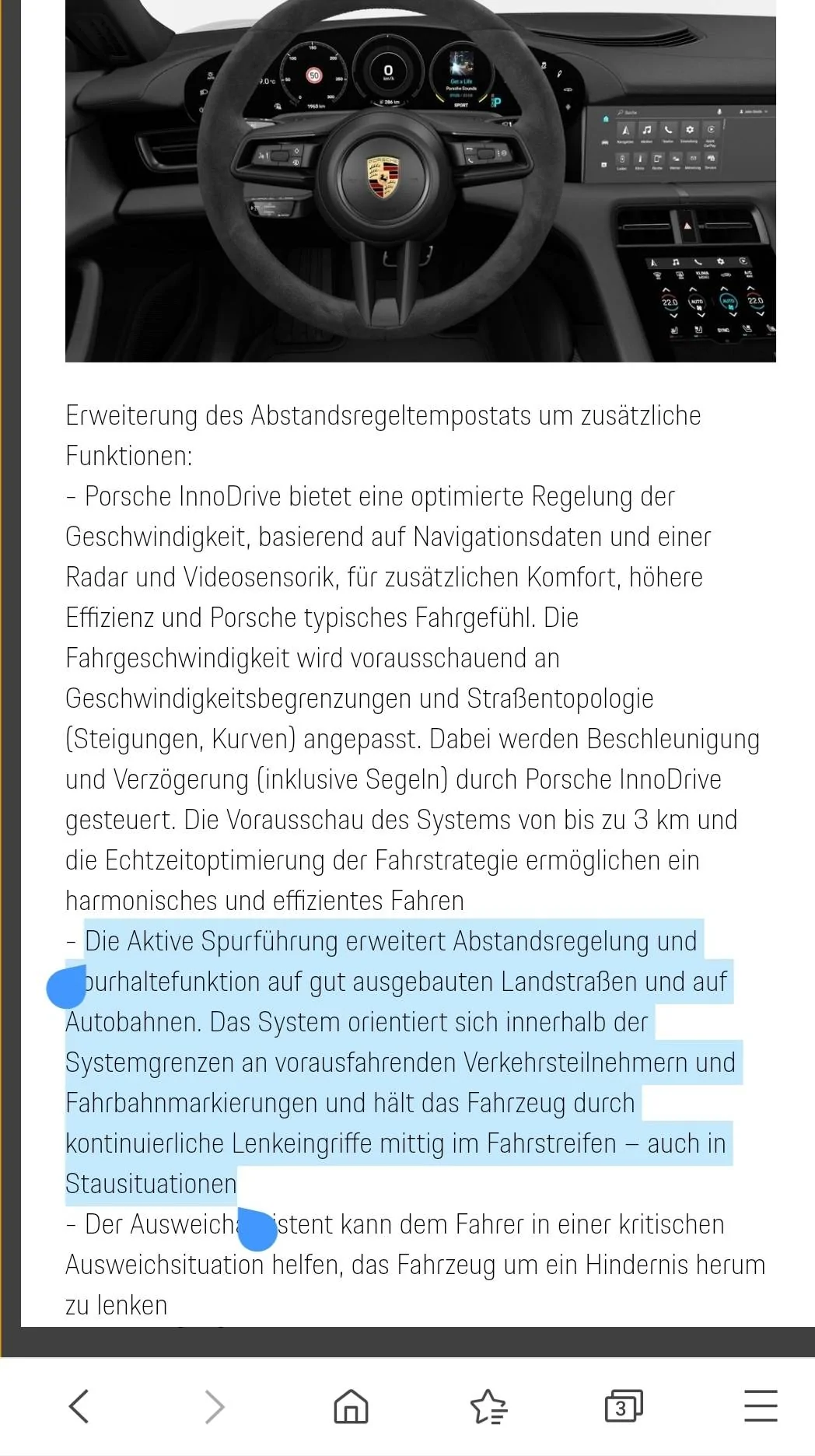

Die Aktive Spurführung erweitert Abstandsregelung und Spurhaltefunktion auf gut ausgebauten Landstraßen und auf Autobahnen. Das System orientiert sich innerhalb der Systemgrenzen an vorausfahrenden Verkehrsteilnehmern und Fahrbahnmarkierungen und hält das Fahrzeug durch kontinuierliche Lenkeingriffe mittig im Fahrstreifen – auch in Stausituationen
Active lane guidance extends the distance control and lane keeping function on well-developed country roads and on motorways. The system orients itself within the system boundaries on road users ahead and road markings and keeps the vehicle in the center of the lane through continuous steering intervention - even in traffic jams

Hi @Abdullah ,
I think the standard option gives you lane keeping e.g it nudges you back in if you drift.
From my reading up on this, innodrive gives you an "active" lane assist which keeps you central in the lane.
In summary, I think the standard option is more of a nudge to keep you from drifting out of lane and innodrive brings a more sophisticated version that sled steers you whilst driving.

I give order with inno drive.It seems steer for inside line. I hope, Iwas right.. Now My car has got steer function.It is very important for me.In Traficc,It helps too much
