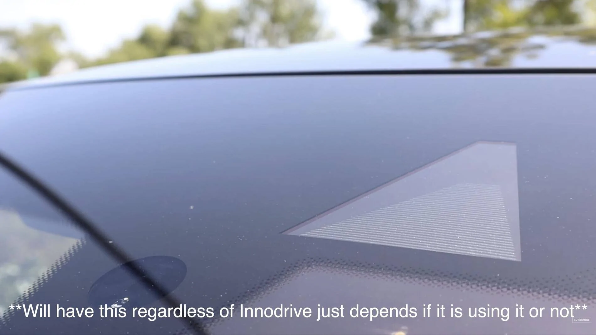

In a last minute change, I'm planning to add ACC to my (already beyond budget) specs. I like InnoDrive too and I think it's an area that will continue to slowly improve in the future. I see we can get Innodrive over FOD, which I'm planning to do. But here's a very specific question: What do I lose by not adding Innodrive at build ? I couldn't find any specific info so far. I came across a comparison sheet in German, so that failed as I couldn't understand. Here's a video that shows that if you get Innodrive, the car gets equipped with a radar on top of the windshield. So is this part missing when I don't add Innodrive at build ? Or as the video says - it exists regardless as an unused part (w/o innodrive). I'm sorry - this has become such a confusion.

All Taycans have a camera in this location - road sign recognition etc.
You must specify Adaptive Cruise Control (ACC) at build time and then optionally add Innodrive either at build time or after delivery via Function on Demand (FoD). ACC adds a radar dome beneath the front bumper and can't be added post delivery for fairly obvious reasons.

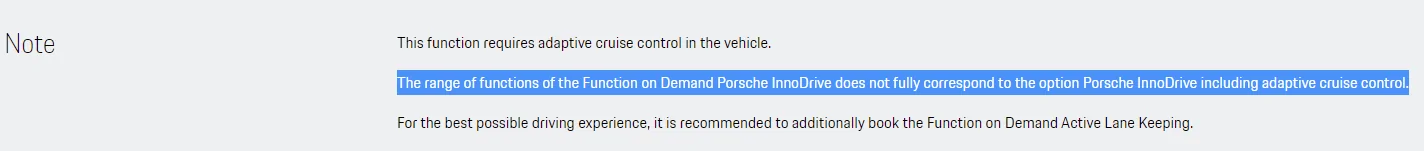

Interesting post that led me to investigate the FOD option on the Porsche Connect store a bit more (I have optioned ACC but not Innodrive, but am still waiting to get the car..) In the UK at least the following note is shown on the Innodrive FOD page:
(Key text: The range of functions of the Function on Demand Porsche InnoDrive does not fully correspond to the option Porsche InnoDrive including adaptive cruise control. Link: https://connect-store.porsche.com/gb/en/p/inno_drive_v1 then choose Taycan)
Unfortunately, I can't find anywhere that actually specifies what the differences are though..
Ah that's interesting and definitely suggests both are different. I suspect (speculation on my part) is that the factory fit may include additional sensors for cross traffic / intersect assist. Definitely one for the dealer to explain in full.
If there are truly differences then Porsche should rename one as InnoDrive Lite to make the distinction clear.
Gladly, I don't have it on my car nor would I ever spec it - I detest autonomous control and would end up switching features off!
Yes, very much agree on the 'Innodrive Lite' idea - FOD in general does seem to me to be getting off the ground rather slowly. I'm sure I'll try it for a month as the cost is relatively low and I'd be interested to see if I find it useful.
At least in the US, ACC+PID when ordering the car includes ALK; but when getting the car with ACC and adding PID via FoD, it does not include ALK. With FoD, ALK is an additional product which can also be added.
