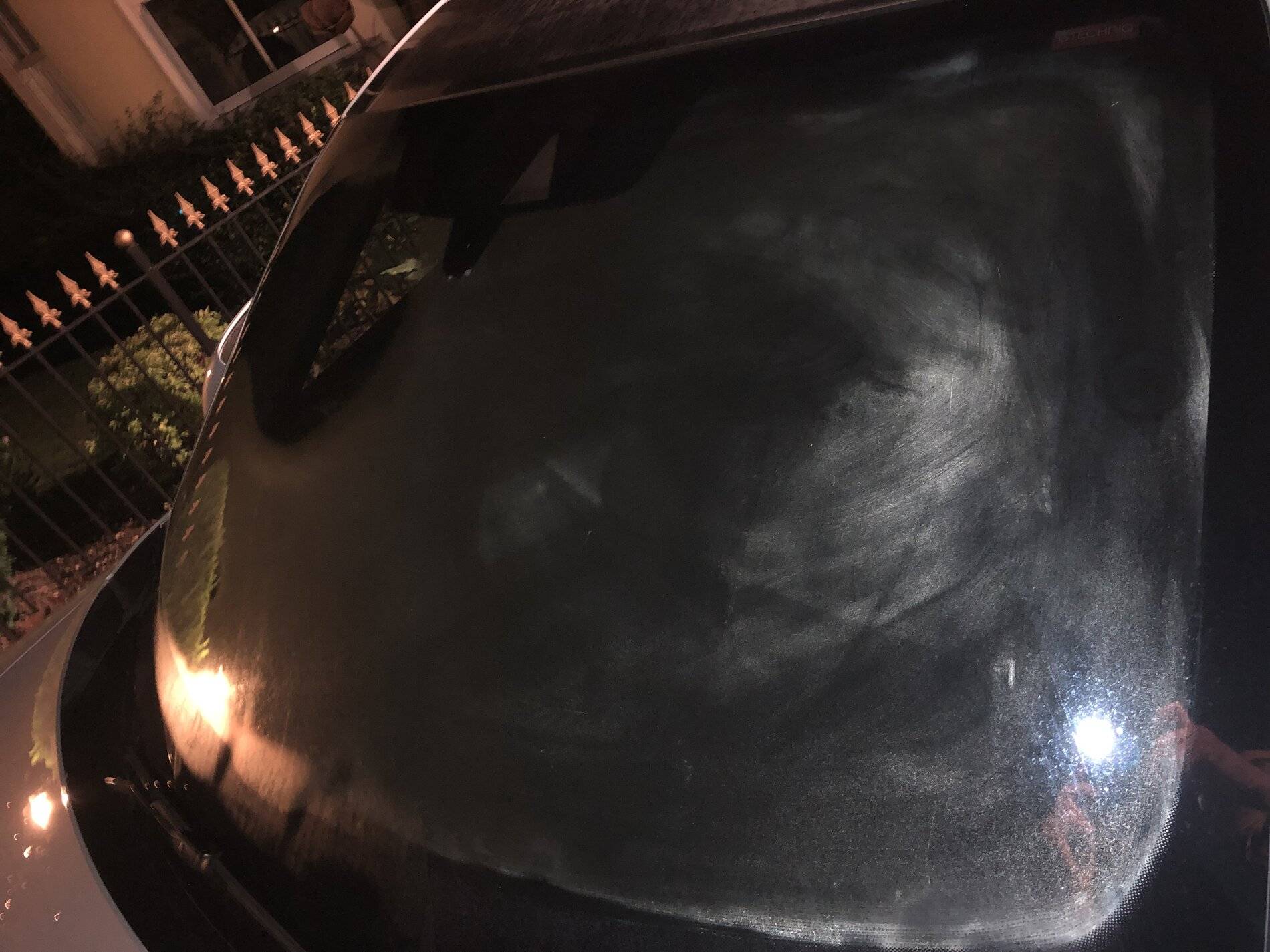

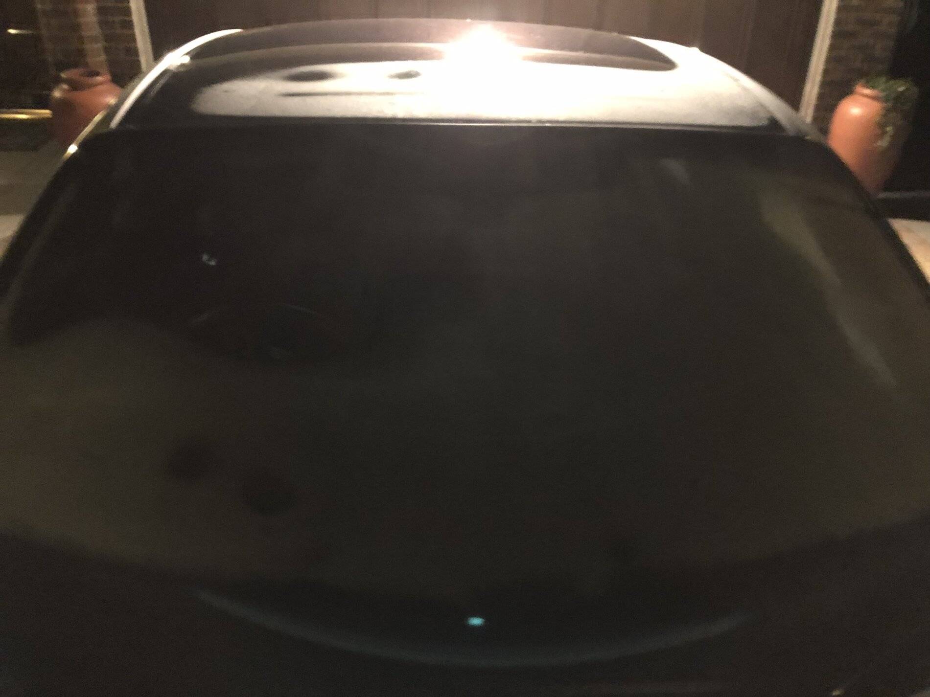

Evening Folks,
Have been noticing that inside car windscreen when left unattended becomes “misty”. It has started in the last two weeks. Can be day or & nighttime.
Anyone had same issue or can help resolve the problem.
Thank you.
Porsche Taycan Inside Mist 63188871-0C77-4107-8086-C040407CC05B
Porsche Taycan Inside Mist 05B05339-F7BD-46A7-9597-EAE1CDF3E818

Does it struggle to clear when the car is running? I had this when my car was new and there was a service bulletin fix for it where some of the MY21 cars had to have some drain plugs changed as moisture wasn’t draining properly from some channels. It was this time of year it started for me last year.
It does struggle to clear when car is running.
Will chase Porsche.
Thank you for the reply.
