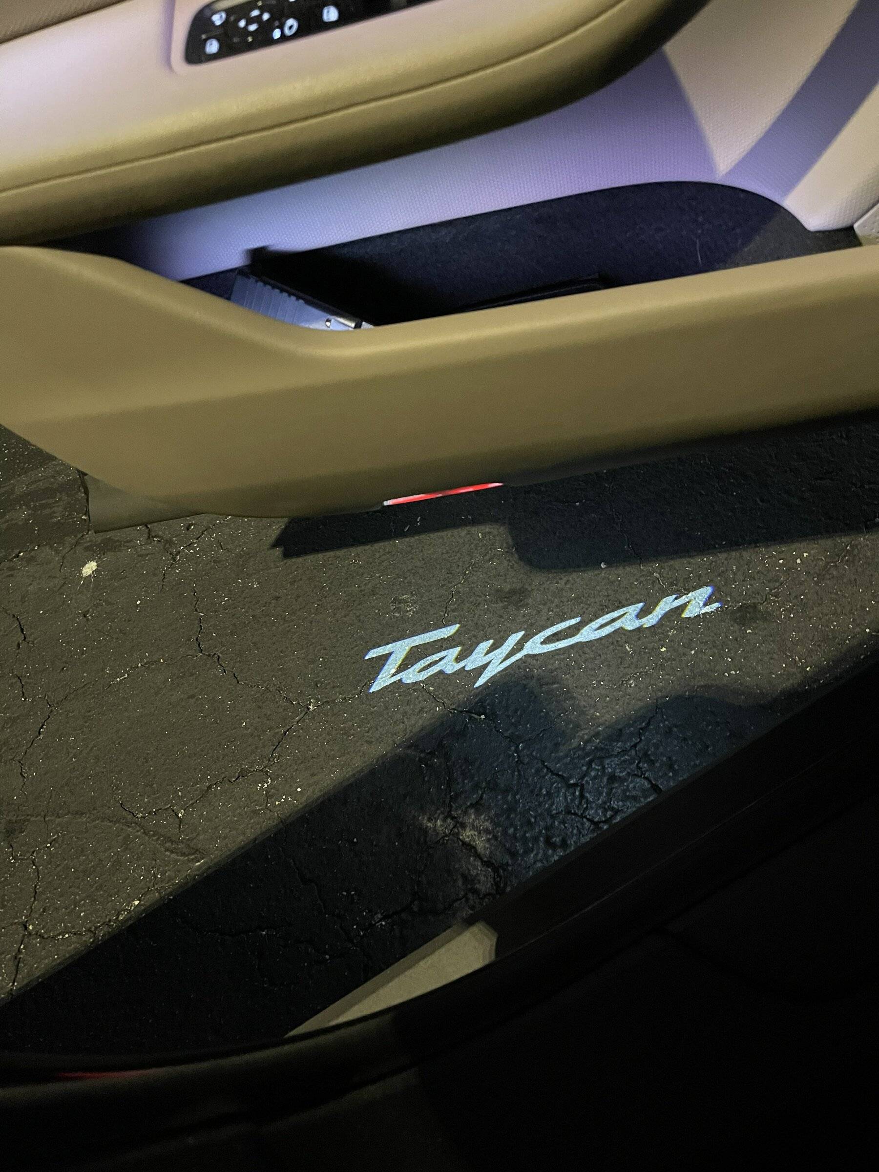

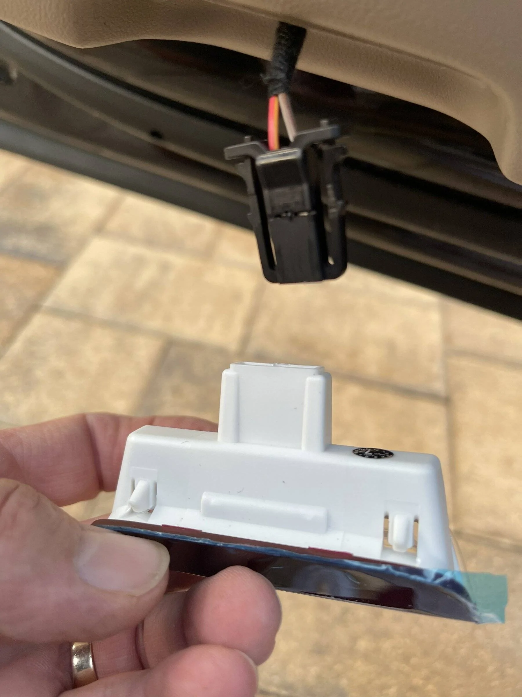

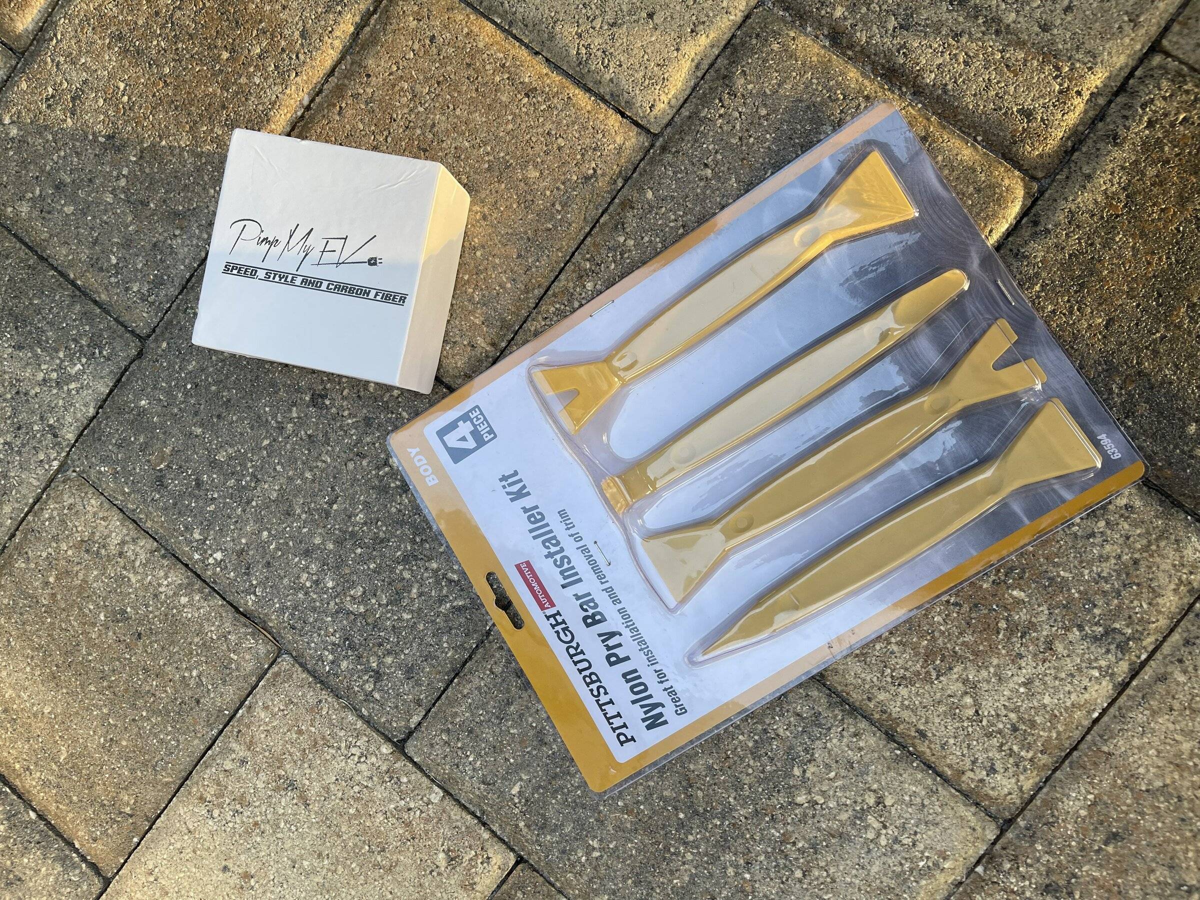

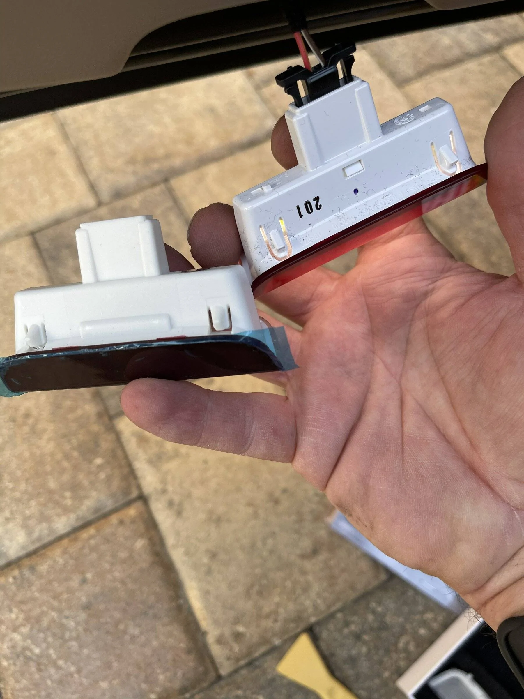

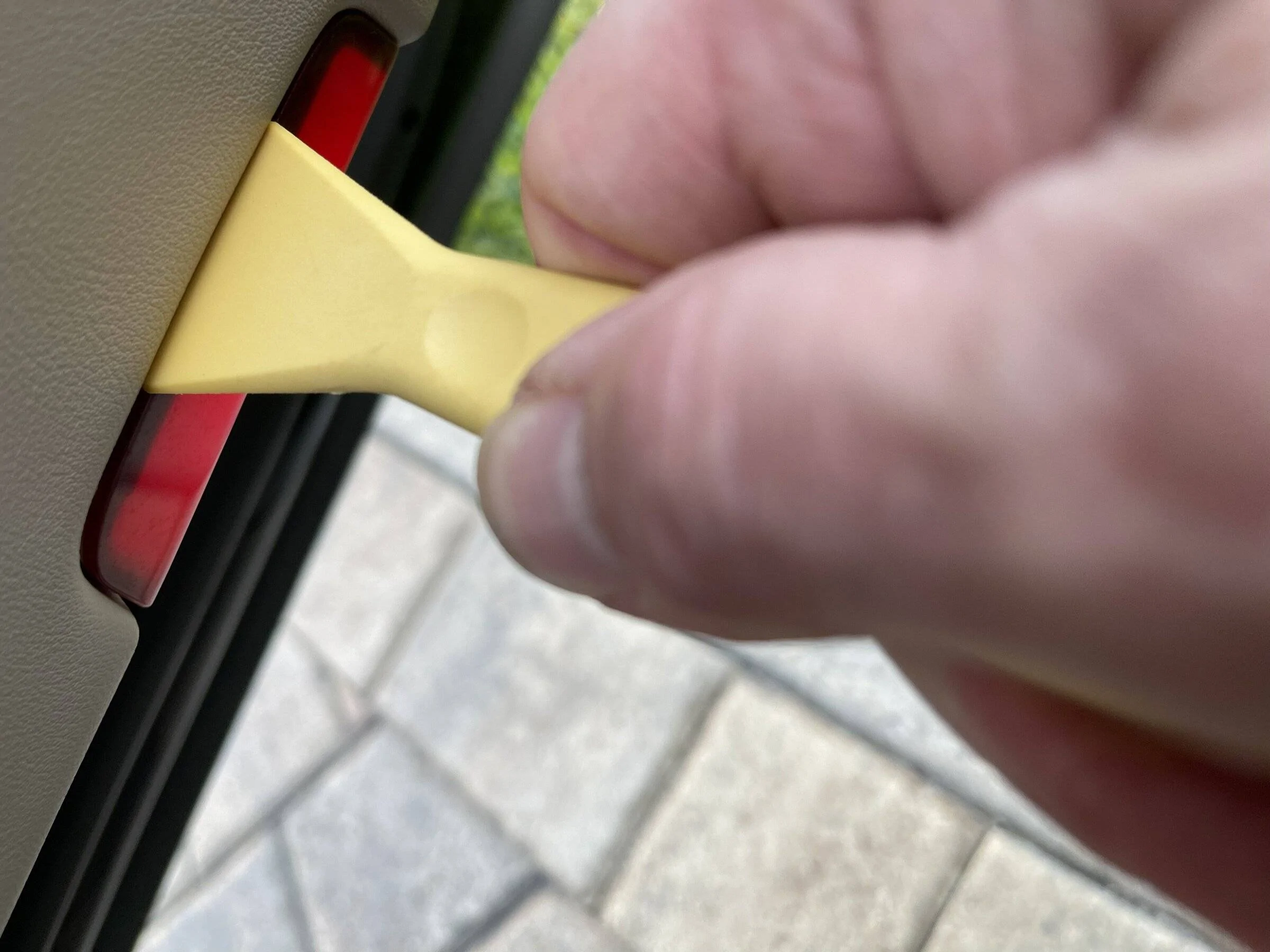

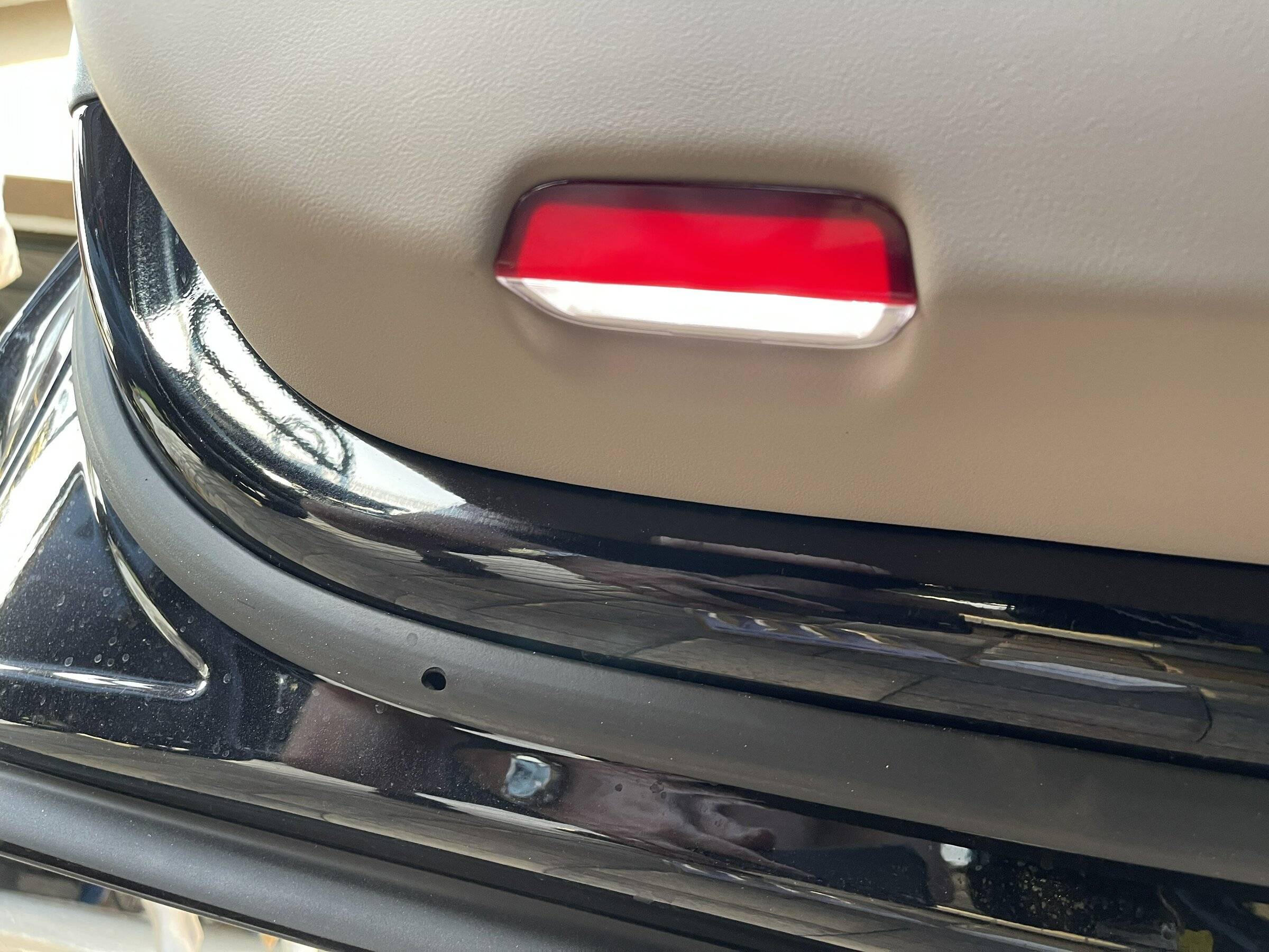

Just installed my PimpMyEv puddle lights. $90 shipped (if you order OEM from Suncoast they are $159 and ordered with the car is a $330 option). It does take some time to receive and you have to email him what you want as the Taycan/Porsche stuff is not on his website anymore.
If you can change your cell phone case and plug it in to charge, you can do this mod.
You do not need the interior tools (I had them for my Dashcam install), a plastic card will work. Insert it in the top edge of the puddle light on one side and push you will feel the clip release, move to the other side and it will come out in your hand. The clips are a little different on the new one. The lens (red area) is glued to the housing (some other puddle lights have you replace that, this is a complete replacement, but I will say the glue is minimal so handle gently). Squeeze the sides of the black plug and pull it out of the OEM light housing. Plug it into the new puddle light (only fits one way) and snap the light back into the door. Done.

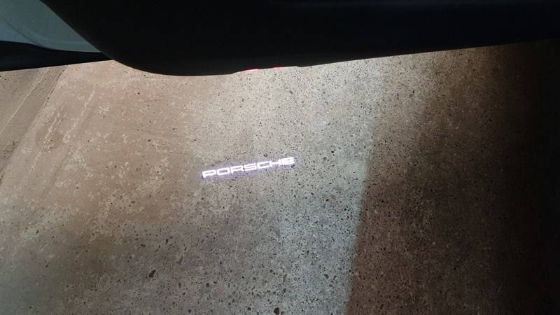

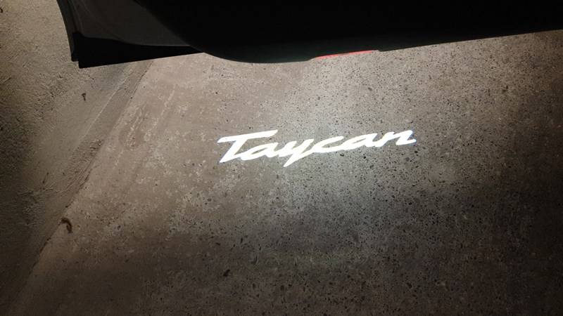

you don't need any tools either
Porsche Taycan Installed puddle lights “Taycan” befor
Porsche Taycan Installed puddle lights “Taycan” after
