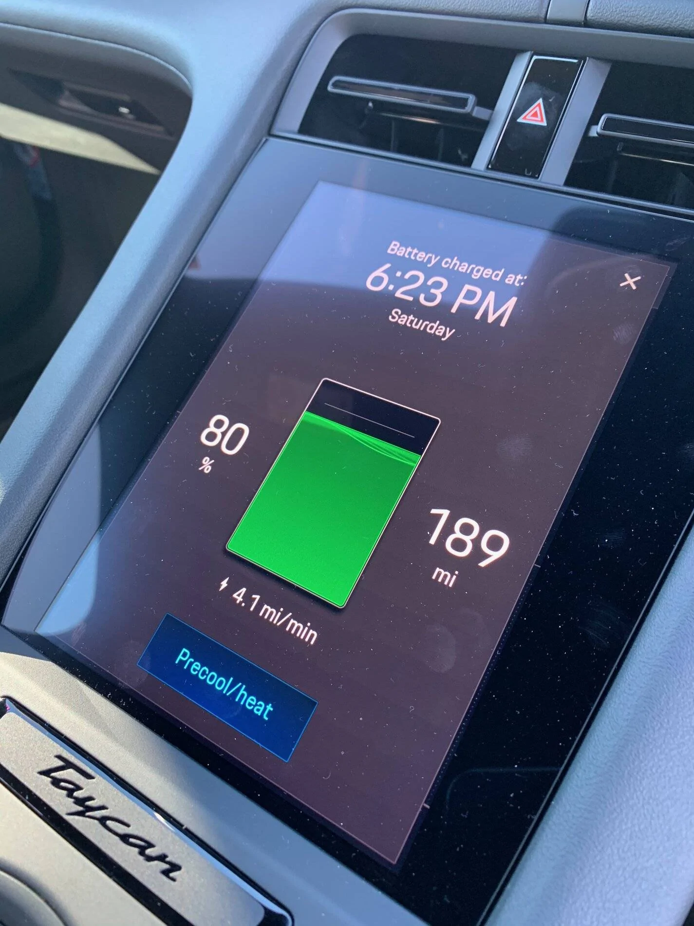

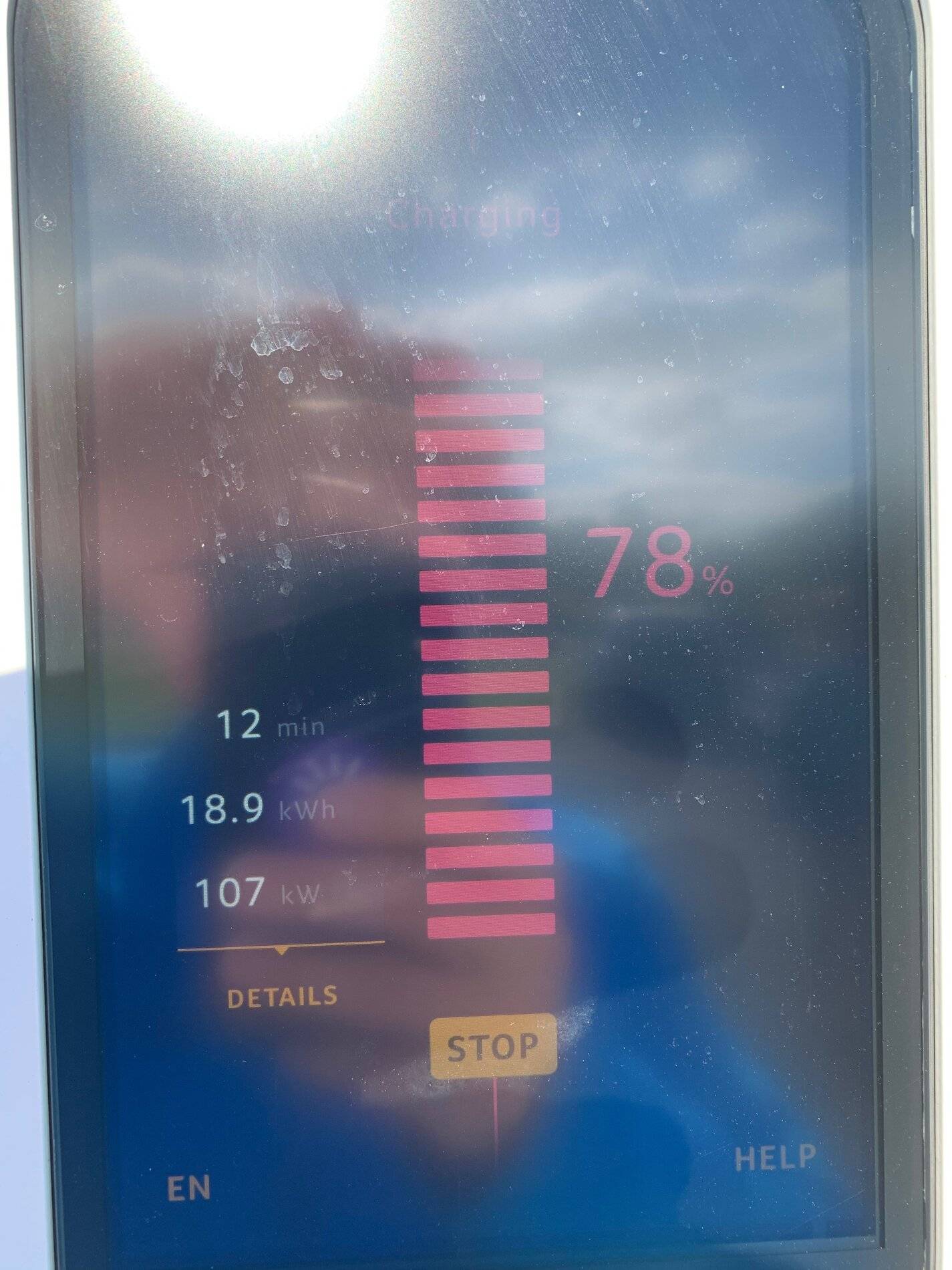

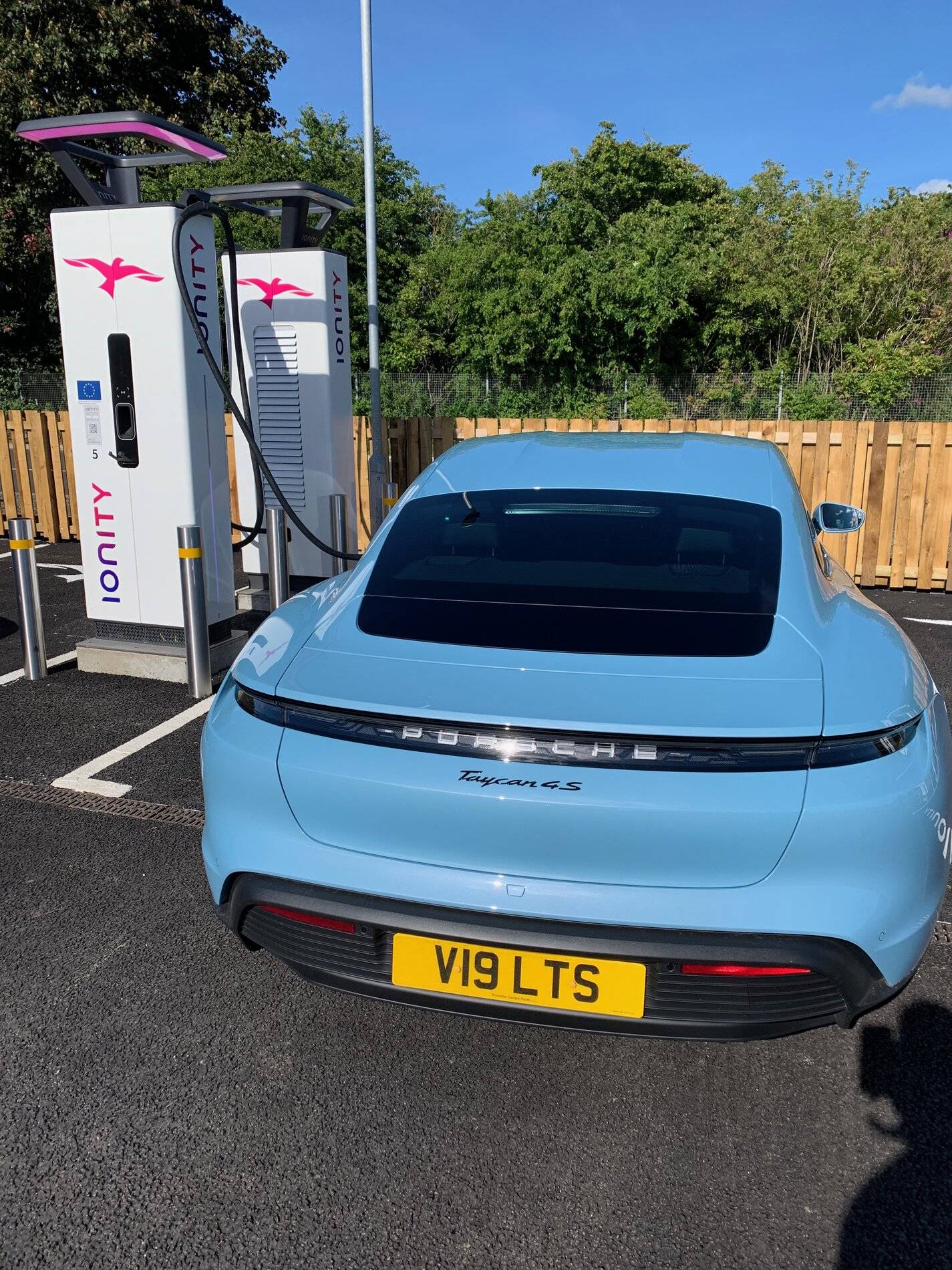

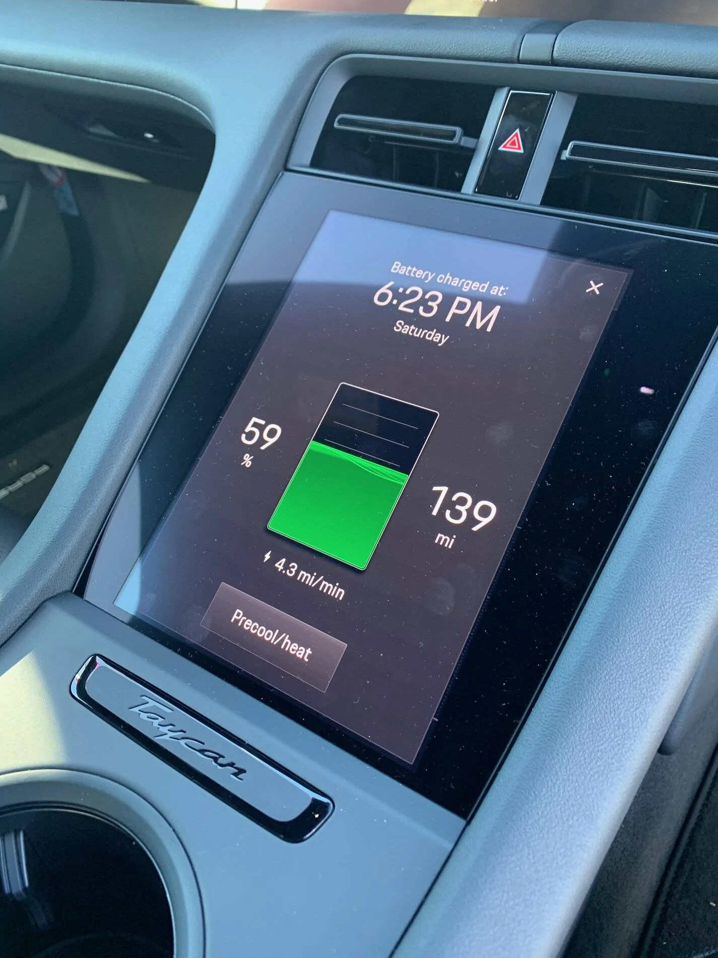

So I picked up the Taycan on Friday and decided to top up on the way north today at the new IONITY chargers in Perth, only a week or so since they where installed. I don't have the Porsche Card so used the IONITY app at an eyewatering 67p per kwh. Plugged in for 12 mins and got from 58 to 80% but only got to 107kw on the charger. Is there a trick to getting to 200kw+ ? Do you need to pre-cool ?

You can't get massive speeds if you start from a 50-60% state of charge. The way it works is: the lower the state of charge, the faster it can be charged.
Battery temperature is the other thing and there are two ways to improve that. Either use the Porsche intelligent navigation system to navigate to the charger or use Sport Plus mode and drive aggressively. The temp needs to be high in order to charge fast.
The only way to get the super high speeds is to start charging from like 10% charge and to pre-heat. State of charge is more important than the temp, but temp is fairly important too.
Haven't tried Ionity's yet but I got 120kw from a 150kw charger starting from like 40% SoC. Without any pre-heating. It stayed at around 100kw for a long time and then started a rapid drop down. And when it did the rapid drop down it was a good idea to stop charging, as that charger had a per minute cost :D

We are having chargers fitted at our offices by E.On and one of their engineers seemed to think that the Ionity chargers are currently throttled at 150kw. I was told that they are still testing them and will increase the limit once they are happy. Not sure how true it is.
