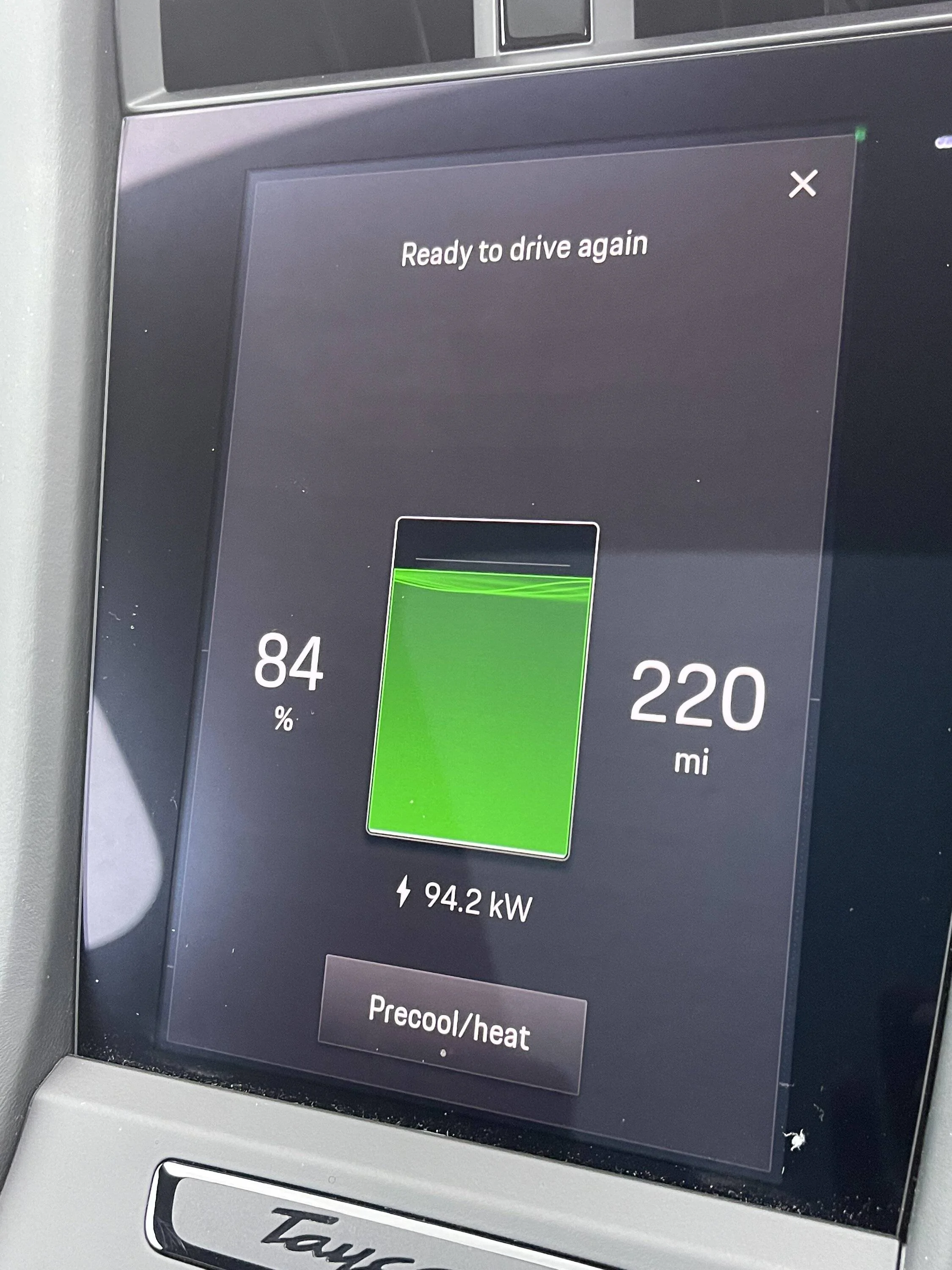

First charge at IONITY yesterday and had a couple of problems.
I arrived with 5% charge left. Very scary !
Firstly Porsche navigation was misleading and I got a message saying not available and that I wouldn’t make it and no alternatives! I know that’s a valid site as my cousin uses it so I was worried to say the least.
When I arrived all chargers were full but I waited about 5 mins and one came available.

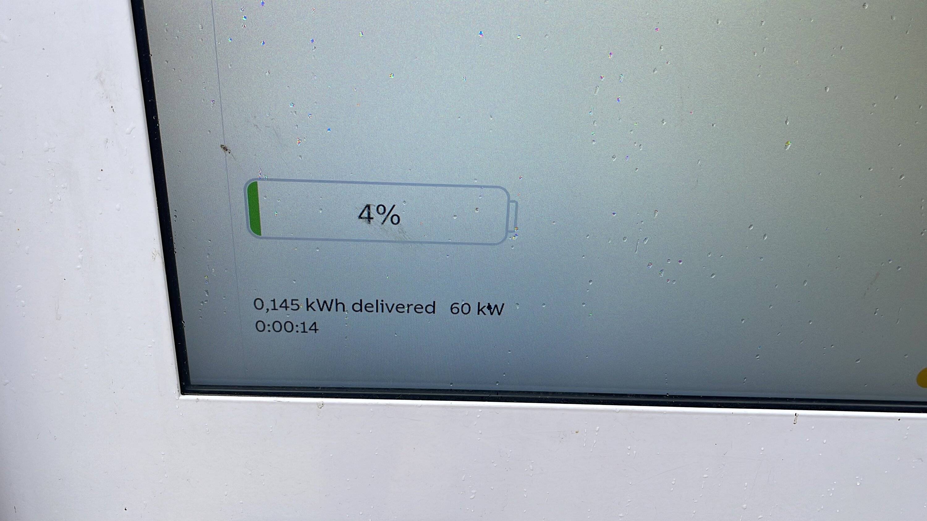

I used the Porsche app and started charging got a charge rate of 68kw when these are supposed to be 350kw!
When I finished it seemed to say no cost to charge even though I had topped up for at least 60%.

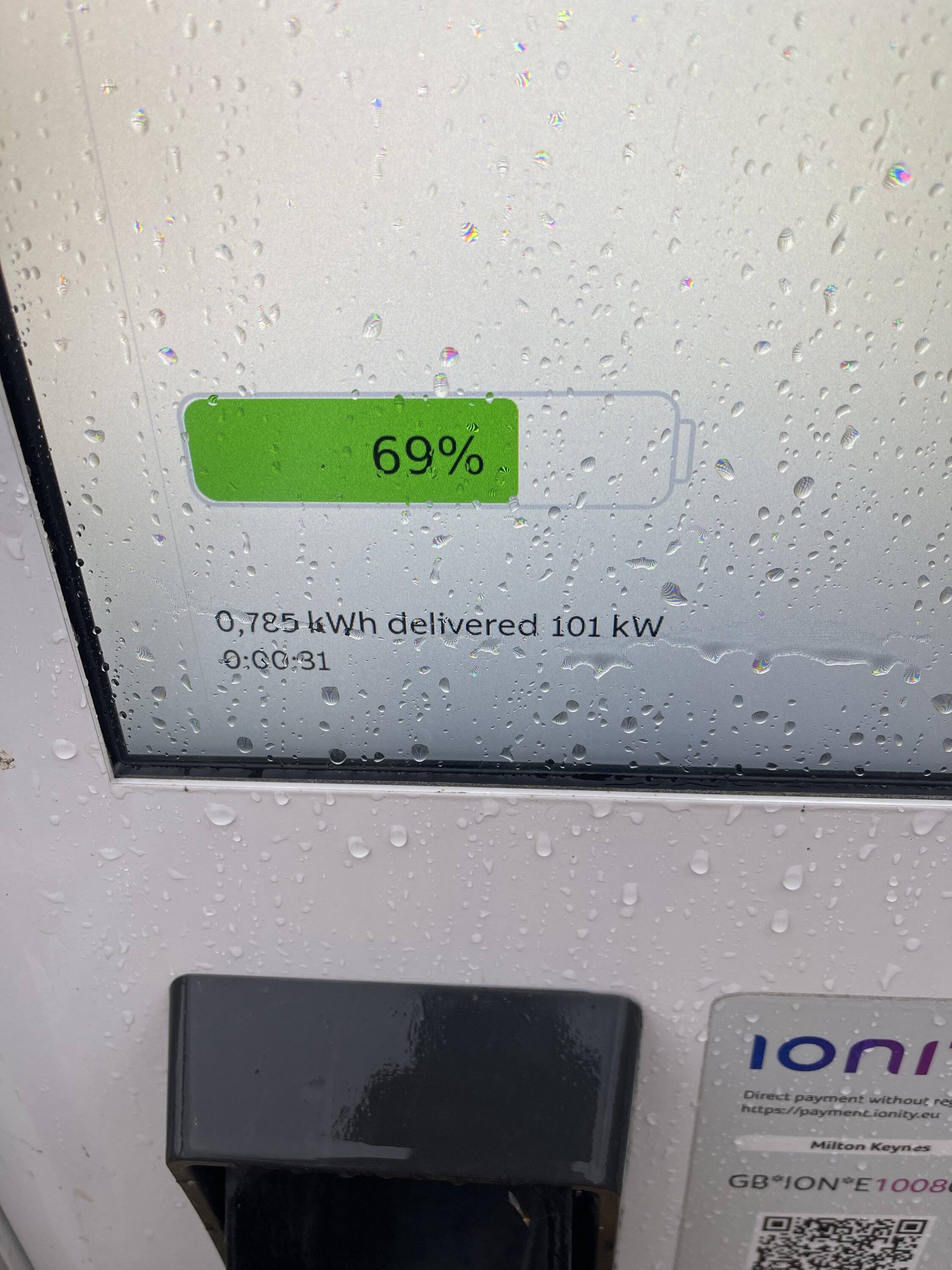

After ages I stopped and tried the neighbouring charger this time it said cost was 30p ( I would rather pay and get a quicker charge!) and I got a charge rate of 101kw.
Not sure what I did wrong but I’ll learn for this evening when I use another IONITY charger at Beaconsfield.

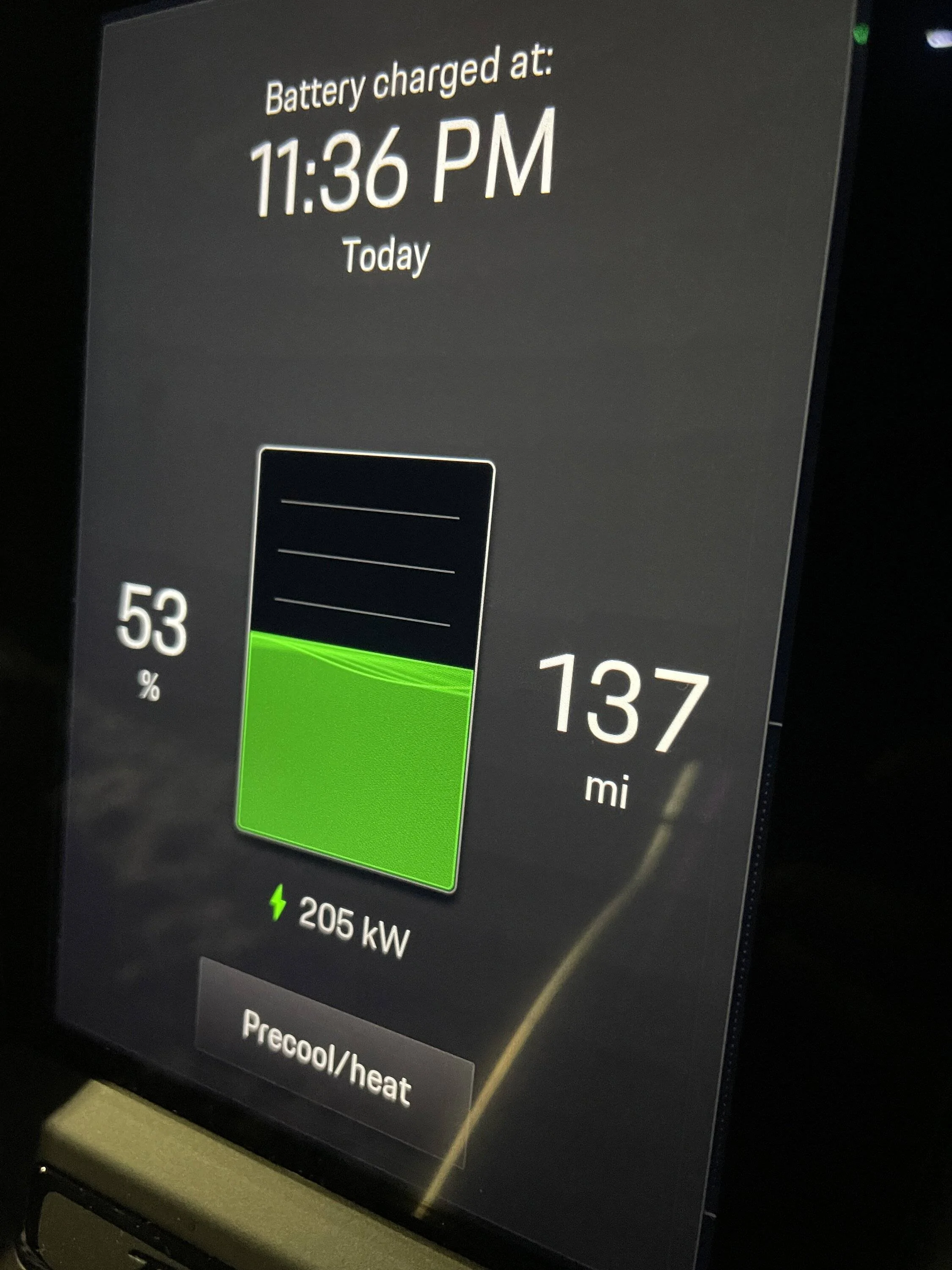

Later that day (9pm) I came back to the same set of Ionity chargers at cobham, used a different stall which was the last one available. I arrived with approx 10% this time an it immediately went above 200kw and stayed high for the full charge while I had a KFC (apologies).

I’ve never got above 160kw at beaconsfield IONITY in any of the five occasions I tried it
Milton Keynes though I got 265kw and it never charged me for some reason! I had always preheated but tbh I did also notice that fast charge battery optimisation was ticked in charging the day before I went to Milton Keynes so could explain the slower speed at beaconsfield
