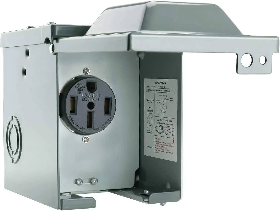

while the unit itself is pretty good in the weather - in North American the actual plugs NEMA 14-50/6-50/14-30/6-30/5-15 are not that water proof - so you can use the unit in the rain but the where the unit plugs into power may be dicy - so it's not recommended for long term use until you provide a weather proof enclosure for the plug itself
so the unit itself is pretty good, but it's "interface" to power needs consideration if you're planning on using outside year round.
160
5,809
8,642
something like this is best if you plan to use _ANY_ mobile EVSE outdoors for any length of time (PMC+/PMCC/Tesla/Mustart/etc)…as I noted most EVSE units themselves have some level of water resistance/proof - but the weak link is the actual power supply plug/cable and where it interfaces with the NEMA plug - best to have a weather proof enclosure for the plug - and if possible deep enough and with enough volume to actually take the plug - you still need the box to take a Hubble Commercial grade socket NEMA 14-50/6-50 and it's bigger/deeper than normal NEMA 14-50/6-50 - so finding an enclosure box with the proper size/volume/face-plate for the commercial grade Hubble NEMA 14-50 socket is the trick…
the PMC+/PMCC are fairly water resistance and safe to use outside, but demand a thorough power supply solution for where they plug into the power source.
https://www.amazon.com/RVGUARD-Weatherproof-Electrical-Receptacle-Motorhome/dp/B083LFF2Q1/ref=sr_1_5?crid=3SBOJEVBYBHG9&keywords=nema+14+50+outdoor+enclosure&qid=1684695022&sprefix=nema+14+50+outdoor+enclosure,aps,127&sr=8-5&th=1

make sure you get the Hubble commercial grade socket along with that enclosure - it's bigger/deeper than the average NEMA 14-50 outlet so it may require a different solution that your electrician is planning…
the proper Hubble socket recommended/required by Porsche is noted in their NTSB charging document - noted here…

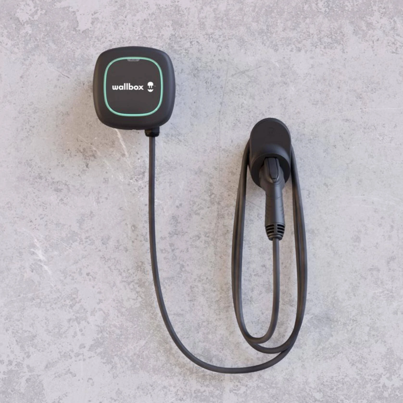

just install one of these and be done! hardwired weather proof install, 25ft cord, will charge your standard Taycan 20% faster than the PMC+/PMCC (60 amp breaker vs. 50 amp breaker - 48 amp charge rater vs. 40 amp charge rate).
https://wallbox.com/en_us/pulsar-plus-48a
Pulsar Plus 48A240V (Level 2) | 11.5kW | 25'
$699
adjustable amps from 6-48 amp to accommodate any install breaker size - hardwire it for confidence and safety for outdoor use -
NOTE: the Hubble plug alone is a $100-$150 item - that savings alone discount this charger to close to $500 - and you also then don't need a fancy outdoor plug enclosure…

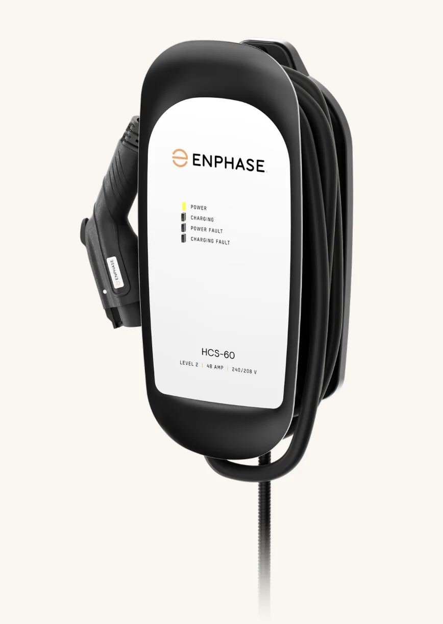

https://enphase.com/store/ev-chargers/commercial-ev-chargers/hcs-60-ev-charger
HCS-60 EV Charger
48 A, hardwired, ruggedized, 25 ft cable
$699
HCS-60 EV Charger
