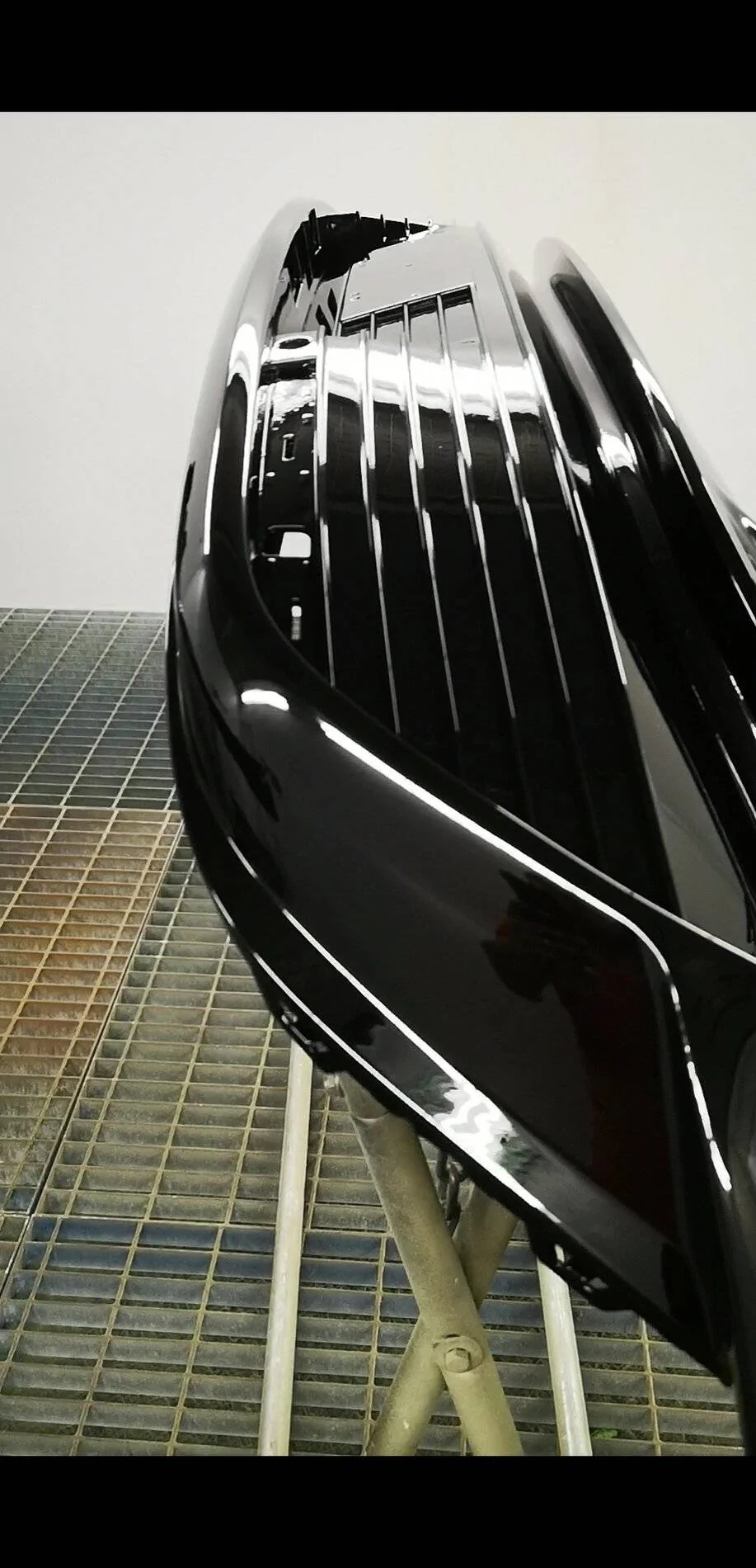

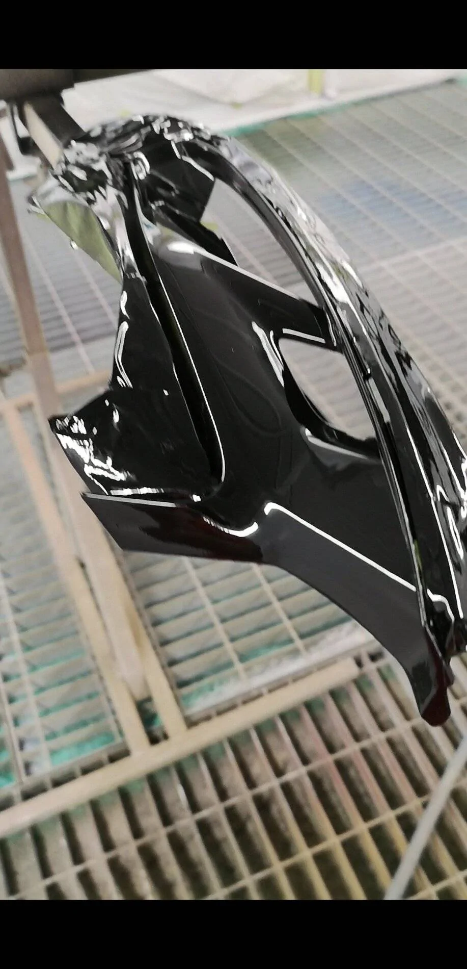

Was very happy with the results of PPS CLARITYCOAT , This was changed from the original plastic to high gloss black. Carbon effect is possible just need the right person to be able to achieve the carbon effect :).
nice, do you have more pics after the fitting?
Interesting. I was told no PPS could attach to that kind of plastic. They said it would just slip off over time. How's yours holding up?
Do you have a final picture, all finished in the car mount?

Looks really nice. Did they have to sand the plastic in order to get it to stick? I had been advised that it might not stay in place if they did not.
Same question here. I wanted to wrap the plastic and was told it would not stick unless sanded. Looks fantastic!:rock:
