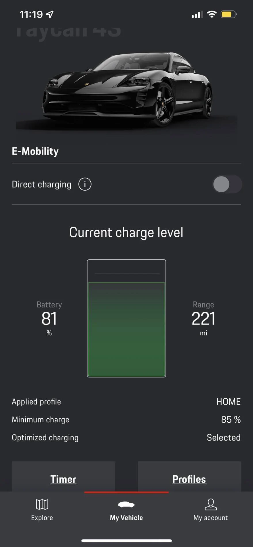

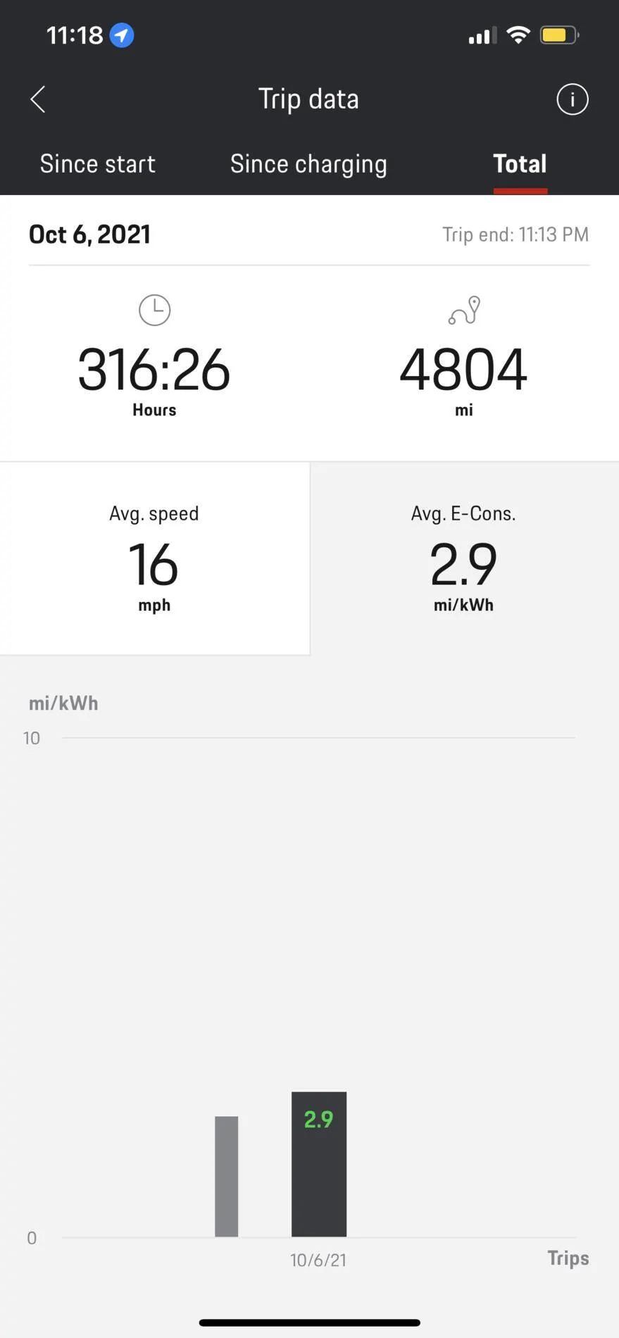

Thanks. My PCM shows that I’m doing >270miles as well on a charge based on almost 5000miles total - see photos. These numbers however are completely unreliable as I know that I am nowhere close to that range, with the battery depleting from 85 to 10% every 150-160miles…. I wonder if you’re monitoring independently your range or whether you’re reading off consumption from the PCM? Thanks
