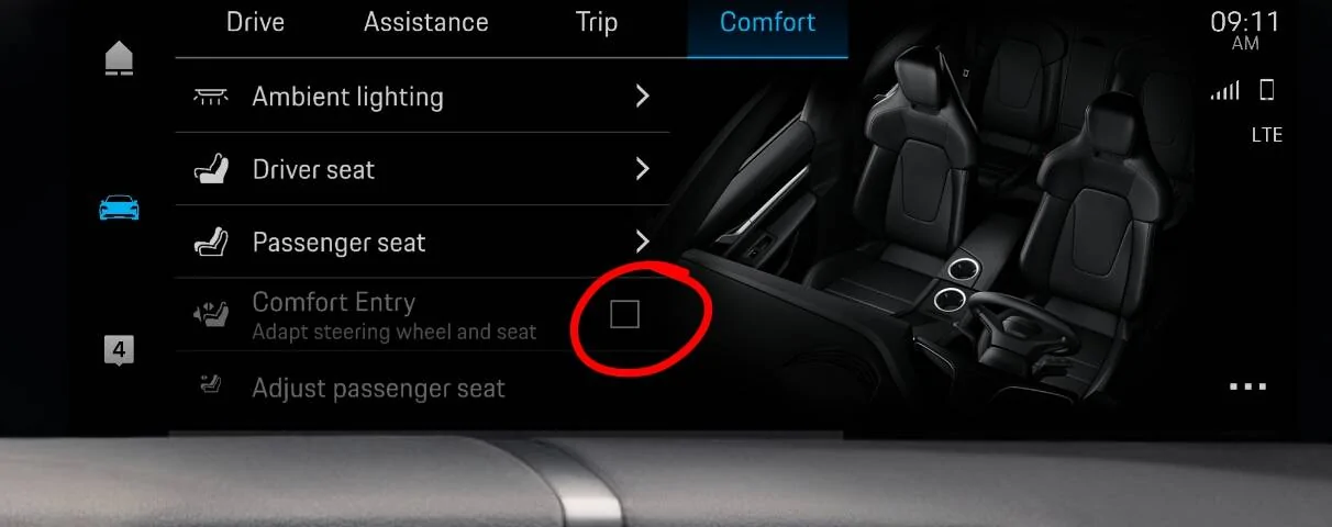

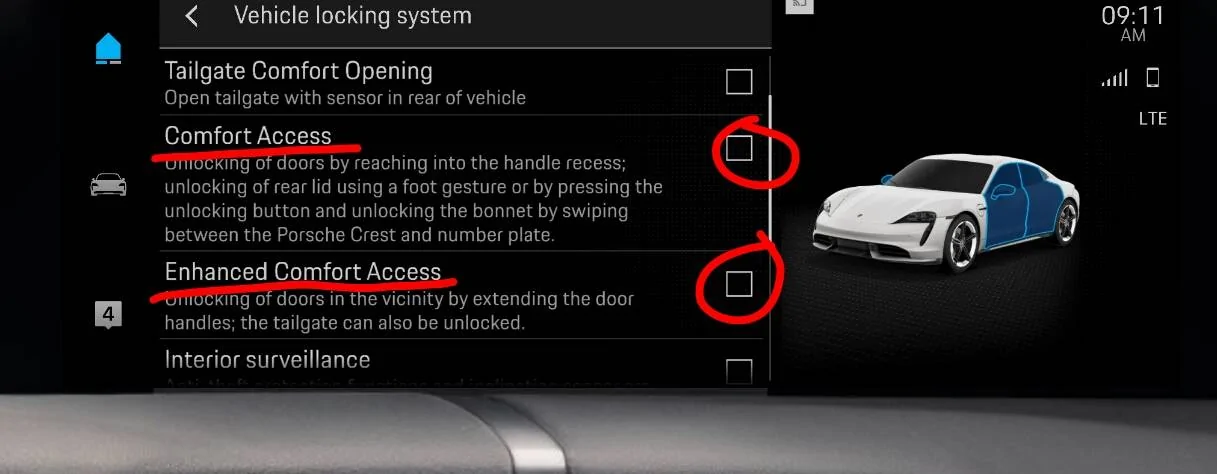

After receiving the 15 hr software update 2 malfunctions
1. courtesy opening for trunk and hood no longer work
2. driver side seat memory position no longer positions seat after starting car
Dealer told me they will inquire with Germany to see what can be done
Dealer told me they are seeing other owners with some issues after update with most common problem with gps / navigation
Anyone know how courtesy opening works? I do not see any sensors for opening trunk by moving foot or hand movement re hood

1. Is comfort access active?
Did you go through your settings?
You can deselect trunk opening (for car wash).
2. That's also a setting, go find it.
First you have to tell us what you already did before calling it a "malfunction".
There are so many modules updated and they have many settings too.
Or is the dealer the one that informed you about the "malfunctions"?

I do not see any setting for the courtesy opening so at this point i cannot resolve the issue,appears tb software related. Re memory seat, that i do control however it is not working correctly. When i unlock the car the seat does not return to memory position( memory triggered by FOB)I have to push setting 1 for seat to correctly position. I have seen a couple of other posts with same issues

Thanks guys for helping me. It turns out the comfort access options were checked. I unchecked them them rechecked, turned car off and now it works. I did take car to dealer and theyntold me it was a malfunction. Forum seems smarter the my dealer

I have the same issue with the courtesy opening and the passenger side mirror not 'dipping down' when reversing... be interested if anyone finds a resolution.. I have asked my service provider if these are known issues and if they are going to address..
See @Dee's post above to check / uncheck / recheck your comfort settings.
Adjust the door mirror to the kerb dipped setting when in reverse gear and also check the comfort setting has been enabled. Put the car in neutral and wait for the mirror to level. Should be fine after that.
Did you try to switch it off, store it (by pressing the memory button in the door) then on again?
ok will try that.. thanks....
