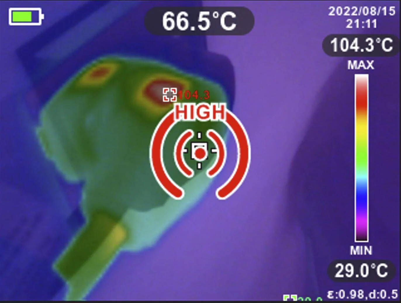

After having dangerously high heat issues with the Porsche Mobile charger that came with the car, when NEMA 14-50 plug hotspots reached 104.3C (220F) after an hour at 100% power:
Porsche Taycan J+ Booster: Juice Booster EVSE For USA 1665254283046
That is water-boiling temperature - so if were to grab the plug at this time, it'll burn your skin in seconds.

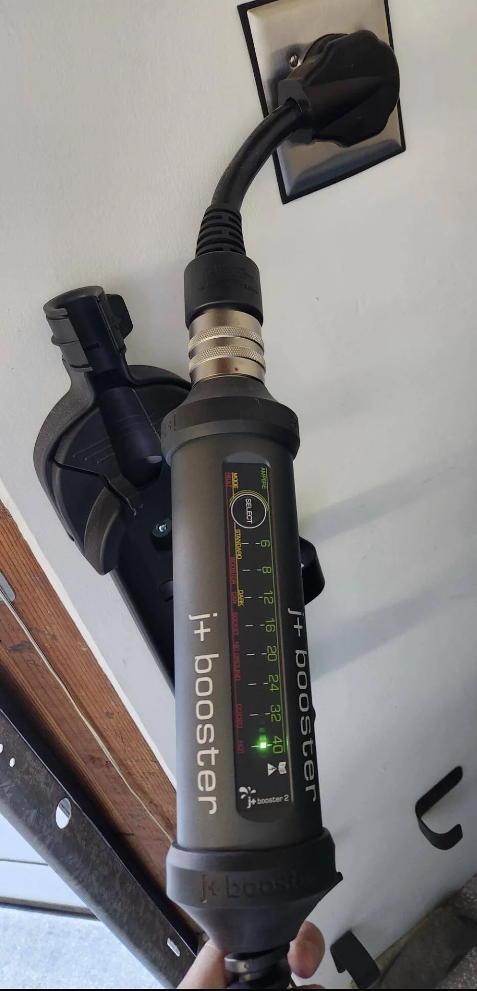

I decided to try the j+ Booster 2, since it just came out, and reviews were mostly good. I ordered one from Amazon (for $700) and tried it out last night.
Porsche Taycan J+ Booster: Juice Booster EVSE For USA 1665255055494
It is well made and rugged - the metal cylinder + rubberized ends. It also feels lighter and not as bulky as Porsche's charger. It allows to select EIGHT (!) amperages, and here is what my Taycan is showing for each:

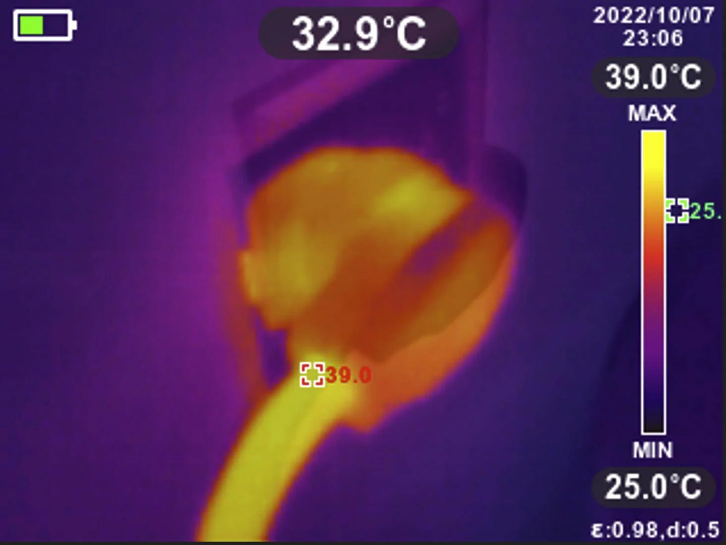

Thermal results are quite good. The hotspots at the 14-50 plug (see above) are no longer there, and the plug feels barely warm to the touch. The unit itself and the J-plug are body-temperature. The hottest parts are the wires -- thick short wire from the wall, reached 39C (102F) after an hour:

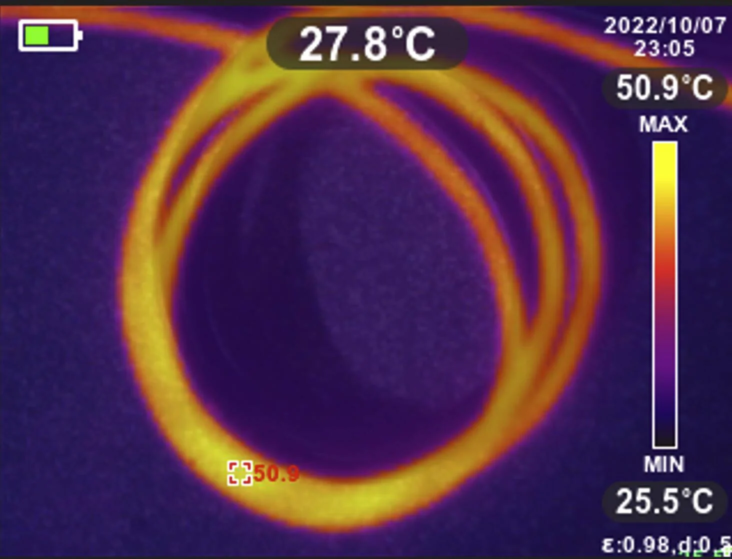

and the 21-foot wire going to the car reached 50.9C (124F):
Porsche Taycan J+ Booster: Juice Booster EVSE For USA 1665255297418
So, in summary - it's a great device, BUT it's a shame that the wires are underspec'd... I understand that 10AWG is "safe" by electric standards, but I would prefer a stiffer & thicker cable if it stayed cooler and wasted less energy into heat.
It's definitely a WHOLE LOT better than the Porche's charger, especially after Porsche recommended to use at the 50% max. And so, I think I'll keep the j+ Booster.

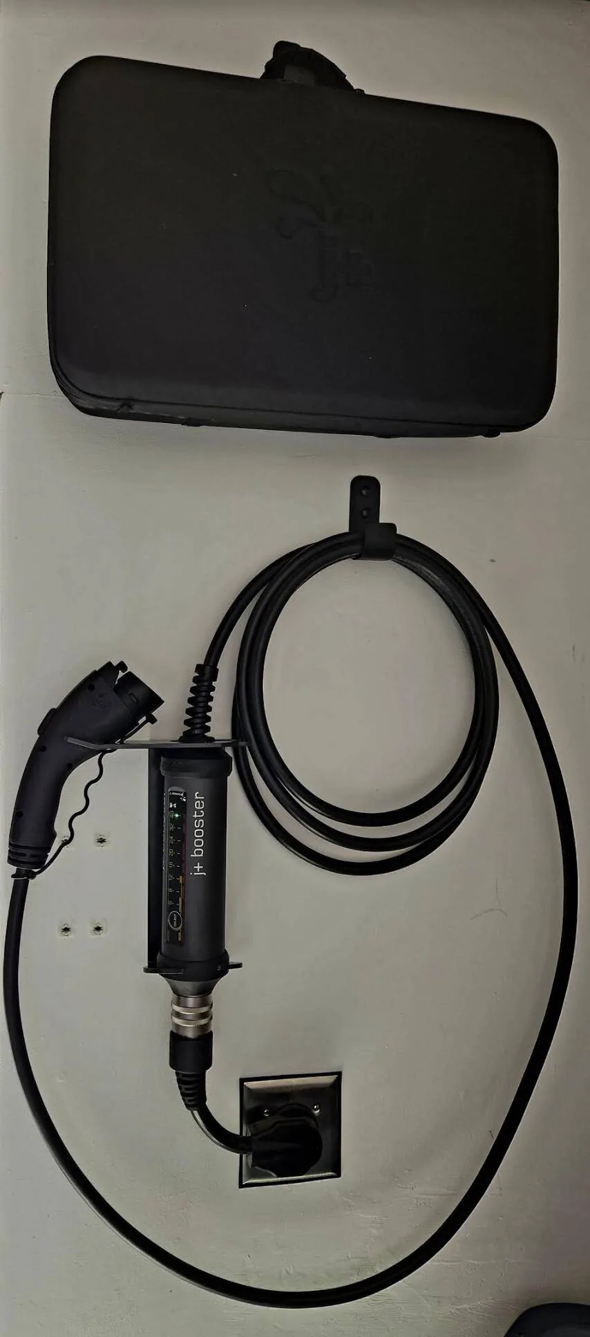

I just took out the Porsche charger, installed the J+ Booster's charger bracket, which is quite simple, but it works well. It's upside down, because it allows me to manage the cable better. I also used a couple of utility hooks - one for the cable, and the other for the carrying case (which is kind of bulky, could have been much smaller!)

hour:
Porsche Taycan J+ Booster: Juice Booster EVSE For USA 1665255175274-
Porsche Taycan J+ Booster: Juice Booster EVSE For USA 1665255297418-
Is the second picture while the car still is charging? I.e. did you have the cable coiled like that While charging. I wonder if the cable would be cooler if it is uncoiled and as straight as possible? You are still sending A/C to the car and that could a magnetic field? Just looking at your picture the cable seems hotter where it is doubled?
