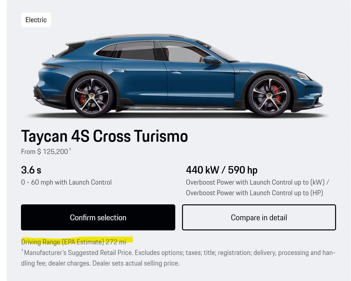

Then the only plausible explanation given that you have plenty of miles to have it break in properly, that cold weather requiring to keep the battery heated, significant impact on aero in snow and wind, significantly higher rolling resistance of tires in the snow results in 35% range decrease from ideal conditions where the 364-mile figure was collected.
Quick check of the US Configurator (below) shows EPA range of 274 miles, which means to me that 300 miles is about max under ideal conditions.
Also, recent thread with range and efficiency data may be helpful as it is showing similar results:
https://www.taycanforum.com/forum/t...n-turbo-cross-turismo-j1-2.23182/#post-353168
Porsche Taycan J1.2 4S Cross Turismo range data point 1735761146241-b8
Typical decrease in range for pre-facelift J1.1 models is also in a 30-35% range in cold weather at highway speeds between 70mph and 80mph.

Over here they show the WLTP Range combined figure, that's the 364 miles I mentioned. Evidently wildly optimistic :), EPA seems more grounded in reality. No snow on the ground by the way.
