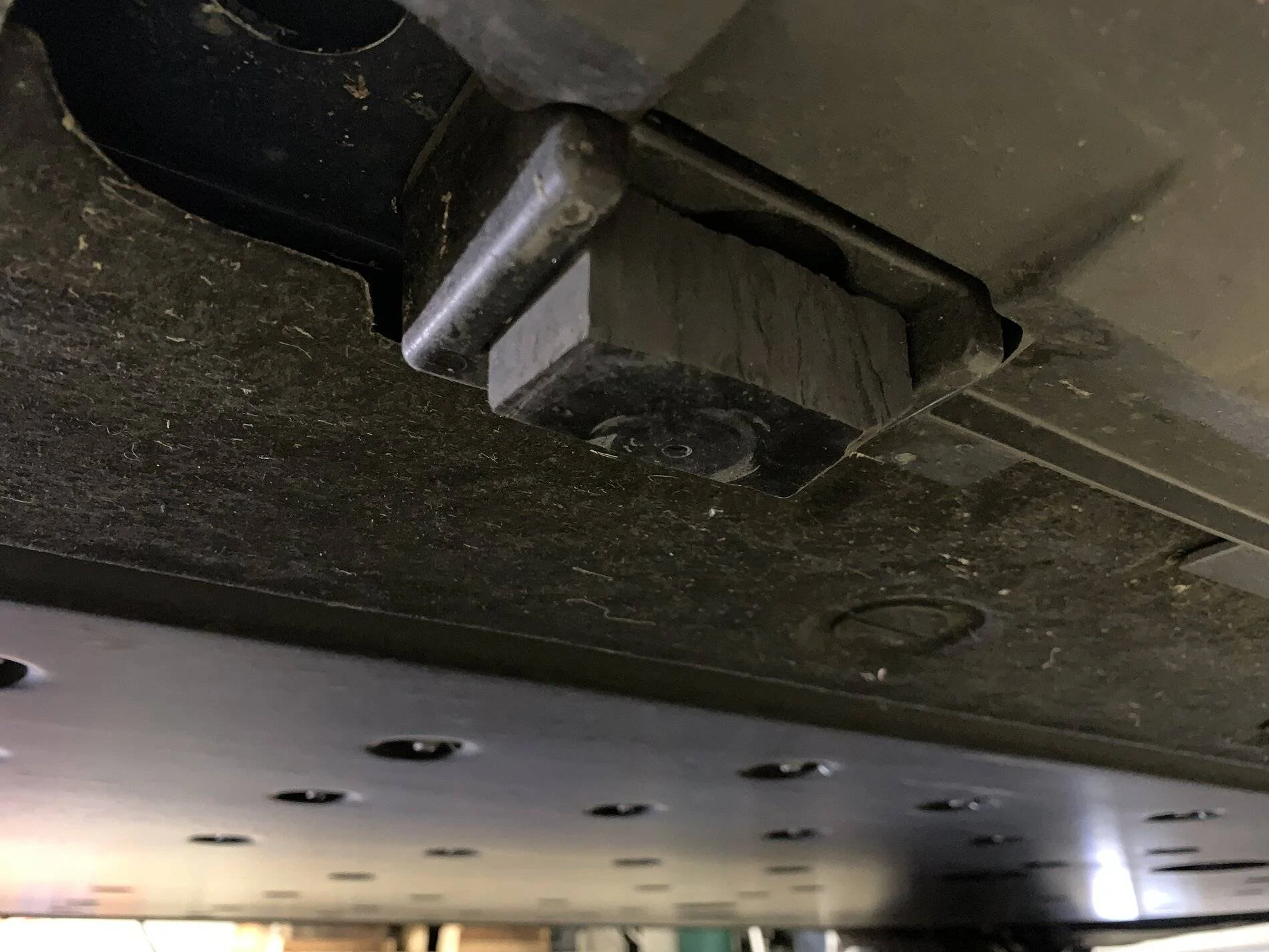

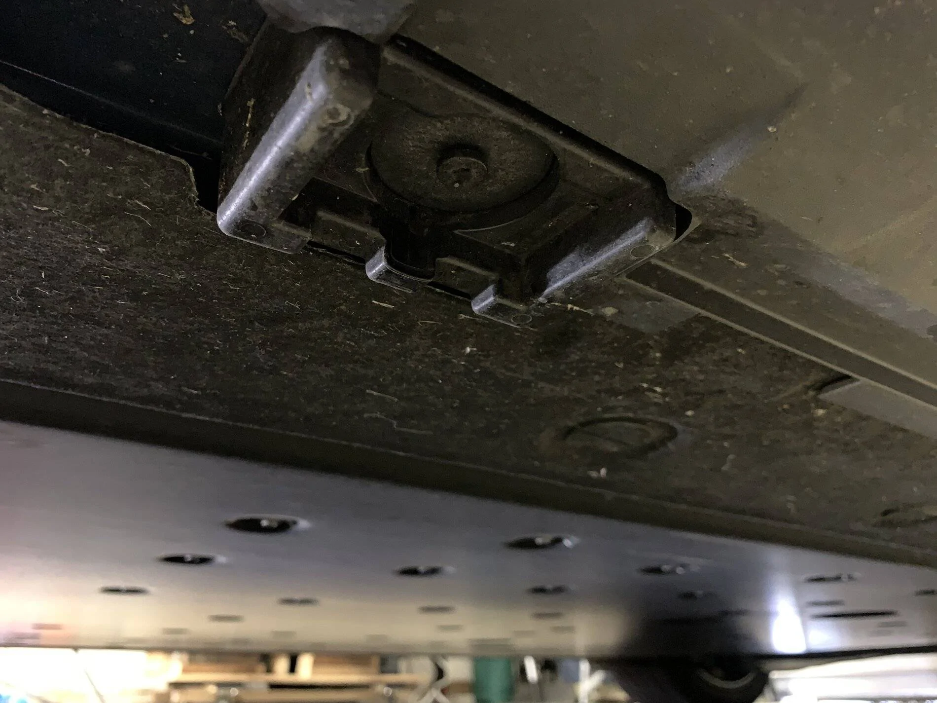

The Taycan jack from Porsche clearly shows a rectangular top. Pulling the jack pad off reveals the round hole. I’m pretty sure Porsche designed the car to be jacked with the jackpad in place. Ergo the BMW style jack pad.

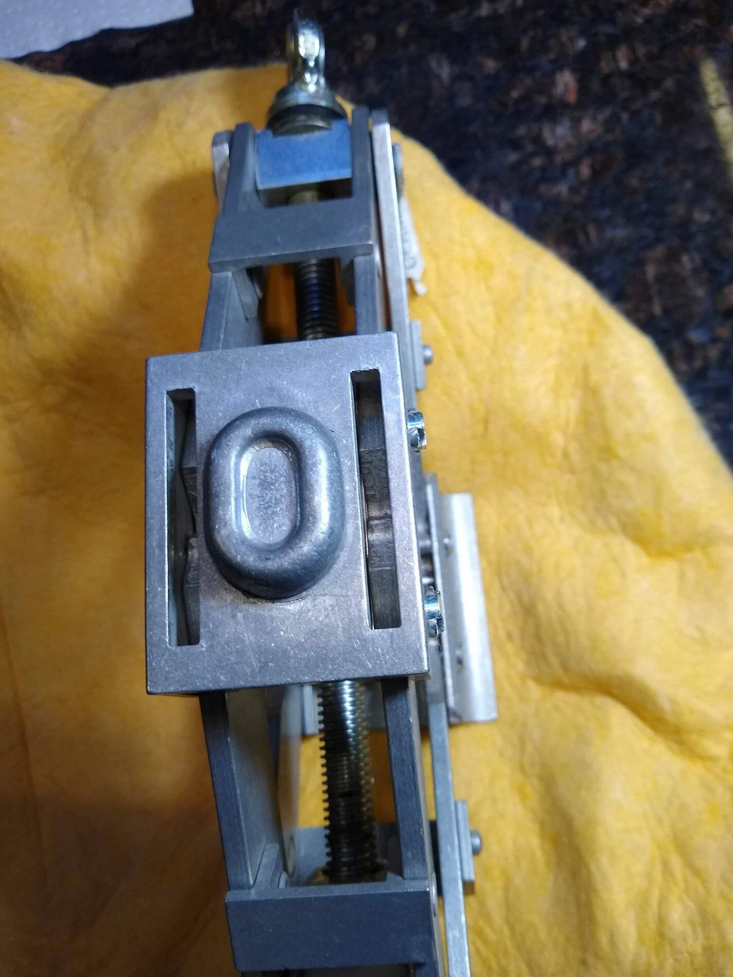

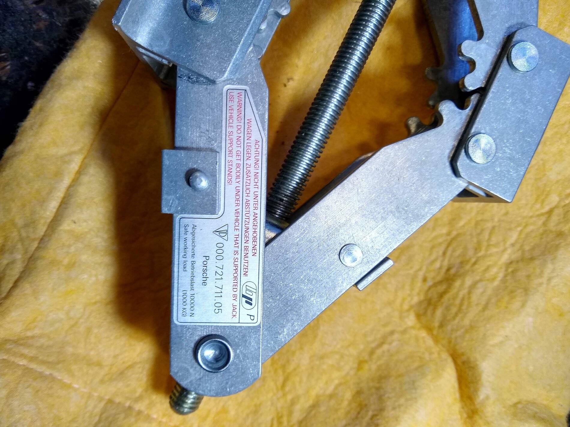

I tried using my Porsche scissor jack (worked fine w/ my Cayman S) BUT it would need a hole drilled to be reasonably safe (and I prefer to use a hydraulic floor jack w/ an adapter)..so the search will continue. The BMW pad looks like a possibility altho I would prefer something that "locks in" the pad so it cannot slide.

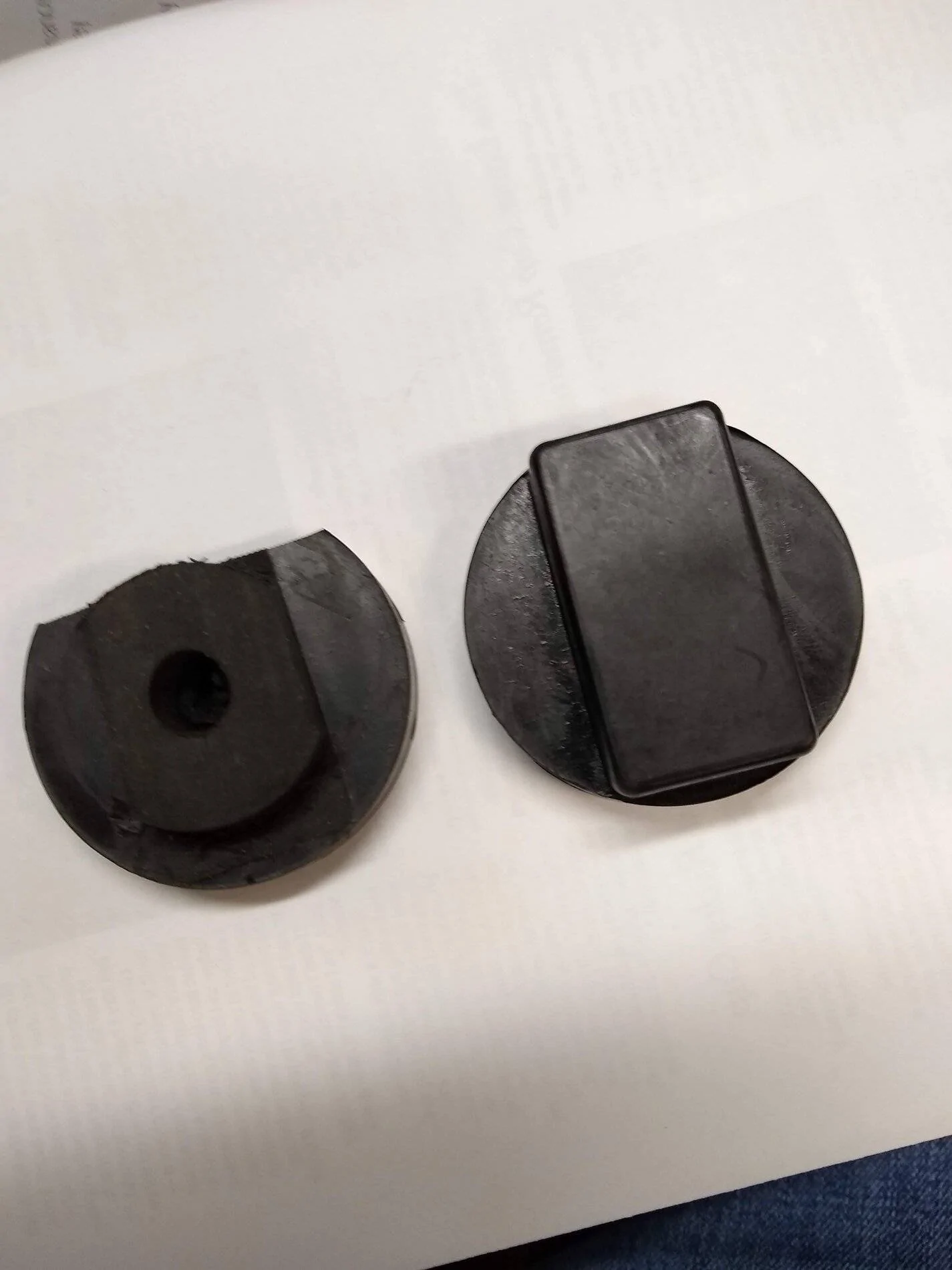

with a band saw and a drill press I was able to mod the BMW adapter and it fits Ok. It is crazy that it is so hard to get the right one "out of the box" - hopefully your supplier can address that . Thanks for your responsiveness and ongoing interest!

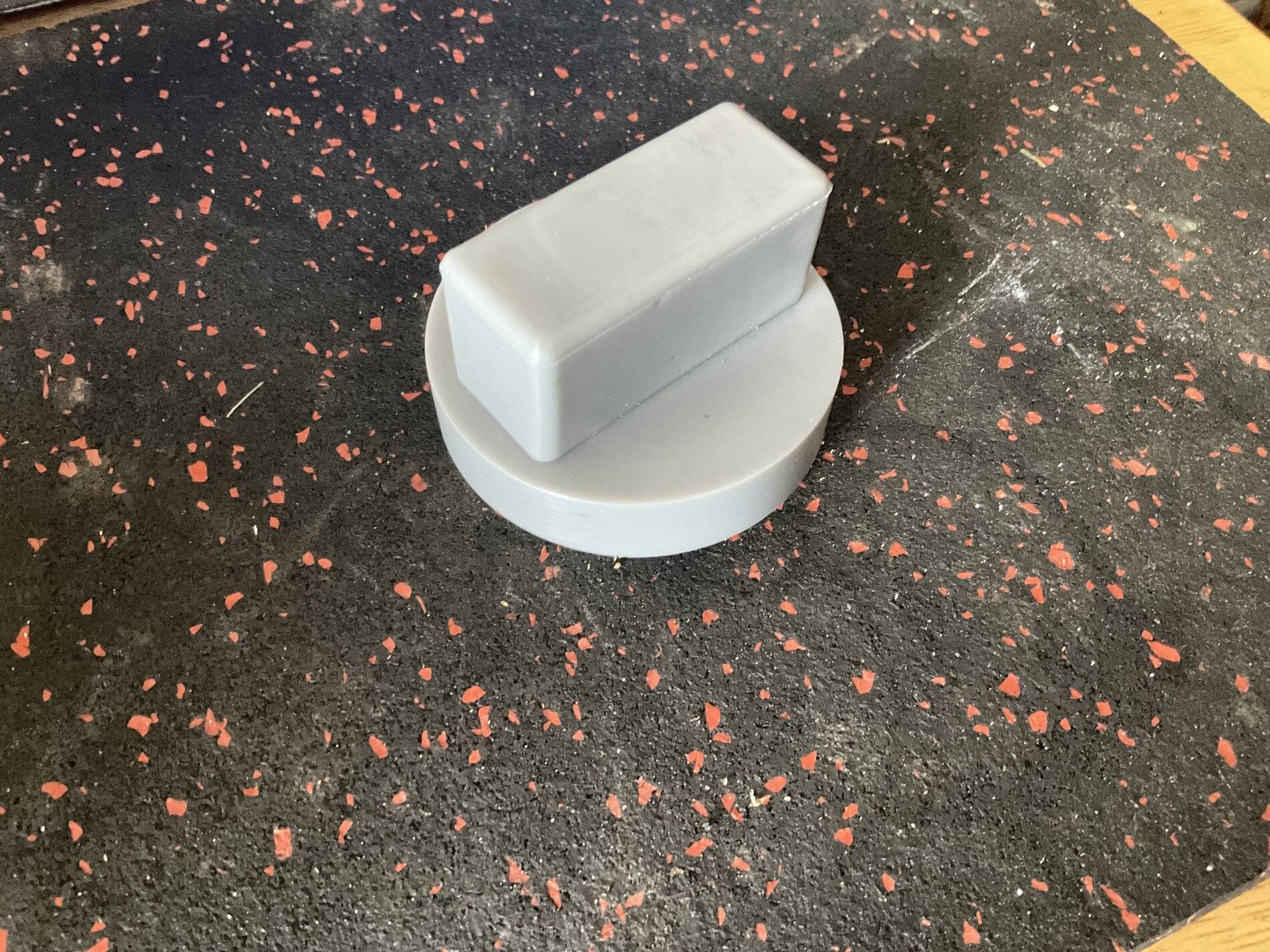

I have ordered a later model Panamera jack socket. They use the same jack. The parts guy said they have them in the U.S. so I should get next week. When it arrives I will compare with the Taycan socket and if the same will have a mold made and plug adapters soon afterwards. The Panamera was cheaper and would possibly mean more sales both Taycan and Panamera from my supplier. I wish it was possible to just leave him one of my sockets, but it looks like I would get road crap where I don’t want it if I drive the car without. From what I can tell the e-tron GT has a different setup, but I wonder if it would be possible to use the Audi sockets on a Porsche.
