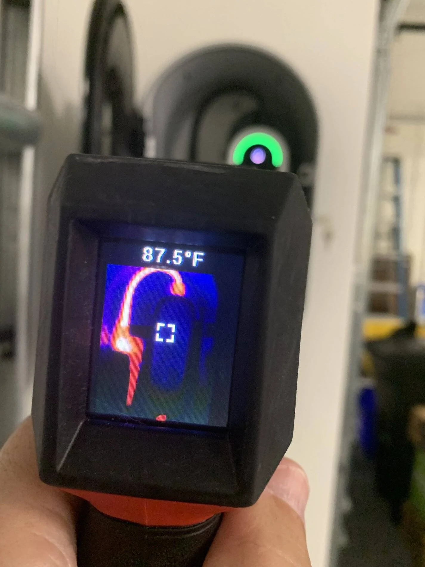

3) Still experimenting with ventilation of enclosure. As hot air rises perhaps cut with hole saw, ventilation. Perhaps with ventilation fan. Will experiment also with heat sinks.

I am on phone at moment. I will say continuing this thread that the pigtail is definitely the issue overall. As I have on extension to pigtail the pigtail plug gets way too hot. The extension cord I have does not. Significant design issue on pigtail. Where extension plug goes into receptacle no heat.
Some additional information. The trigger point to overheat per Porsche documents is 122 Degrees. As the pigtail is reaching 163 Degrees in my measurement, it is pretty clear why shutting down in enclosed and nonventilated box.
I think I am ultimately going to use a holesaw and create a hole in the bottom and top. In theory cooler air should flow through bottom hole, over heated areas, and exit above without use of fans. Just deciding whether to “ruin” my useless box.
