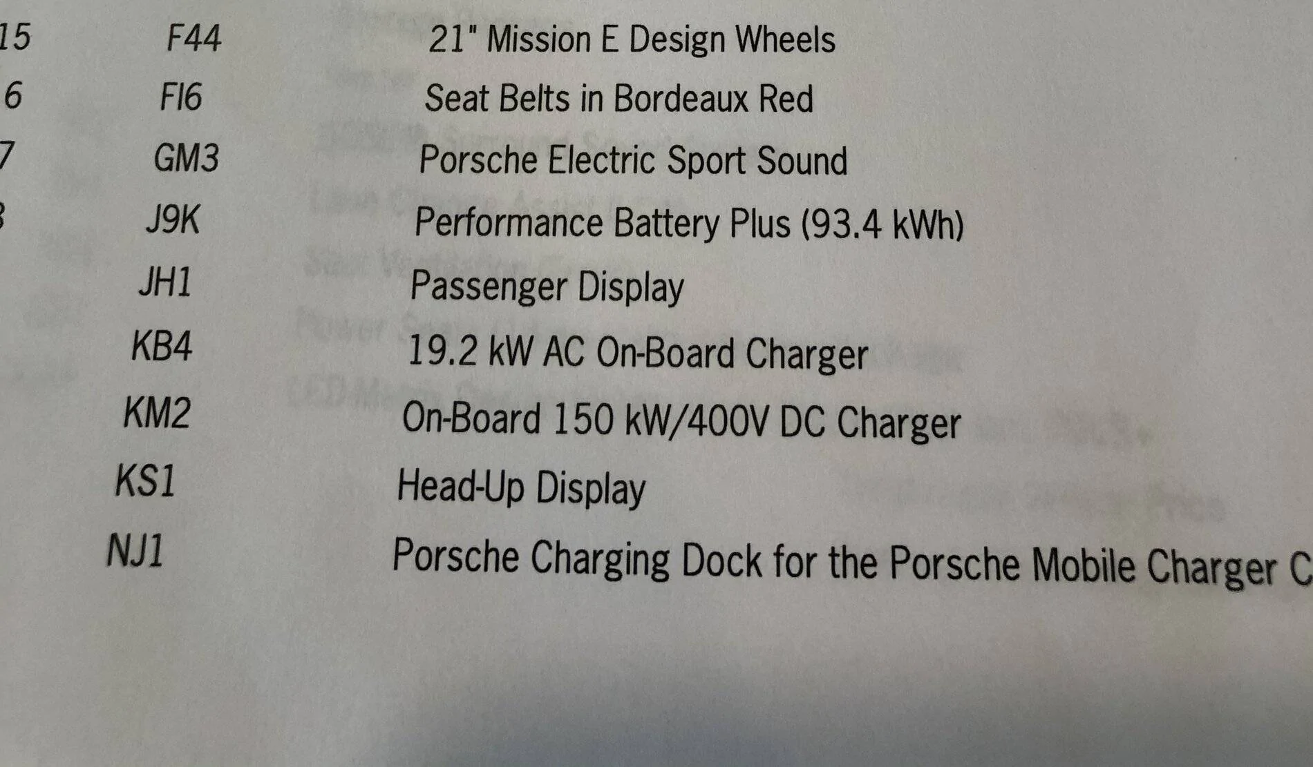

I live in Texas, US.
I've ordered Taycan 4S yesterday and added HUD and 19.2 kW AC On-Board Charger.
(You can add those options at your local dealership in the US but not at Porsche website.)
I have only 120V power outlets in my garage so I have to tell my electrician to install 240V outlets.
What do I have to tell him specifically? I've heard NEMA 14-50 only covers 9.6kW(240V, 40amps) but mine is 19.2 kW.
Thanks in advance.
Porsche Taycan Just ordered 19.2 kW AC On-Board Charger. IMG_1097

That's a weird option for the US. And a weird option in general. It's probably really a 22kW capability. I wonder if it allows plugging in both sides of the car at once or something, so you can use 2 50A chargers.
Without 3-phase power, you likely aren't getting 19.2kW. Be interesting if it's meant for 480V 3-phase from a farm or something. :p
It'd take a 100A rated 240V circuit, plus an EVSE that can handle 80A continuous to get 19.2kW, which is a bit crazy.

you'll need a Tesla Gen2 Wall Charger or the 100 amp ClipperCreek J-1772 charger…
19.2 kW is the most power covered by the L2 (240 volt) North American J-1772 charging standard to which the Taycan confirms.
there are _NO_ available 22 kW J-1772 chargers - because there is no specification for that much power with in the J-1772 standard/specifciations
now I'm sure Porsche could "adapt" the standard and publish a x.1 adendem to the specification, but the Taycan would be the _ONLY_ EV on the market with support for that - and I doubt there would be any market for J-1772 chargers beyond the Taycan market…
my honest opinion is that once you're talking more than a 60 amp breaker - a home/residential CCS charger would be a better choice - and the cost for the 19.2 kW charger covers about 1/2 to 2/3 of the cost of CCS charger - and you then don't need the 22/19.2 kW charger option cause CCS bypasses the onboard car charger and at least 50 kW if not 150 kW…
you are very very unlikely to run into 19.2 kW chargers in the wild other than your home…
I'd put the money towards a CCS charger
the 19.2 kW is at least $3000
and the 100 amp charger from clipper creek is $2195
that's $5,195 _BEFORE_ you've even installed your 100 amp circuit to your garage…
and again I'll emphasize there are virtually _NO_ J-1772 chargers "in the wild" that are beyond 48 amps - yes there are few - but it's not going to help you while road tripping.
this is a HOME charging configuration only - it's not going to make anything faster at 99.9% of the J-1772 chargers you'll encounter away from home.

this is the ClipperCreek Charger that can do 19.2 kW - that's 240 volts @ 80 amps - which requires a 100 amp breaker and corresponding WireGuage -it's $2,195
the most affordable 100/80 amp charger will be the Tesla Gen2 Wall Charger with an 80 amp TeslaTap/JDAapter - the Tesla Wall Charger is adjustable from 20-80 amps (100 amp breaker) and cost $500.

You wil instruct your electrician to install a 100 amp circuit to the garage - there will be "no plug" because anything more than 50 amps is "hardwired" as required by building code…
I supposed Porsche could publish/ship a 22 kW charger, but hat would require 91 amps which requires a 113 amp breaker, so for 22 kW in the US you'd need a 115 or 120 amp breaker, and corresponding wire gauge.
there is no doubt the charger in the US version can do 22 kW, but there is no standard/infrastructure for that much power in the J-1772 charging standard.

19.2 kW J-1772 is a 100 amp circuit (80 amps usable).
160
5,810
8,647
I'm noting a PMCC listed on the options - is that the 9.6 kW NEMA 14-50 version?

19.2 kW does not require 3 phase power - it only requires a 100 amp circuit (80 amps for EVSE equipment).
Correct. Tesla has had a 19.2 kw charger for years, which charges over 50miles/hr. I had one.
As stated, all you need is a 100 amp single phase circuit and it will work just fine with the correct wall charger. It will cut that charging time almost in half, if that is something you desire.
