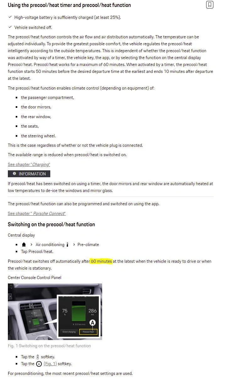

In the center console, click the battery button, there is a pre-cool/heat button. Good for 60 minutes.
Thanks! I thought that was to precool/heat the battery compartment to the optimum charging temperature - I didn't realize it was for the car interior.
Now I see it in Good-to-Know:
Correct. That button ONLY impacts the cabin climate control. The button being on the Battery page is especially confusing.
Unfortunately, there is no manual way to precondition the battery system on demand. The only way to precondition the battery is to navigate to a charger in the Nav system.
