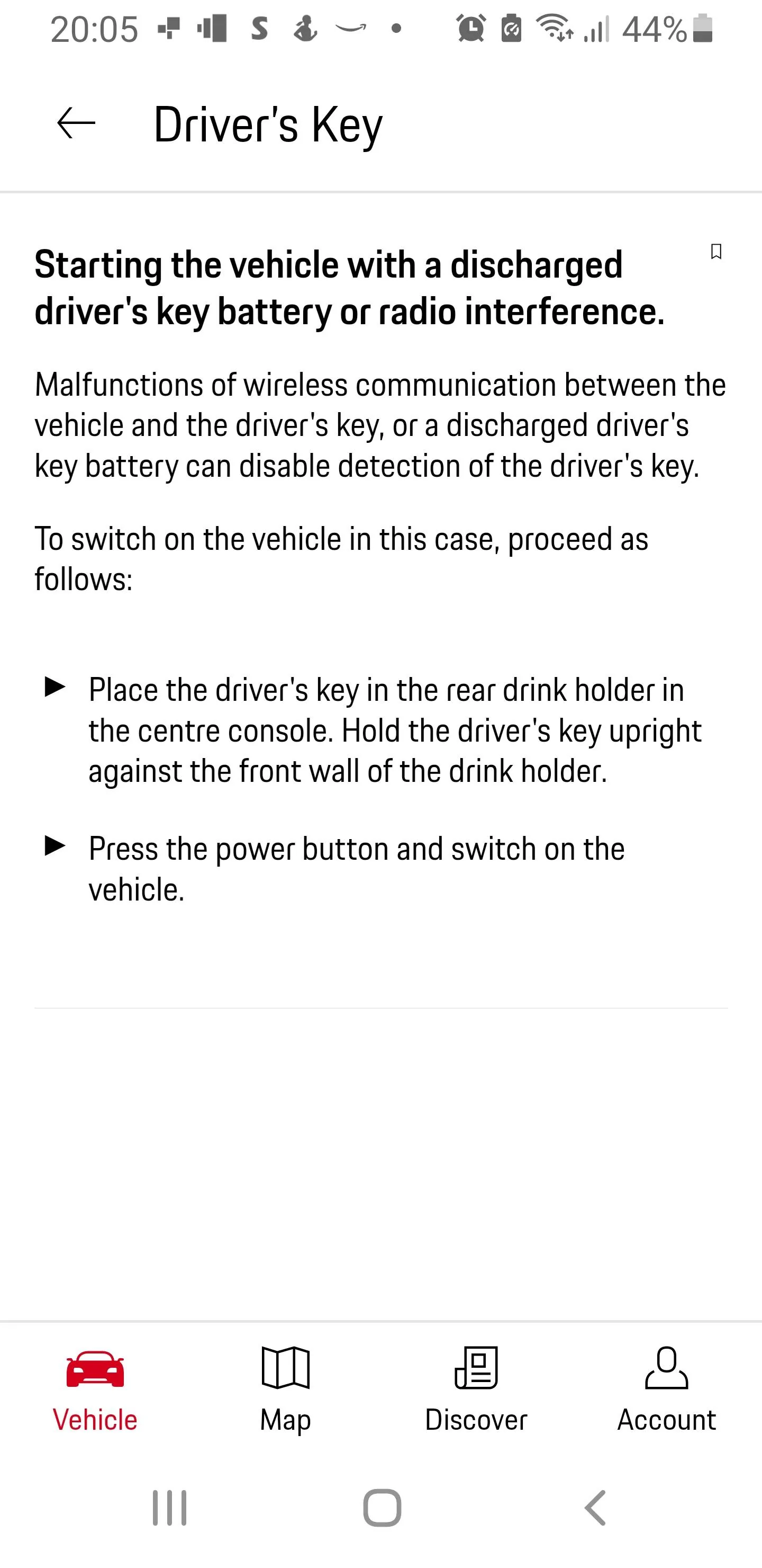

As per the manual. Transponder is located in the rearmost cupholder.
Key been in rear most cup holder for past 2 days now and still not gone! Does it genuinely say this in the manual ?
