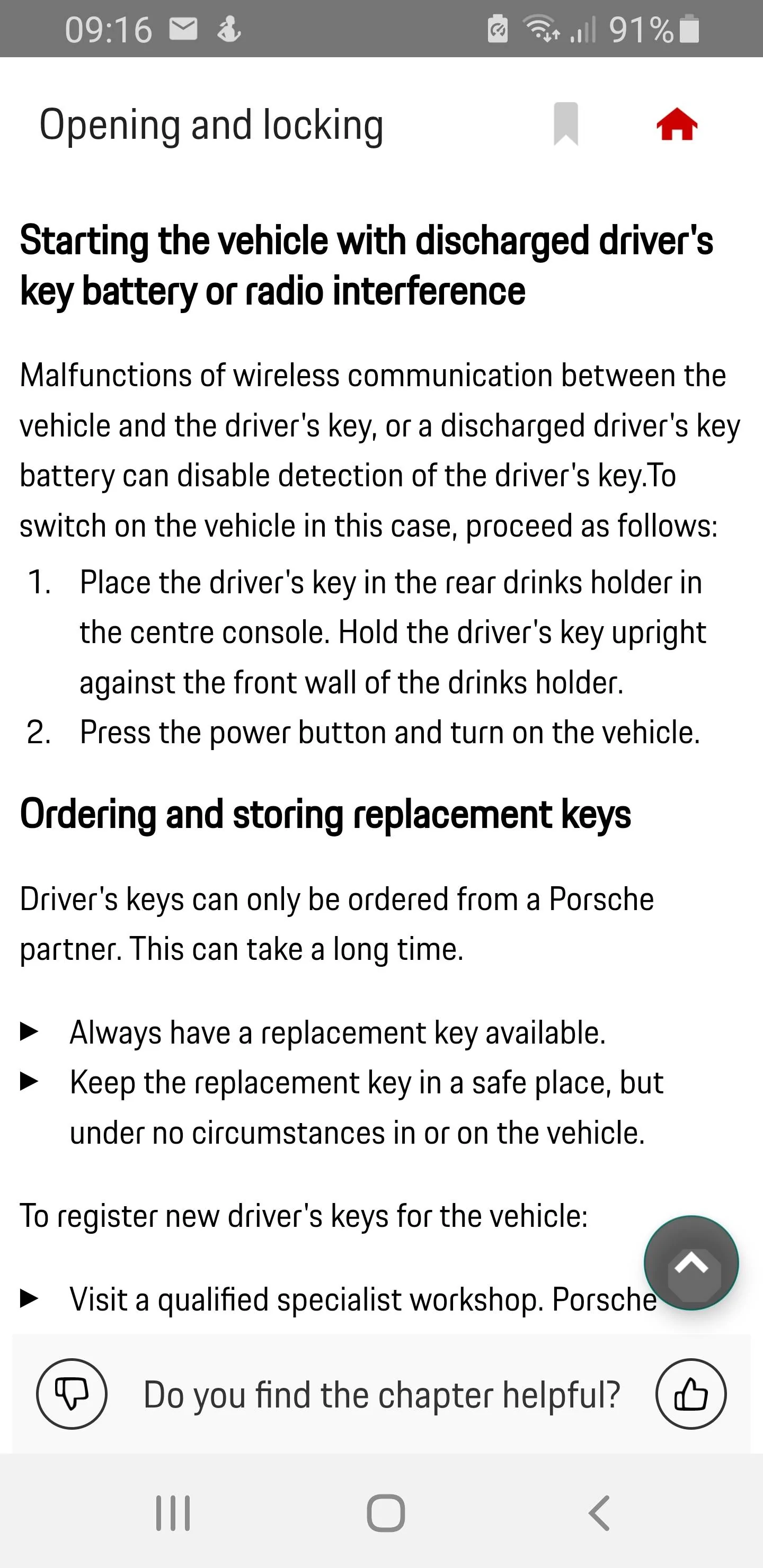

The transponder for the key is in the central armrest cupholder. Place in there to re-register.

Odd I've tried putting the key in the cup holder it seems to work on some occasions certainly not always! I thought I had solved it as I used to keep my spare garage opener and remote hotspot in the second cupholder and I thought things got better when I removed the electronics that it may be blocking the reception to the transponder. BUT no, again intermittently works and then it gives the no key in vehicle error. I am reticent to have to take the car in to service for them to sort this out. I am going to try the second key to see if that works normally ie keeping it in your pocket etc like I used to do with the key before. Otherwise it would mean a faulty key! Anyone have any other thoughts experienced same issue?

Porsche Taycan Key missing error in the car while driving Screenshot_20220902-091601_Porsche Good to know

When you say 2nd cupholder do you mean the one closest or furthest to the lower display?
