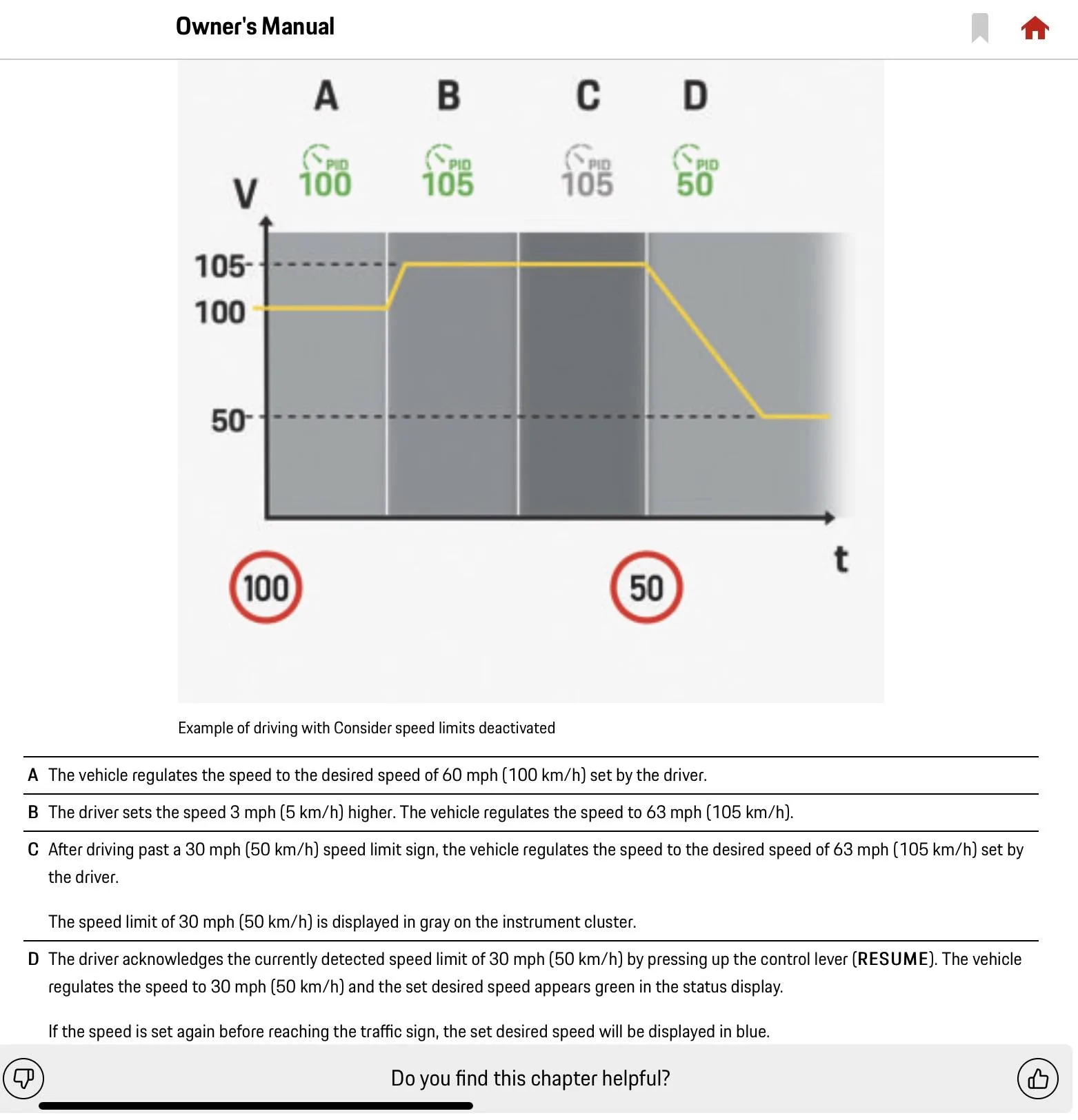

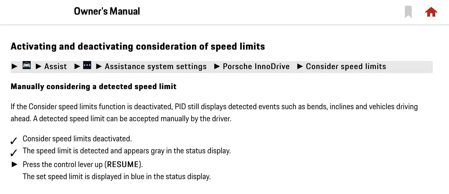

Hi @Eddie
I posted this elsewhere but thought you might find it as a helpful solution to your InnoDrive experience. As others have mentioned I think the issue is erroneous speed data in the database causing InnoDrive to unfortunately hit the breaks. This weekend I found a section in the manual that shows how you can deactivate InnoDrive's ability to react to speed changes. With this setting off you will be prompted with the speed change and you'll have to manually accept it by pushing the control lever up (RESUME). If you don't accept it your speed should stay the same. I'll be testing this tomorrow on a long drive, but theoretically it should fix the problem of phantom breaking. See below for how this plays out...
Porsche Taycan Latest Software Update IMG_0445
Porsche Taycan Latest Software Update IMG_0444
