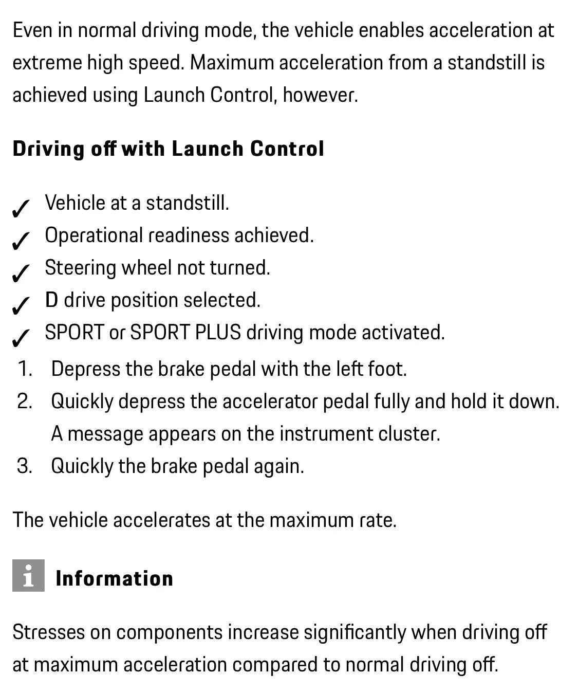

All this was done as listed?
Yup. Tried twice. And worked fine yesterday.
Not sure if I was doing something wrong today or if there is something else going on like needing min battery level.
will try again tomorrow :)
It’s possible there’s a battery temperature requirement. Any idea what your battery temperature was today at the time of “failure”?

"Operational readiness achieved"? That sounds like a bit of humor but that seems a bit out of character for Porsche?
Also "quickly the brake pedal again"?
Right. A little typoo there.
