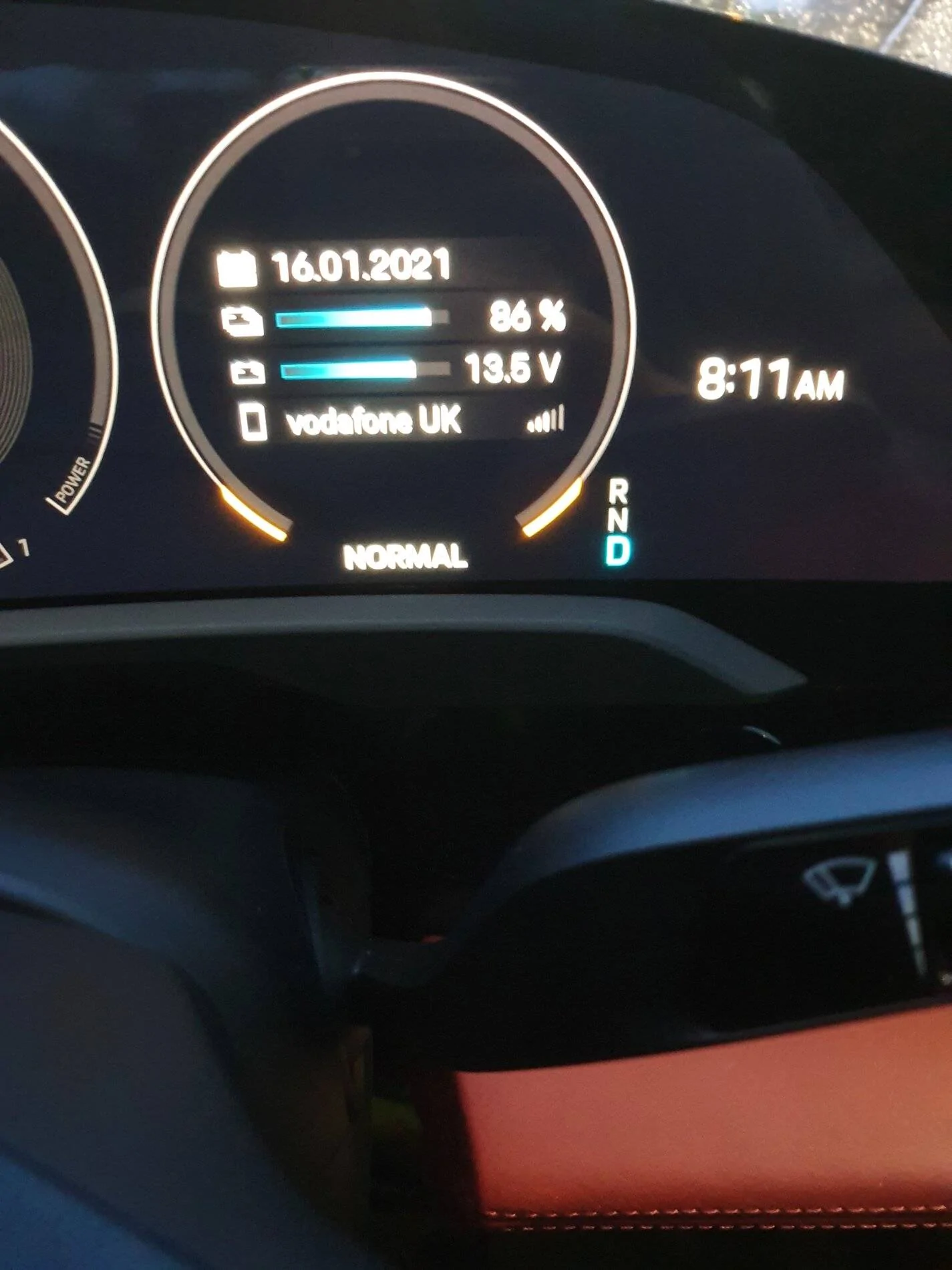

Zee
Sep 25, 2020
Manchester
Taycan4s
Where does it show temperature of the battery? On the forum I have seen it's on the right but mine doesnt show, unless their is a setting I have to change?
Dee
Dee
Dec 14, 2018
63
2,658
3,119
A lot
You can change the settings.
Settings > displays > display settings > instrument cluster > customized view.
