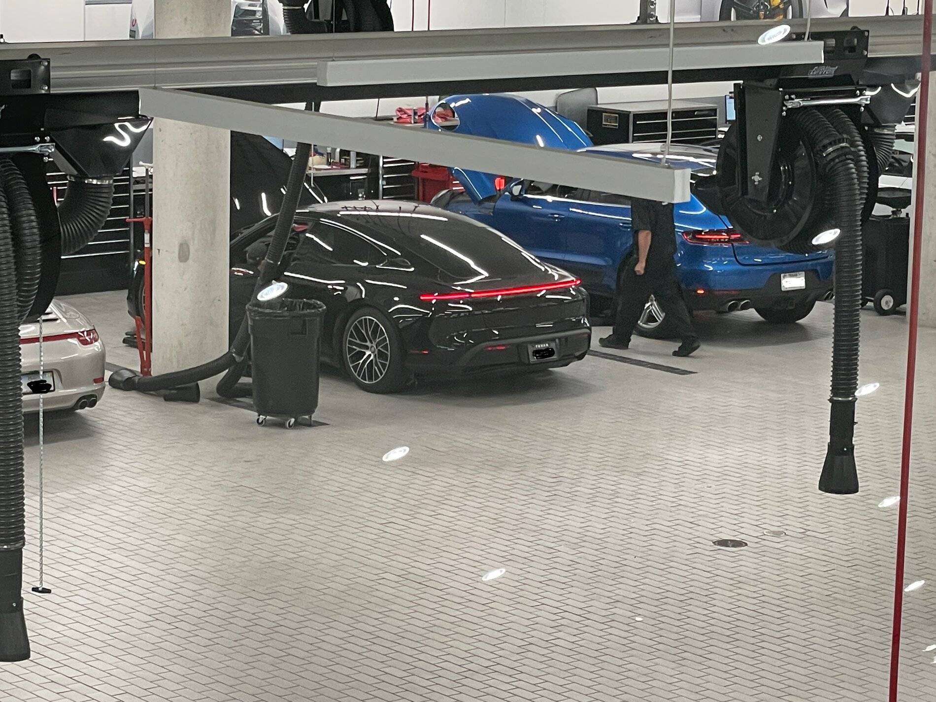

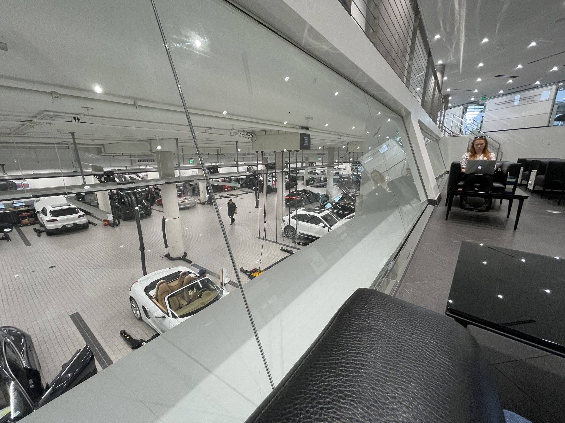

Just arrived at the dealership in Austin about 30 minutes ago. My 2021 Taycan 4S is currently in a service bay and I'm watching from the gallery. I'm hoping (against hope?) that the update will be completed in 2 hours or less.
UPDATE: The installation of the software update only took about 45 minutes. My Service Advisor said mine was the second AMB5 update installed by this dealership and the first (he couldn't remember the model type) took about 90 minutes.
I did notice on the drive home that the cruise control wasn't working, I couldn't set a speed to keep, but everything else that I tested seemed to work fine. I'll try the cruise control again later today or tomorrow after the car has sat for a while. And I also received a notice that my Navigation maps had been updated.

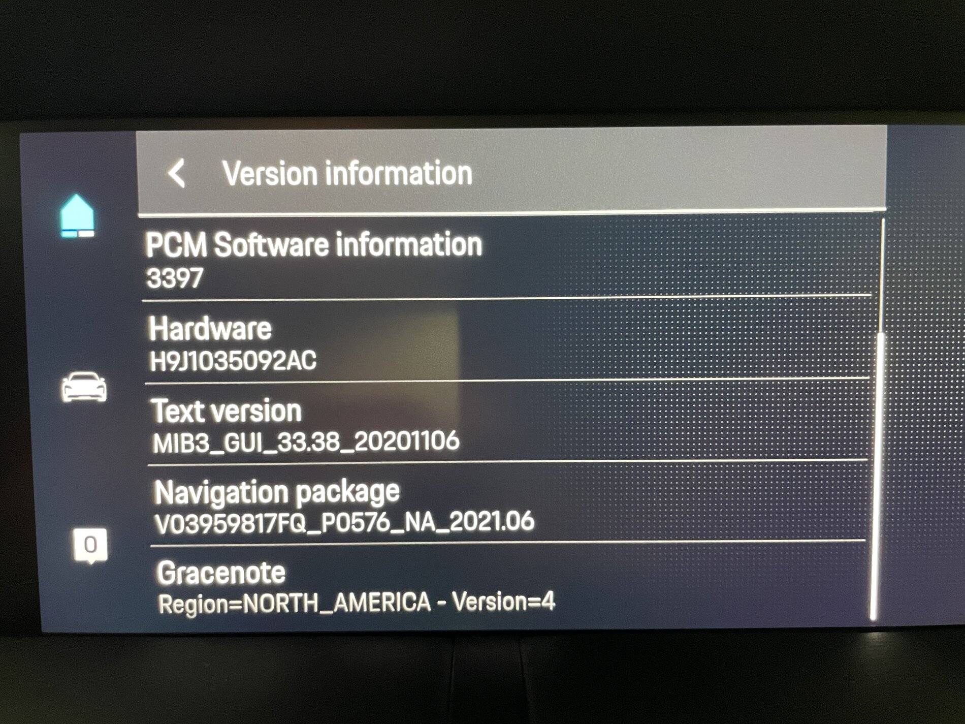

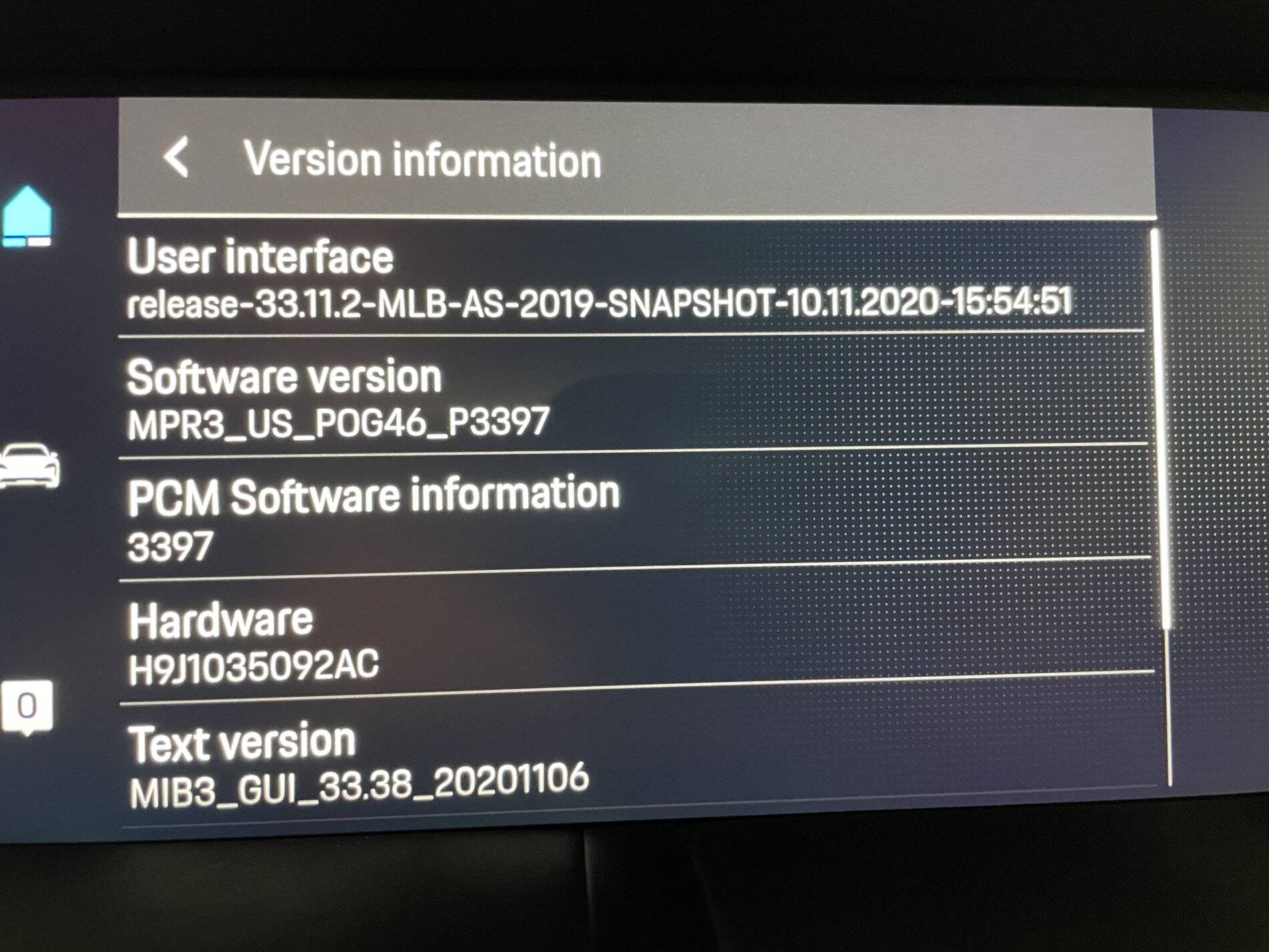

I've also added screenshots of the Version information screen from the PCM.
