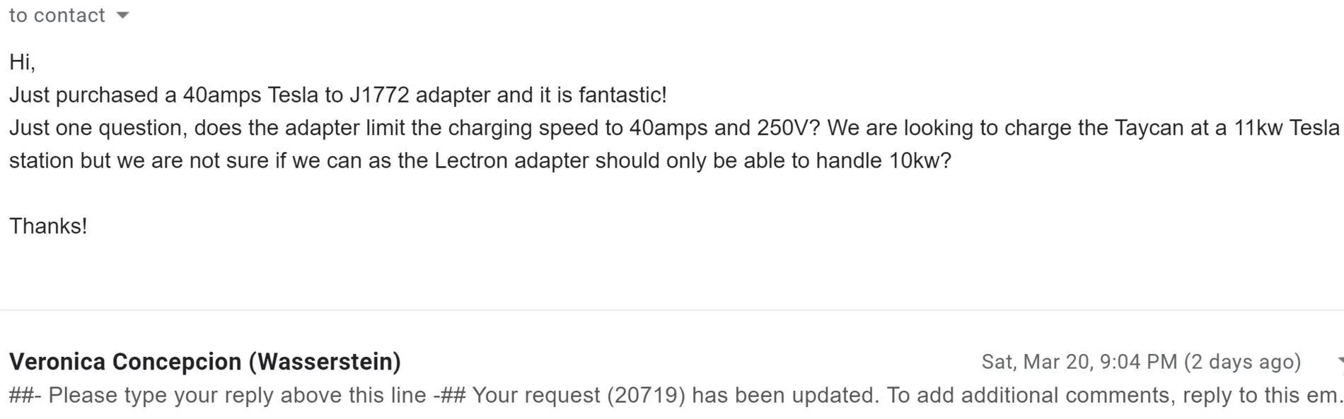

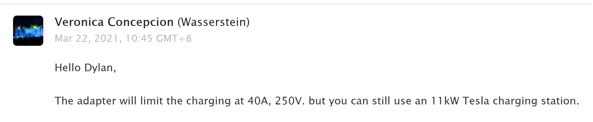

Just received an email from Lectron.
Seems like it is able to limit the charging, pretty interesting.
I just received an e-mail from Veronica stating the complete opposite. "It can still work with 48A, but we only recommend to use <= 40A"
So, there is likely no current limiting hardware in this device. Just wanted to post here to clear this up as there isn't much info on the internet about this Lectron adapter working @ 48A.
With that said, I plan to use mine on our 11kW ID.4 when the adapter arrives and I will post back with impressions. The cable on the adapter looks beefy (Nearly the same size as our 80A Tesla HPWC cable) and I wouldn't think would be an issue at first glance. Hopefully it doesn't get hot.
