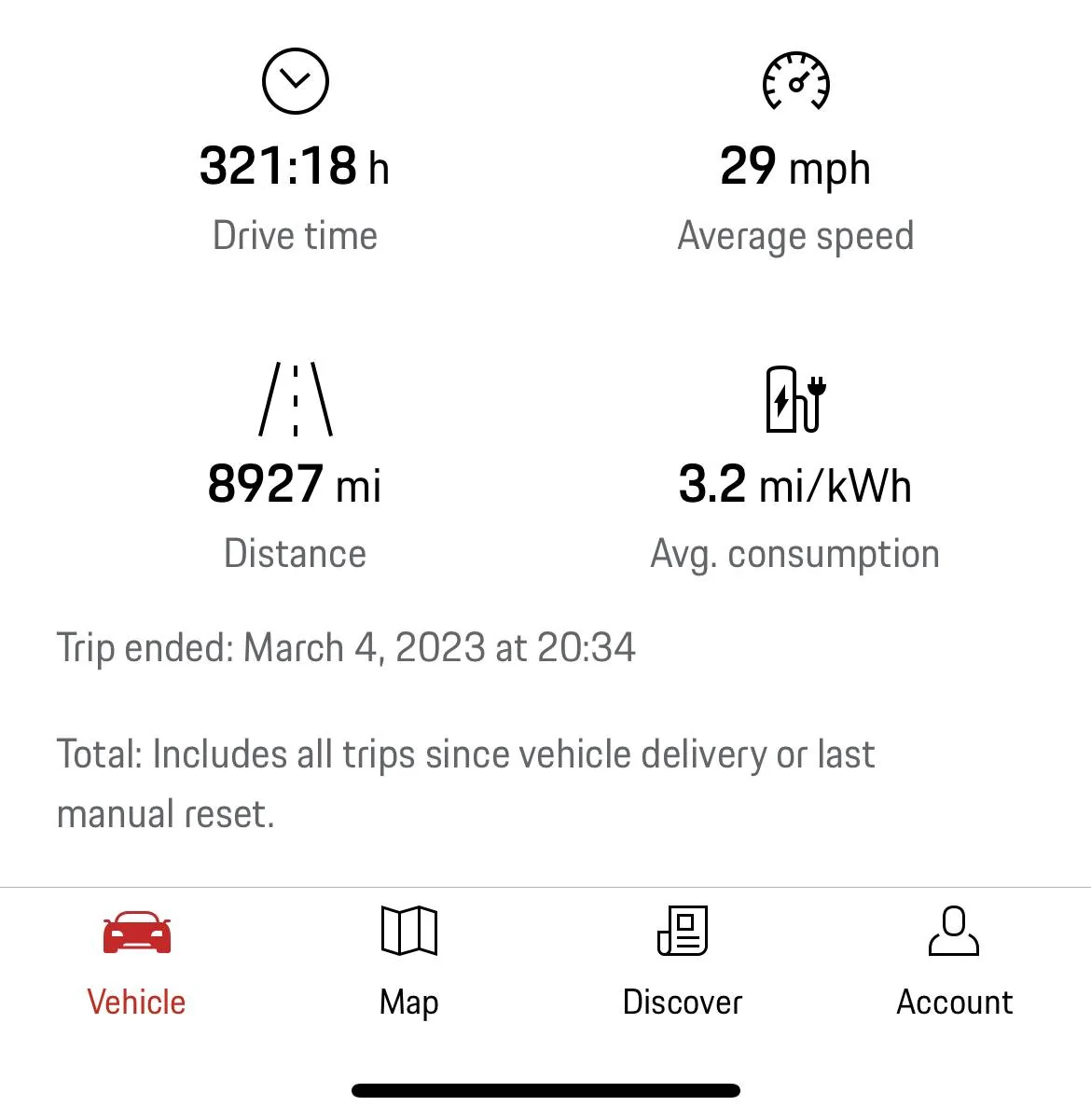

Hello
my overall consumption is 3.2 miles per kilowatt equal to 5.15km per kilowatt for the last 9,000 miles.
It is about 18.8 kilowatts per 100 kilometers. It should give me a 269 miles range (441 kilometers)
it sounds very good but when I fully charge the battery I got barely 225 miles.
I have the feeling this calculation is not accurate.
what are you numbers?

Currently at 58% and 143 miles, which suggests 243 mile range. This is about 20 miles above winter lows and 40-50 miles below summer highs.

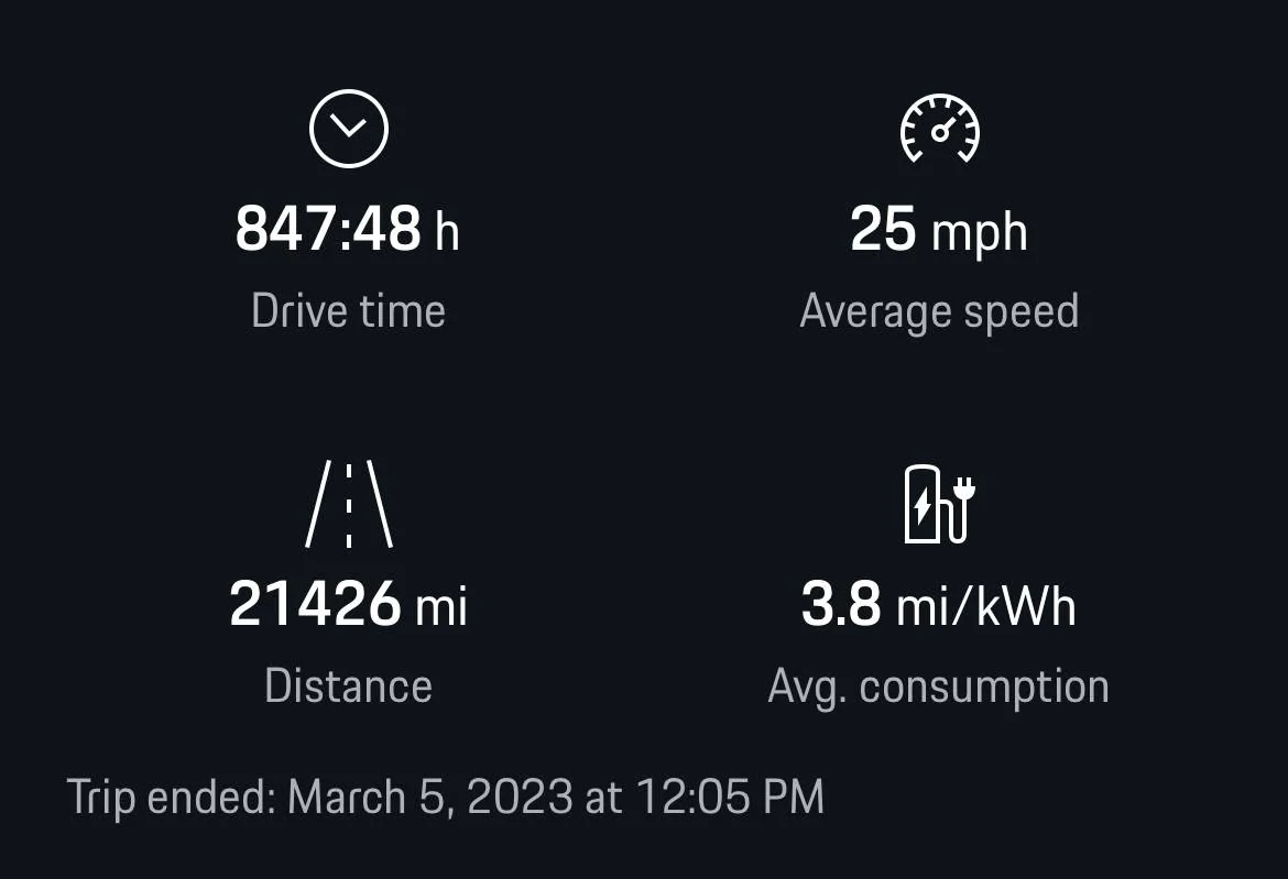

Mine is way off too. I average 2.4-2.7 miles/kWh. My long term number show 3.2 mi/kWh

They are not the same thing. The “all” number is what you should use. The guess o meter is based on you last trip. Has very little averaging.

259 miles (use the net battery capacity and not the gross).
In 20,545 miles I averaged 3.3 miles / kWh with my 4S.
