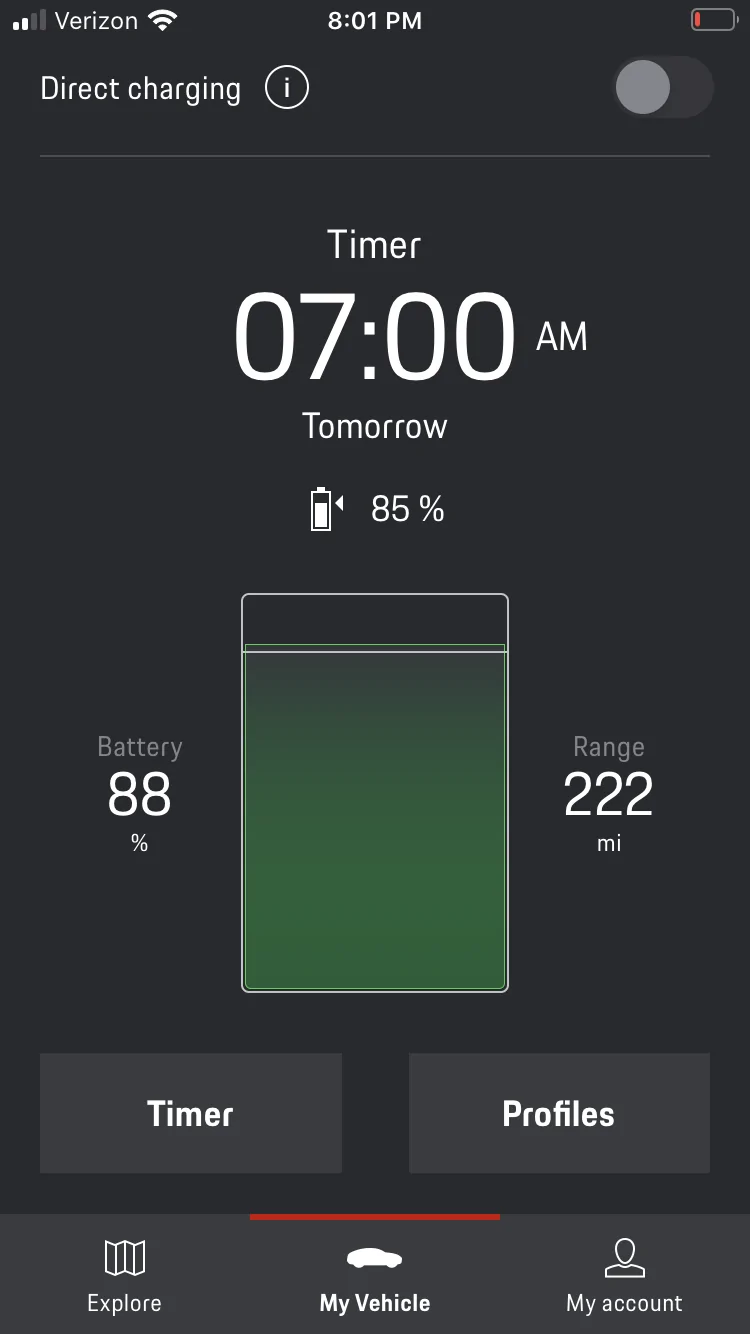

the recommend avoiding using the Porsche Connect app
Ha - I'm a bit OCD about checking the Connect app...so that will be a change for me. It's like my kids and snapchat. Also looks like I need to worry more about charging my phone than my car based on current app status screen...

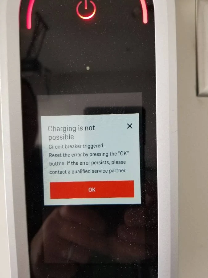

As I mentioned, 5 weeks ago I left my car plugged into the PMCC with a profile in place to maintain the charge at 85% SOC (I also have the 12v battery on a trickle charger). I log into the Porsche Connect app remotely about every 1 or 2 days. Since I have the car on the trickle charger, I don't worry about killing the 12v battery when I do things on the Porsche Connect app. 4 weeks ago when I logged into the Porsche Connect app, it said there was a charging error. I remotely accessed my security camera in the garage and saw that the lights on the charger were solid red (no charging). Not good. So the high voltage batteries were not charged for the last 4 weeks. Yesterday when I got back to town, I checked the PMCC and also checked the car to see its current SOC.
The SOC was 80% so the car lost 5% over 4 weeks. I think that is fairly low for battery charge loss. As far as the Charging Error, the message on the PMCC panel said the circuit breaker tripped. I was a bit confused at first because I had purposely reduced the charging amps from 40A to 24A when I left 5 weeks ago. When I checked the electrical panel the breaker was not tripped. When I got inside the house, I noticed the microwave said PF (power failure), so it looks like the house lost power during a storm and the PMCC thought the breaker tripped. Once I rebooted the PMCC, everything was back to normal.

4 weeks ago when I logged into the Porsche Connect app, it said there was a charging error . . . Yesterday when I got back to town, I checked the PMCC . . . the message on the PMCC panel said the circuit breaker tripped.
Is it possible to read the PMCC display error message remotely, using the technician mode of the web interface?
@elberk said: "Additionally it looks there are two user roles defined in the web interface, a normal user and a technician mode. Technician mode lets you configure a lot more things of the charger it looks like."
https://www.taycanforum.com/forum/threads/web-interface-for-porsche-connect-charger.1768/post-23014
