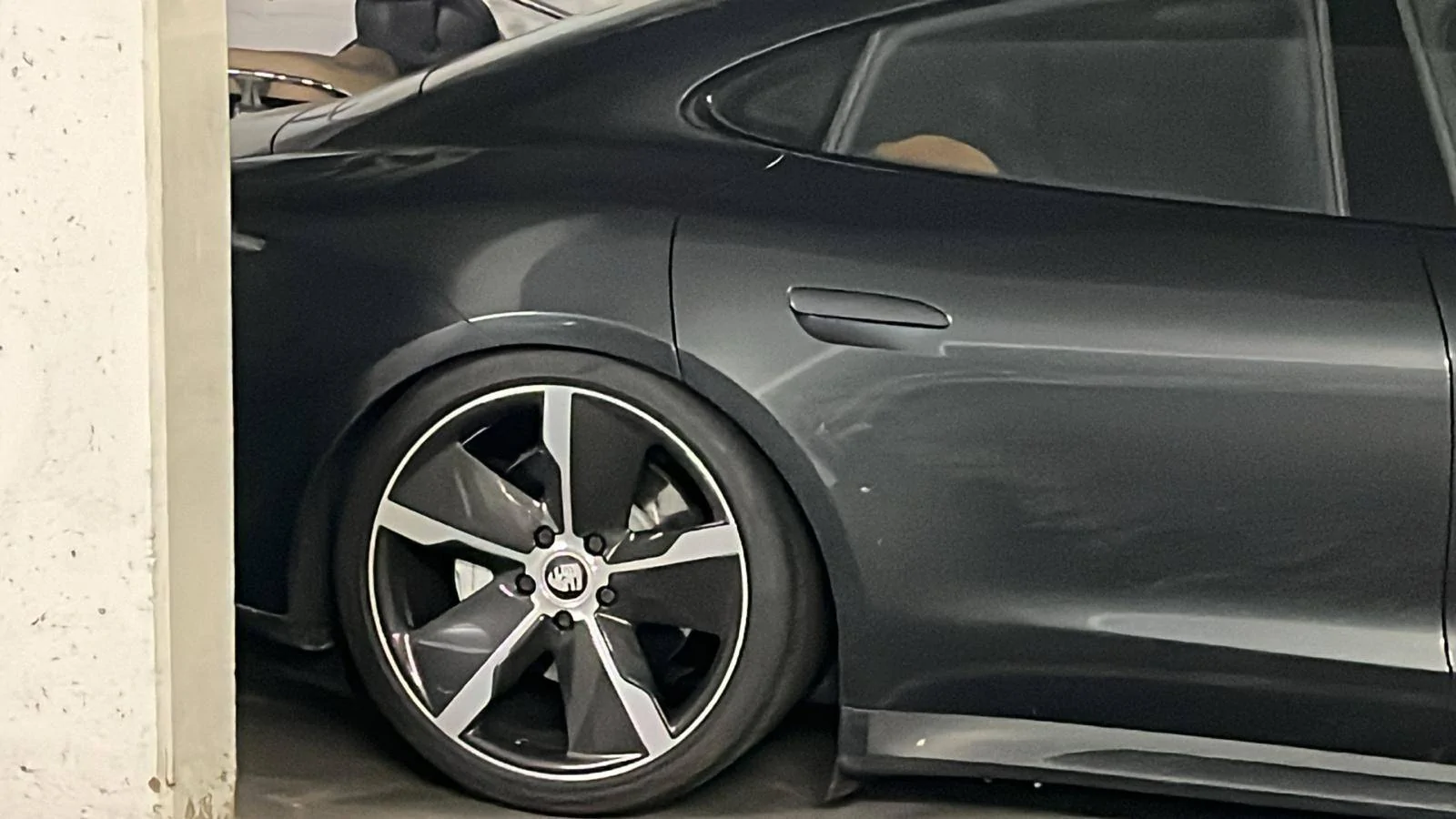

car parks completly uneven/unaligned. rear right in my case.
could not find any TSB oder experience here with search function... I am glad I have approved, looks expensive for me.
sorry for the bad pic and no glossy parking :)

Oh that does not look promising.
I would also check the Porsche Approved Waranty conditions. I have a bad feeling that shock absorber is not covered by the warranty?
Does the air suspension work, and only while parked the car drops after some time?

At least you know your sensors and compressor is fine. Since the other wheels are not going down, it's probably just an air leak in that one. Sounds like time to visit your favorite Porsche mechanic.

yes, I try to sync the visit and repair time with my vacation in August. It sees it takes ~3+ days to leak the one suspension entirely.
