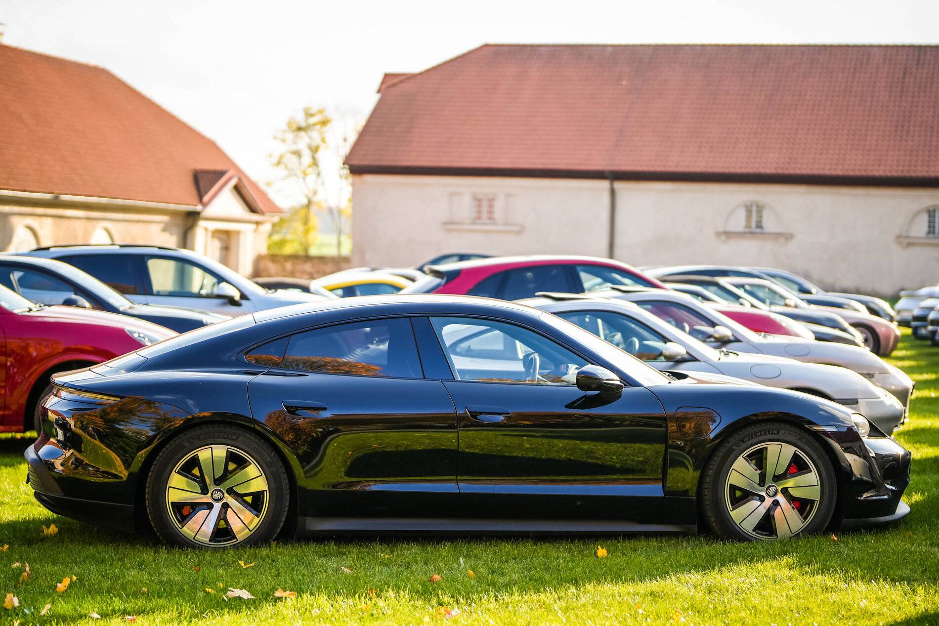

Jancha
Janis
Oct 1, 2020
184
204
Latvia
911 Cabrio (ex Taycan 4s+)
Stays nice and low :)
Porsche Taycan Lowered chassis when parked 12B94F56-9116-48F5-B43D-47983AF95B76

Good point - I was referencing my CT4S vs the sedan - the lowered position on the Sedan of course noticeably lower than equivalent position on the CT. That said the chap I visited with in Houston had Vivid links on his Taycan Turbo S and it looked super sharp.

the CT does not get as low as the sedan? I had no clue
