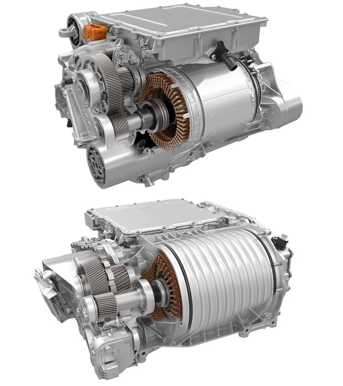

I know its a question that's been asked here, but I spotted this on the Macan EV configurator:
Porsche Taycan Macan EV appears to have single speed transmission, unlike Taycan 1706194702609

I'm confused.
Does a two-stage single-speed transmission of the Macan do the same as a double-clutch two-speed transmission like the Taycan?
No. The Macan is just a single speed gearbox. The two stage refers to the reduction happening through two gear sets. It’s reduced once and then a common shaft goes to another gear set to reduce again.

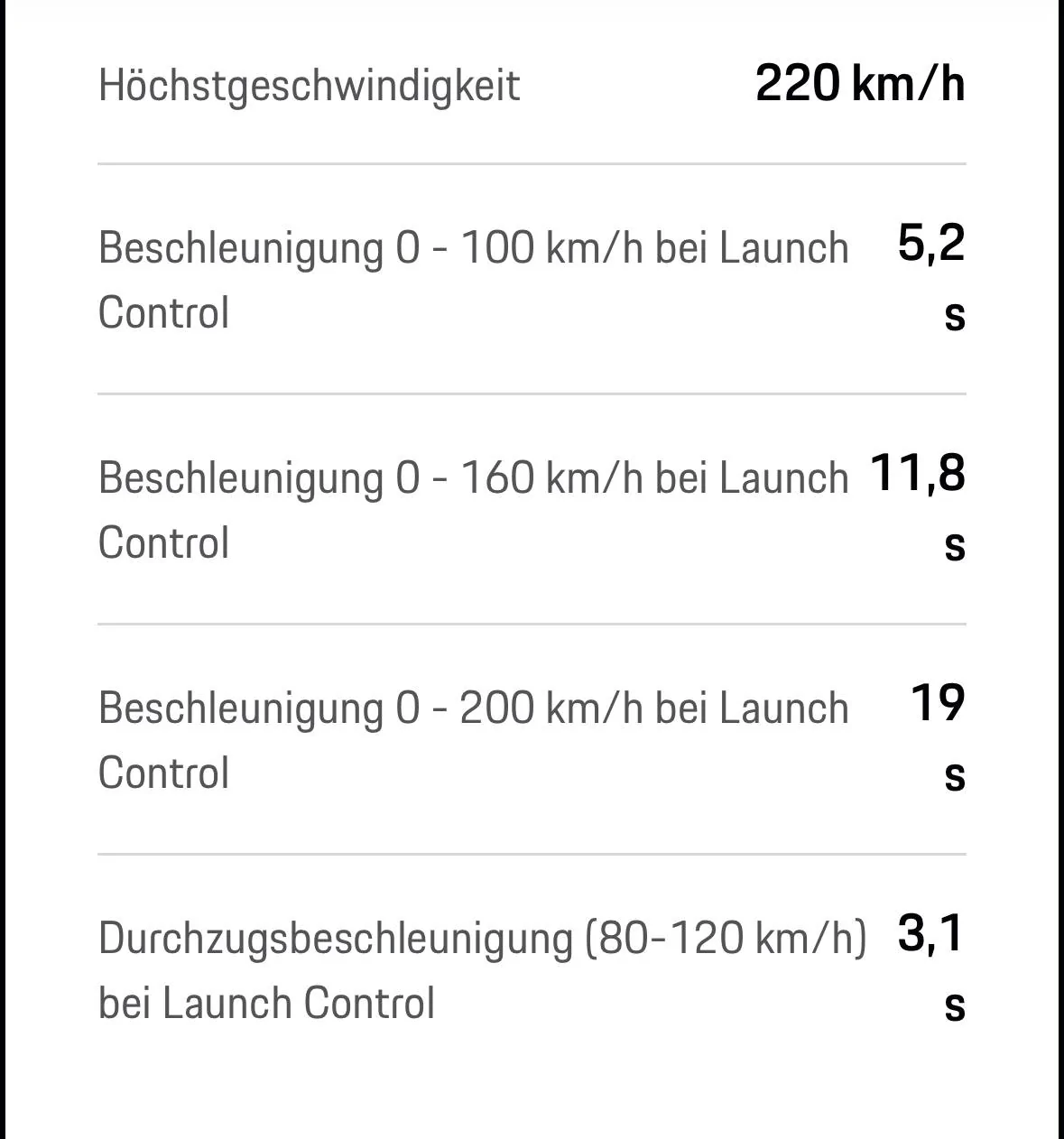

Yes single speed and with the 2-speed transmission also gone is the acceleration linearity. Macan 4 has almost the same 0-100 acceleration with Taycan 4 CT but its 100-200 is 13.8 sec almost 40% slower than CT! No info on gear ratio yet but macan’s single gear is very likely shorter than Taycan’s second gear and running out of stamina at high speed, just like teslas.
