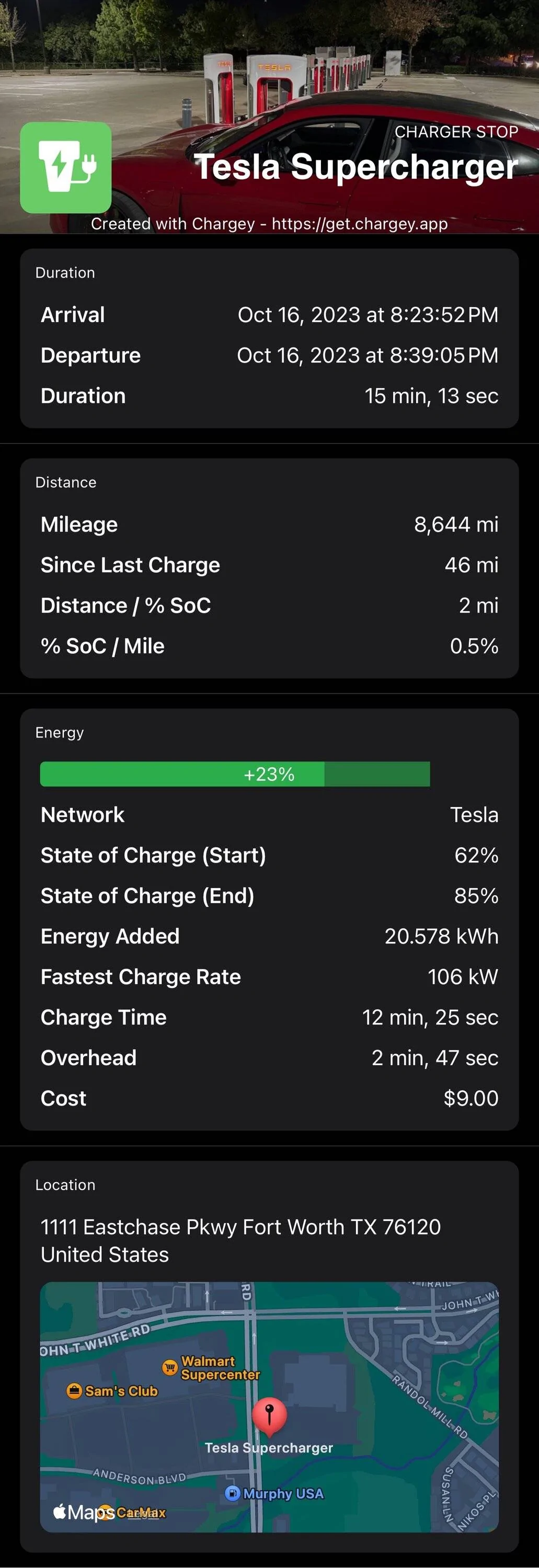

After My experience yesterday where a piece of plastic in my charge port prevented charging, I decided I owed the Magic Dock another try.
I decided to go back out to Fort Worth after work - this time with a healthy SoC to get me anywhere (including back home) if needed.
I specifically used the exact same stall I attempted yesterday.
I have to say I came away extremely impressed.
It. Worked. Flawlessly.
Managing the app and starting the charge was simple.
The dock was easy to handle.
Even the charging itself started faster, ran quieter and with less drama than an EA charge.
If I were road tripping, I would rather pay for these Superchargers than use EA's for free.
That being said, there -are- a couple things that could be improved.
  1. The cables are very short. I was able to use a trailer pull-through spot that worked perfectly, but if that wasn't there I would have had to straddle two spots to make it reach.
  2. Porsche's GPS seems to have no knowledge of these chargers, so I wasn't able to precondition the battery. My SoC was too high for a full-speed charge anyway so it wasn't a deal breaker, and I still got 106kW proving my 150kW/400V upgrade is working.
this mirror's my experience with both EA and MagicDock Tesla Superchargers…sorry for your original troubles, but glad you got it resolved - the pre-conditioning thing is an issue…
the fastest charge I've gotten with a Tesla Magicdock is 142 kW…but it settles into 132-136 kW for the majority of the session at my local supercharger (Scotts Valley, CA)

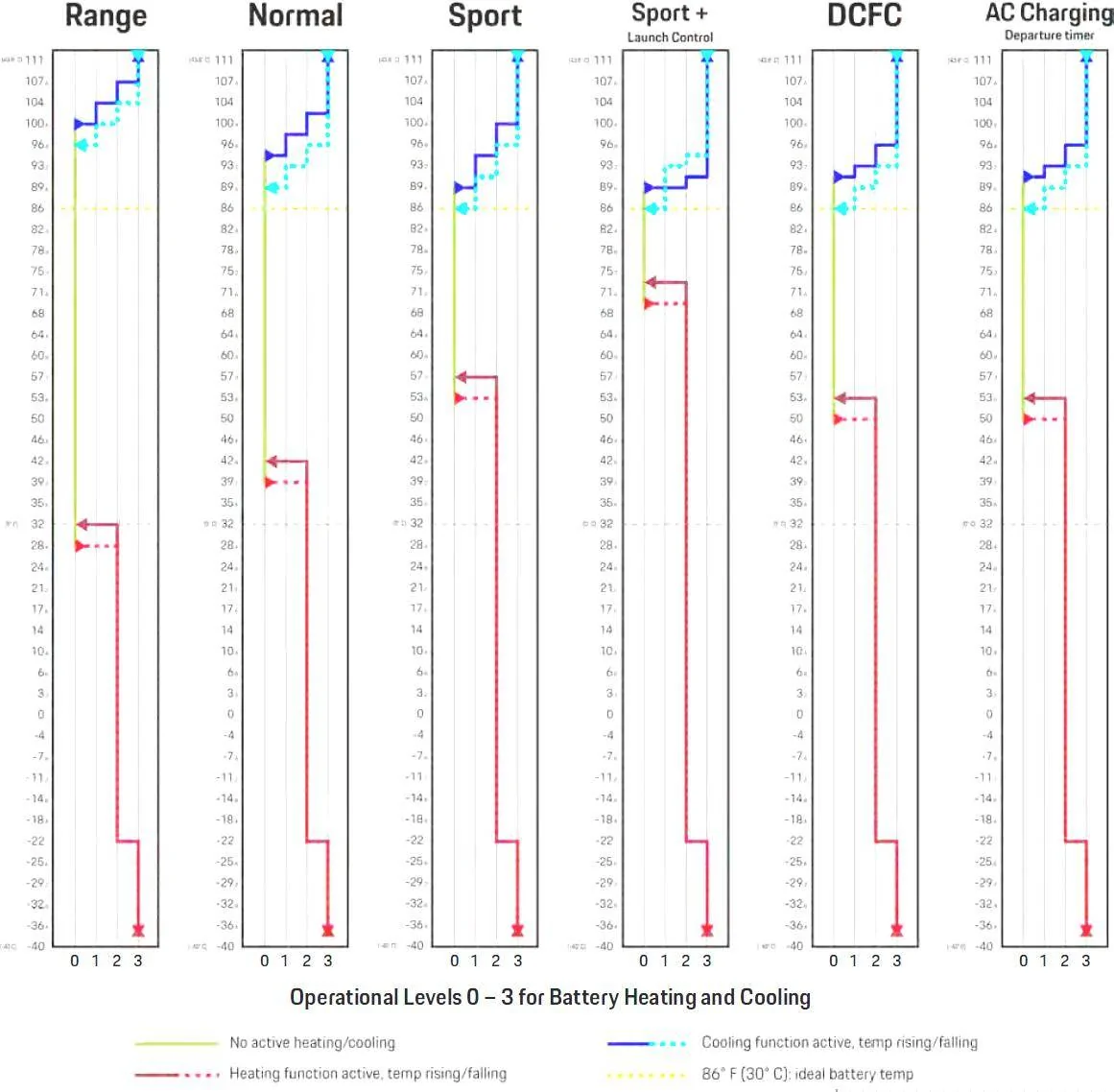

Remember you can say ‘Hey Porsche, preheat the battery’ - one option if you know you’re headed to a SC not in the Nav.
To what temperature does your car preheat the battery when you give this command?
Sorry, don’t know - only had my GTS for 2 days, but I tried this on a loaner - not because I needed to DCFC, but I borrowed it to test my home EVSE before delivery of my GTS and the dealer gave the loaner to me with 100% SoC, so was thinking of ways to drain the battery a bit before I got home!
How did you know the battery was being preheated? What indication did you have that it was? Preheat in PCM vernacular refers to cabin/battery pre-conditioning timer, so are you sure it didn't just turn on pre-conditioning or maybe setup a timer for you?
When you give that command, the lady replies 'The Battery will be warm soon'.
Temperature did increase on the HV battery to around 34 degrees (c).
Interesting. I will give it a try next time I travel using non-Porsche navigation. I've been using Sport+ which has a similar battery thermal profile to DCFC. I wonder if battery pre-heat actually heated it up to 34C (which is the point where battery cooling for fast charging kicks in) or did it just let the battery get there (no active heating above ~12C while DC charging.
