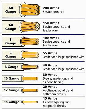

apologies - my corrections to your quote above in purple
the speed or "rate" of charge is measured in kW (kilowatts) not kWh (kilowatt-hours) - the Taycan's standard onboard charger (L2 AC/DC converter) is capable of charging at a rate of 11 kW - if you charge at that rate for 1 hour you will be billed by your electric company for 11 kWh of power - if you charge at this rate for 1/2 an hour - you will be billed for 5.5 kWh from your power company.
kWh = rate of charge (kW) * time (hours or fractions of hours)
1 kW * 2 hours = 2 kWh (microwave running for 2 hours)
9.6 kW * 4 hours = 38.4 kWh (running the Porsche PMCC for 4 hours on a NEMA 14-50 plug)
Porsche offers an optional 19.2 kW charger from the factory. Adding this onboard charger to your build will allow the Taycan to charge at a maximum rate of 19.2 kW _IF_ you encounter a rare 100/80 amp L2 EV charger (or install one in your home). Charging at this rate for 1 hour will yield 19.2 kWh billed on your power bill from your electric company.
watts = volts * amps
  • 9.6 kW is 240 volts * 40 amps (240 * 40 = 9,600 watts or 9.6 kW) - 50 amp breaker required
  • 11 kW is 240 volts * 48 amp (240 * 48 = 11,520 watts or 11.52 kW) - 60 amp breaker required
  • 19.2 kW is 240 volts * 80 amps (240 * 80 = 19,200 watts or 19.2 kW) - 100 amp breaker required
to charge at those rates you have to increase the breaker size (as noted in orange) & wire gauge by 25% from the charge rate (48 amps requires 60 amp breaker and wire for building code safety, etc…)
if you charge your Taycan for 1 hour @ 9.6 kW (kilowatts) - you have delivered 9.6 kWh (kilowatt hours) to the vehicle - slightly less to the battery due to AC/DC conversion losses, charging losses, heat, and overhead…
according to in car display my Taycan charges the battery at about 8.86 kW from my 9.6 kW charger - so in one hour of charging @ 9.6 kW - I will add 8.86 kWh to the battery for driving - but I will be billed by PG&E for 9.6 kWh @ $0.1456/kWh - or $1.39 for one hour of charging my Taycan.
  • 40 amp charge rate requires a 50 amp breaker & appropriate wire gauge for 50 amps of AC 240 volt current - 8 or 6 gauge write according to table below
  • 48 amp charge rate requires a 60 amp breaker & appropriate wire gauge for 60 amps of AC 240 volt current - 6 or 4 gauge wire according to the table below
  • 80 amp charge rate requires a 100 amp breaker & appropriate wire gauge for 100 amps of AC 240 volt current - 3 gauge wire according to the table below
Porsche Taycan Malfunctioning Charge Port ar13634460999293
the "upsized" breaker and wire is because EVSE's (EV chargers) are considered "continuous use appliance" (any appliance that can use "max rated power" for 2 hours or more with no pause) - so to avoid the wire failing and overheating you can only run them at 80% of the rated load for wire/breaker…
the 19.2 kW option requires that you "option" the 19.2 kW charger when you build the Taycan - and it then requires you to install/provide a 100 amp EVSE to take advantage of the 19.2 kW charger you paid for - ClipperCreek makes an 100 amp EVSE - ClipperCreek CS-100 - and then you need an appropriate circuit installed by your electrician to run the CS-100 - and then and only then will you charge at 19.2 kW.
