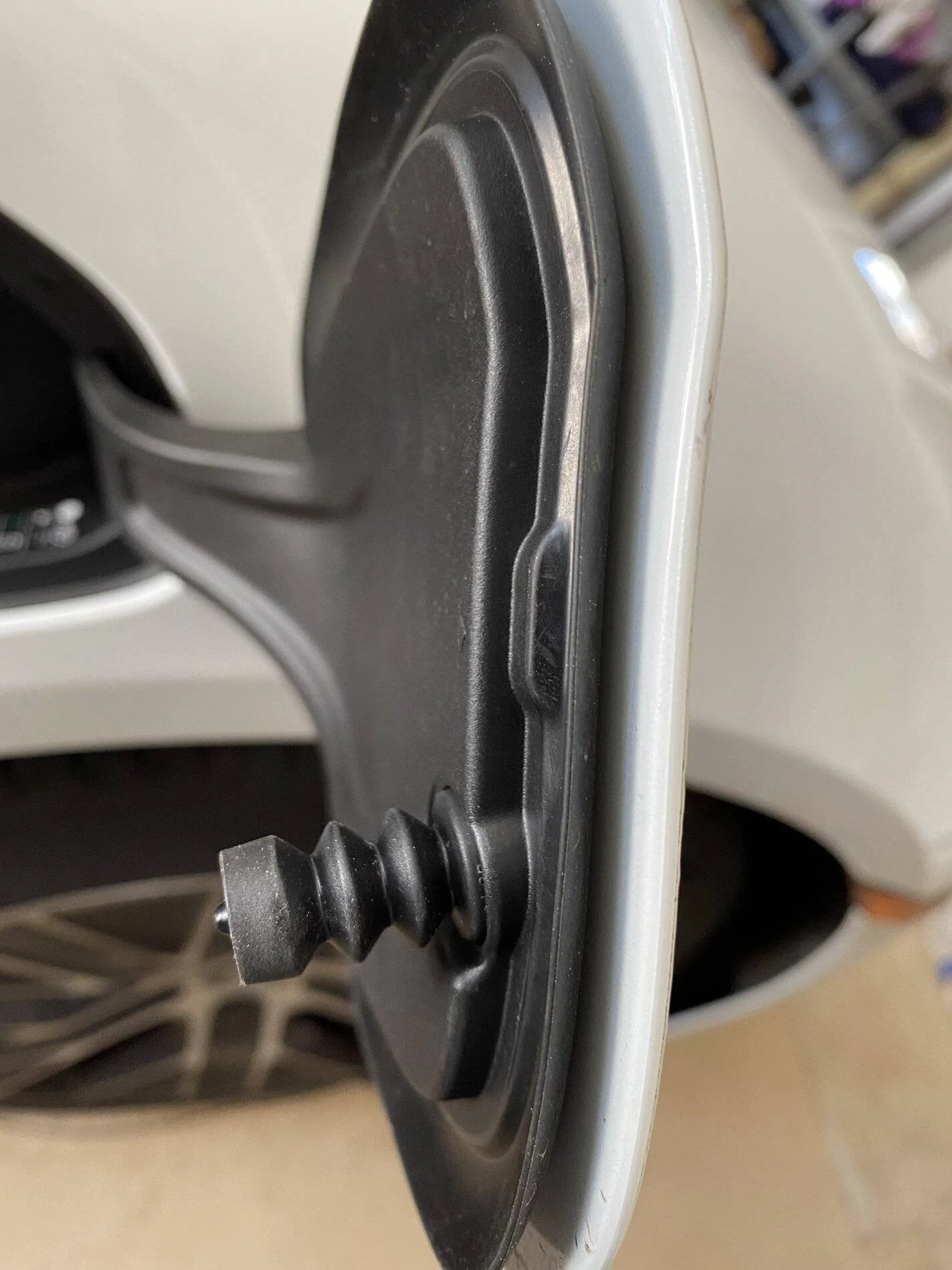

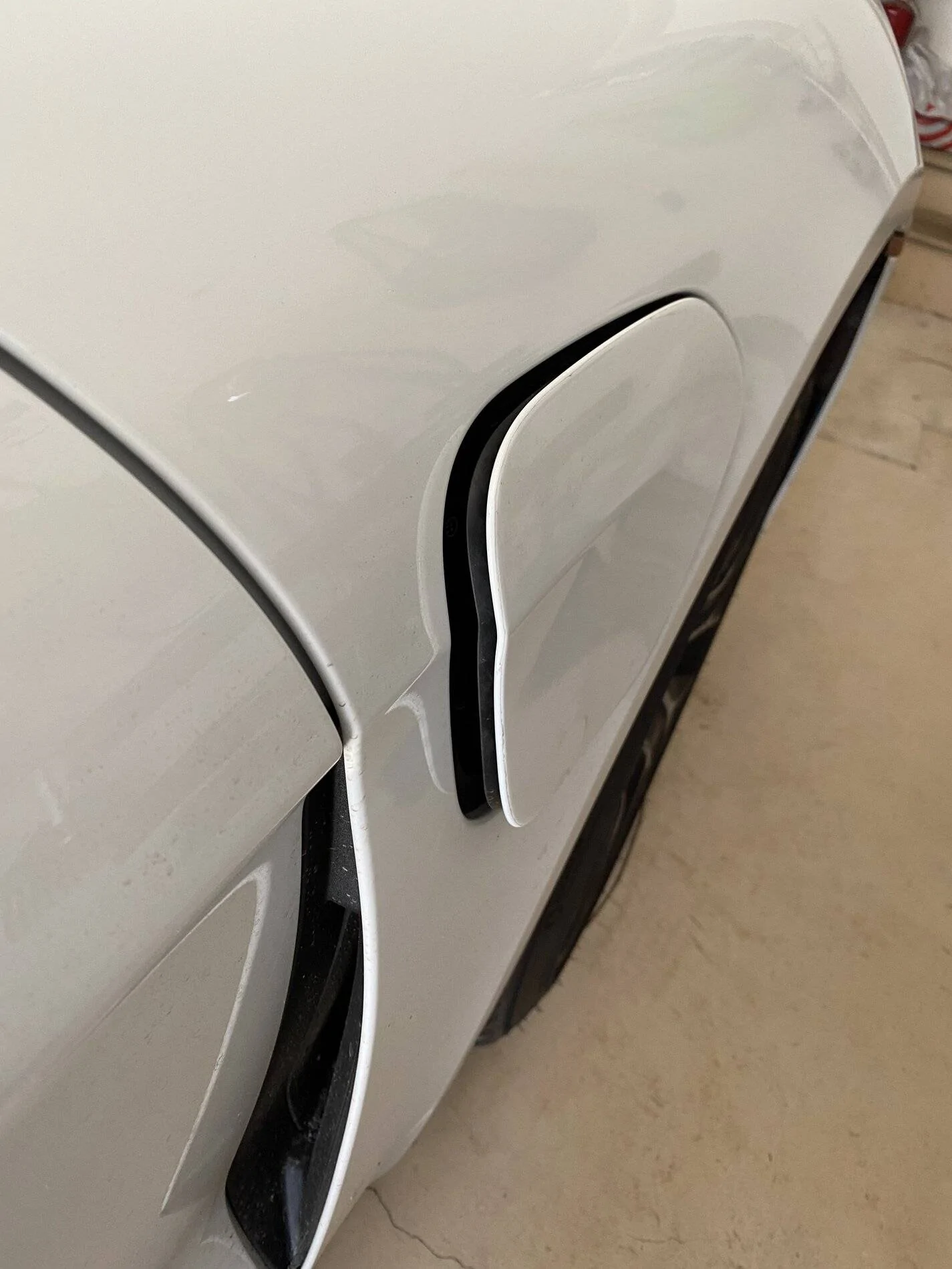

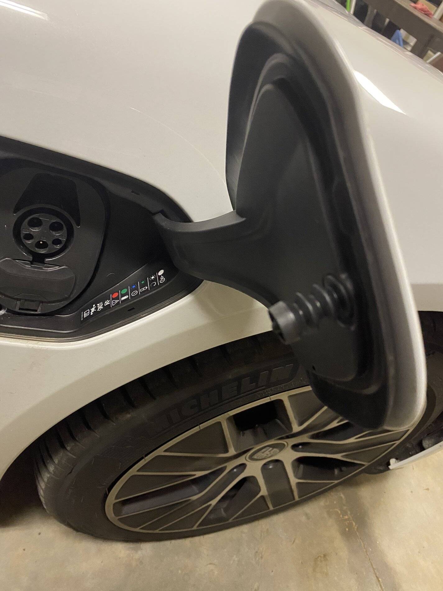

After removing my garage charge cable from my 4S, I am unable to fully close the (manual) door. It feels as if the latch lock mechanism is locked and prohibits the locking tab from being inserted, resulting in the door closing all but ~1/2".
Dealer says bring it by and they'll look for an issue or order parts. Seems like a logic issue - car thinks manual charging cover is supposed to be locked even though it is not closed.
And yes, I tried locking and unlocking the car. Even started, locked, unlocked, re-locked. Anyone seen this before or got any ideas?

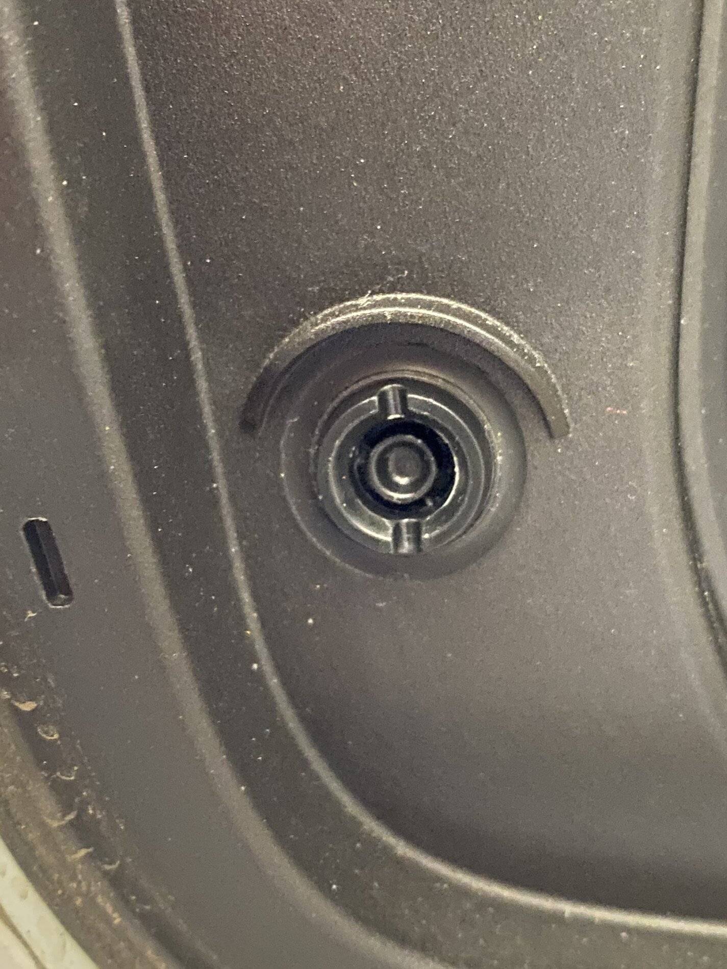

1) Pin receptor is not "easily" persuaded with a small screwdriver

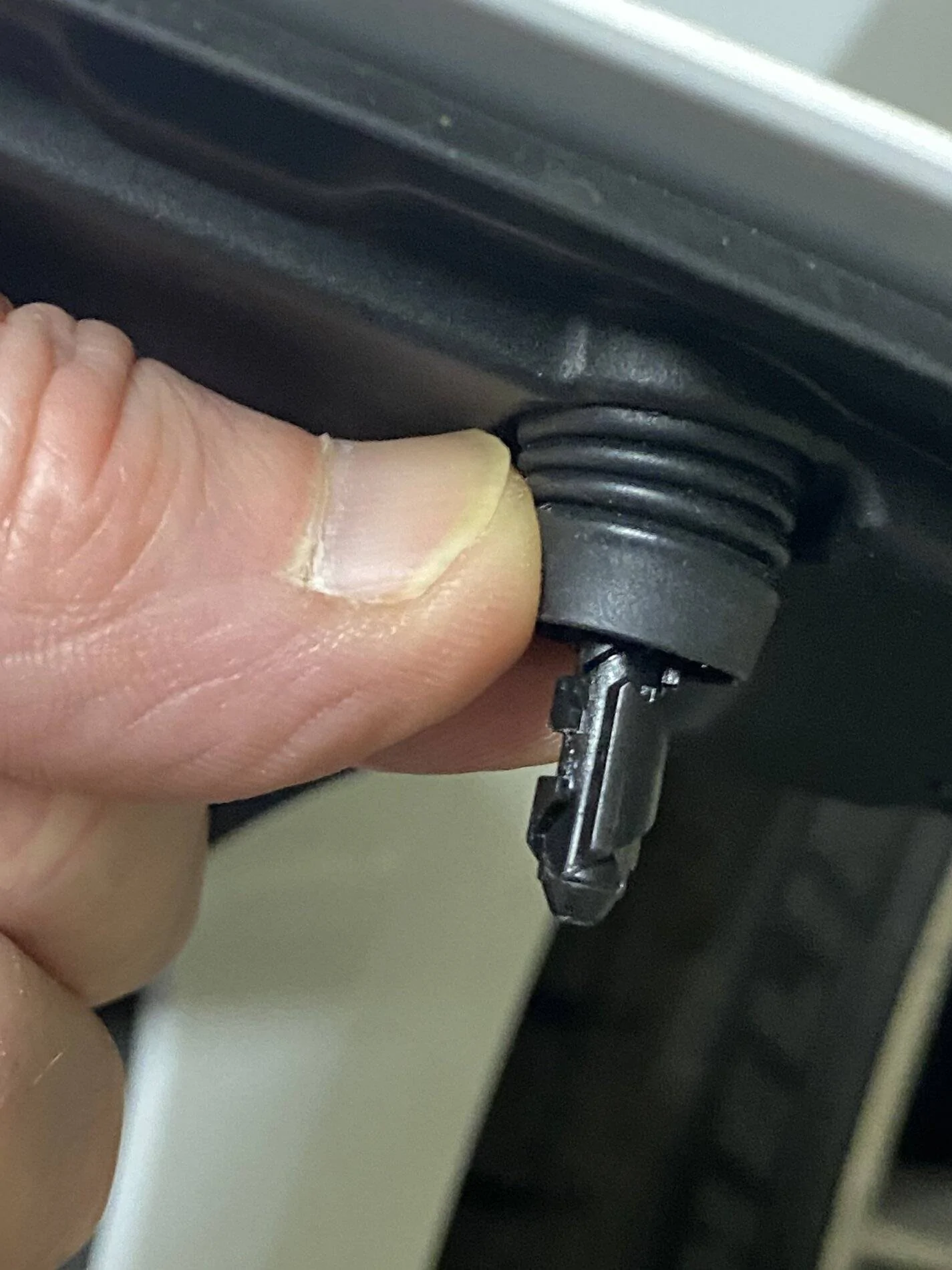

The dealer took it into the shop and returned saying the plastic latching pin was bent. They say they bent it back and ordered a new door (the e black part - white body panel transfers) since the pin cannot be replaced without replacing the entire door (really Porsche?)
How did it get bent?
Well, I'm the only one that charges the car, so I must have done it, BUT if I did, any contact was incidental. Maybe the charging cable grazed it when I connected or disconnected the charger and I didn't notice? If so, it's disappointing that you can break the latch without even being aware there is contact.
To me, the pin looks the same in the "after repair" picture (below) as it did in the "before repair" pic (above.) When I peel back the rubber sheathing, it's just a long, thin plastic pin. IMHO if it's prone to getting bent with minor contact, the design should be upgraded.
Guess the lesson is to be EXTRA CAREFUL when connecting the charging cable to not touch the charging door pin... UGH.

FWIW, I found out the hard way just how poorly attached these pins are today when my 2 year old pulled the rubber boot and pin completely off my car. It took me 10 minutes of fumbling to figure out the the boot is basically all that keeps the pins from falling off the charge port doors.
