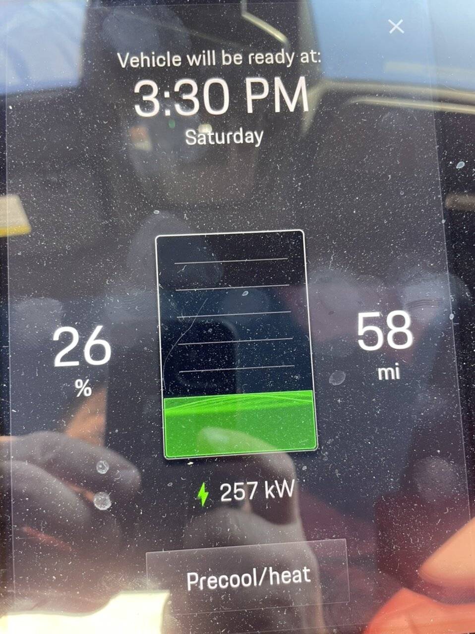

I totally agree that a preconditioned battery and low SOC are necessary to get the super fast charging rates. Today was one of those great sessions. I hit 260kW and was still above 200kW at 55% SOC. I was at the same station the day before and peaked at 158kW (no preconditioning).
I had a similar experience this weekend. I hit 257kW at a low SOC and I had the battery pre-conditioned on arrival (I had set the charger as the destination in the Nav).
