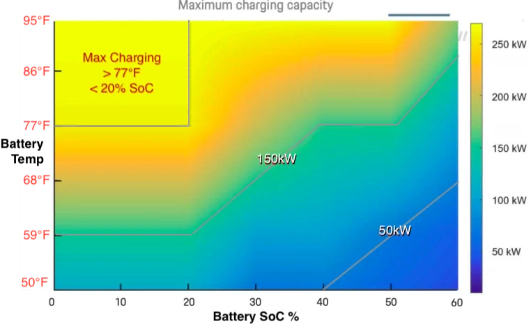

Charging has so many factors. Mainly your starting state of charge and battery temperature. If you want the super ionity numbers your battery needs to be under 20% SoC and 30 degrees Celsius and up.

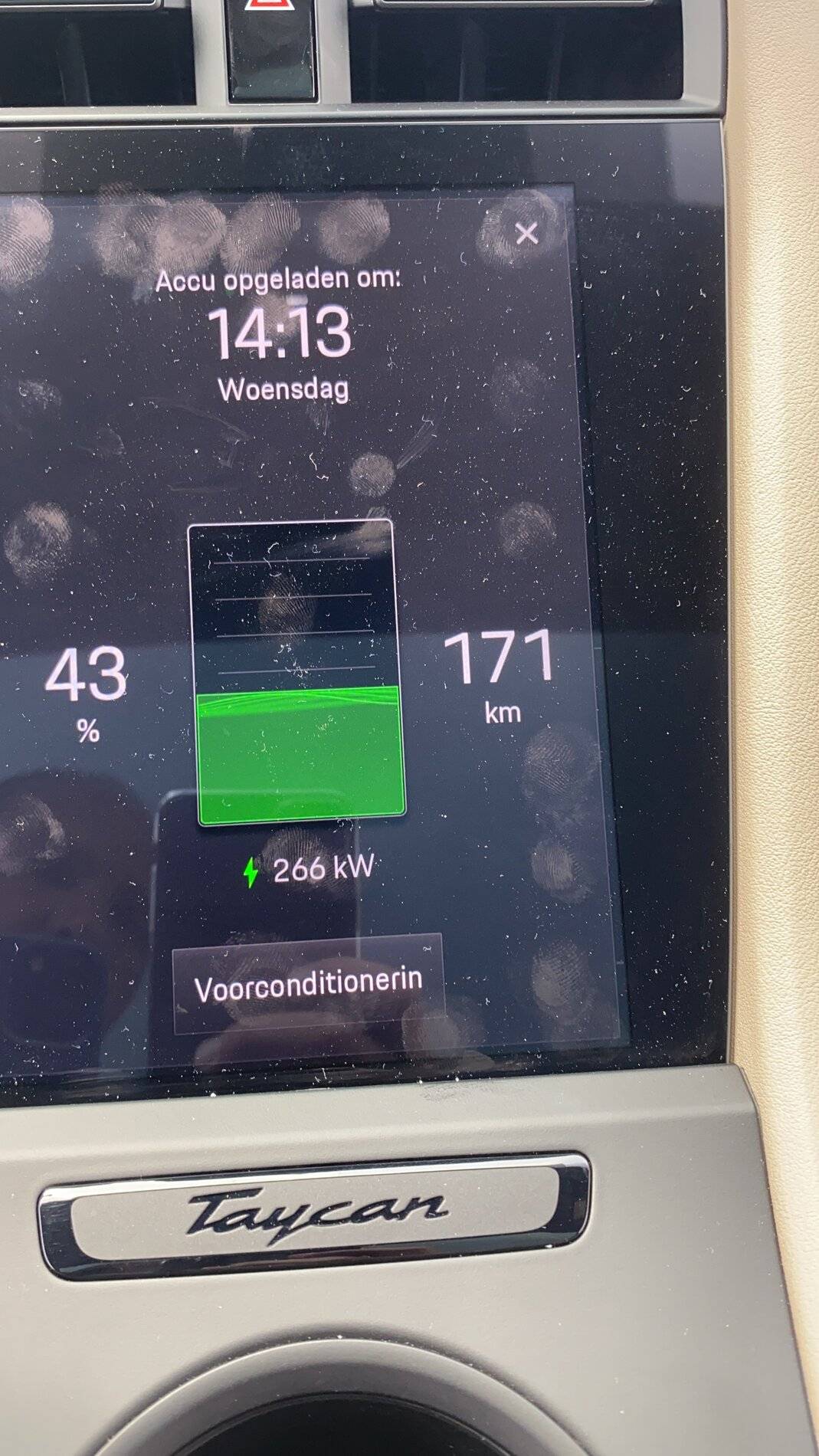

You have a 120kw on 800 V, since a few months. Pending on battery and t° outside, you can charge very quickly on a 350 kw charger.
I’ve loaded a taycan 4s who has 5% left at 267 kw/ h.
with a small trick you can charge some types of taycan at 290 kw, if you put your foot on the brake during charging.
I’ve never heard of 290kw being possible at all…can you explain this brake trick?
When the battery is between 5-20% you can put your foot on the brake and then you can charge up to 290kw. Not all models can, we are testing if it’s pending on certain options too.

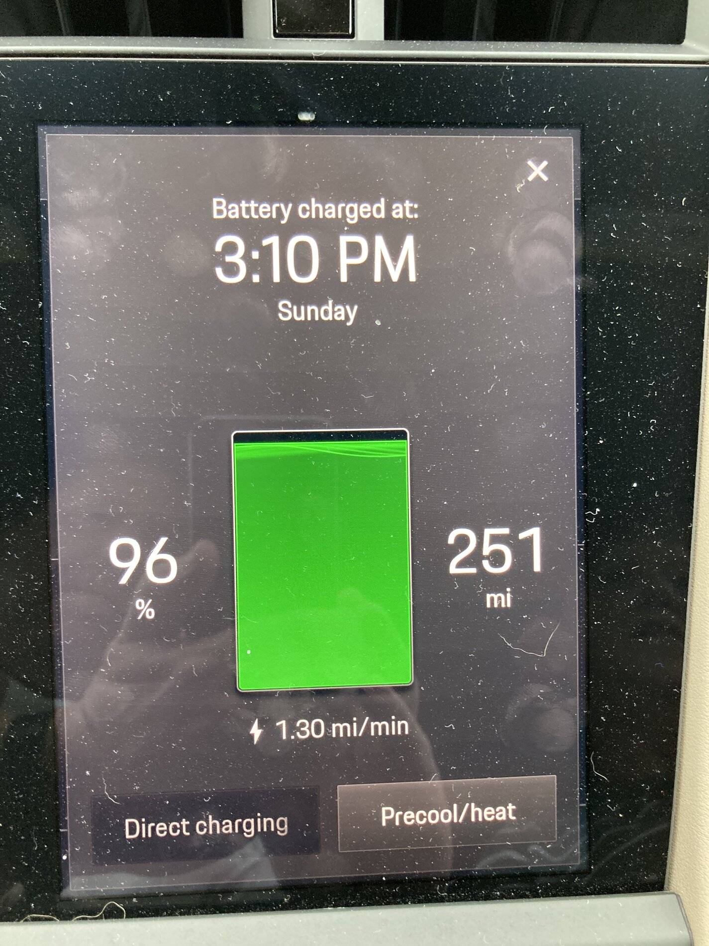

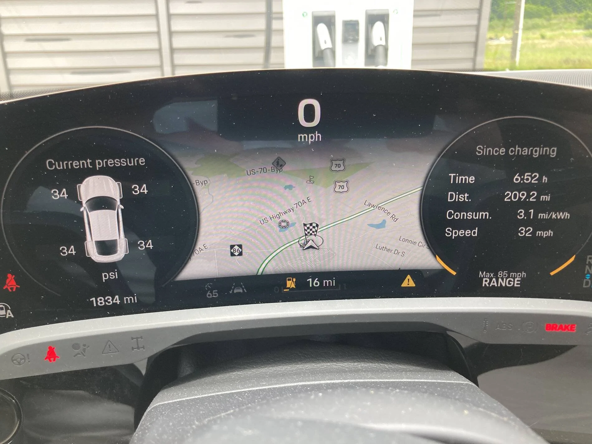

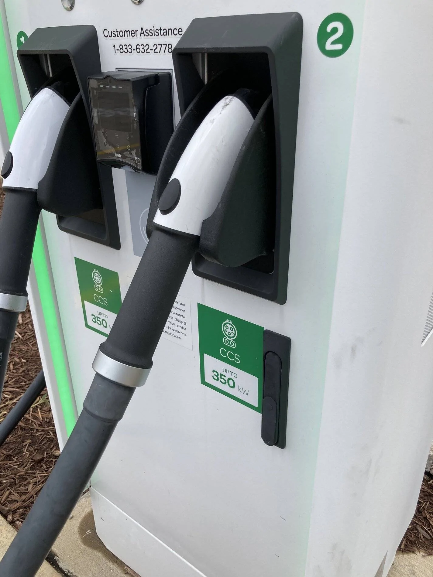

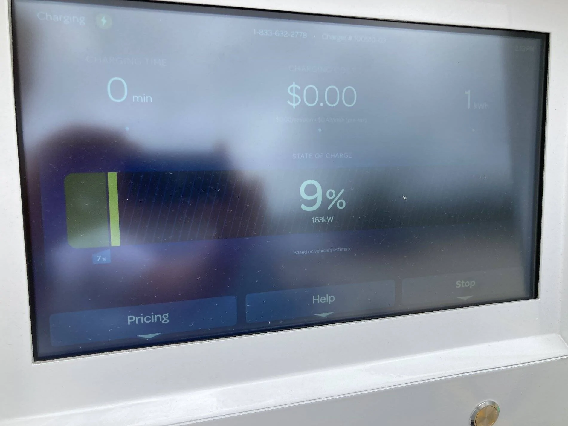

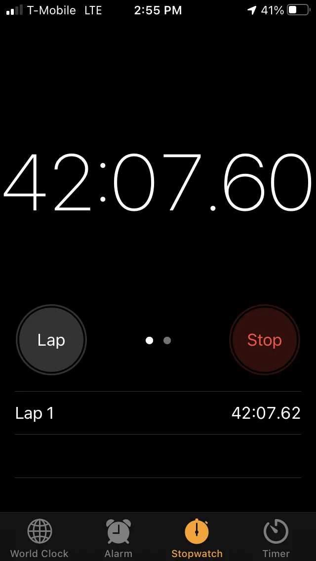

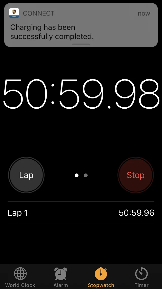

I’m going to have to try the “brake trick”. I’m preparing to take a trip from Raleigh NC to Chicago IL later this month. Since I will be entering some charging areas with <10% SoC and will need to charge upwards of 95+% for the next leg, I decided to perform a test at my local 350 kW EA Charger. I pulled in with 7% SoC and charged to 100%.
7% to 96% (~71.1 kW) took 42 minutes with an average pull of 101.4 kW for that duration.
The highest charge I saw was at around 22% SoC where it peaked at 166 kW (it may have went higher as I didn’t stare at the EA Charger the entire time)
I will note that I did see my highest battery temperature to date at 110 degrees Fahrenheit.
The last 4% (8.8 kW) took an additional 9 minutes (average pull of 58 kW) for a total of 51 minutes to go from 7% to 100%.
I have a base 2021 Taycan RWD with the 79.9 kWh standard battery.
Peaking at 166 kW on a 350 kW charger when starting at 7% SoC seems bad, am I missing something?
