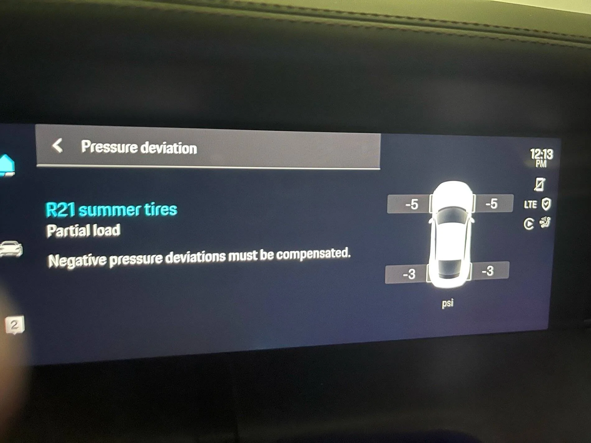

On a 2021 Taycan Turbo S, this popped up yesterday:
Porsche Taycan Ideal Tire Pressure for 2021 Taycan Turbo S on

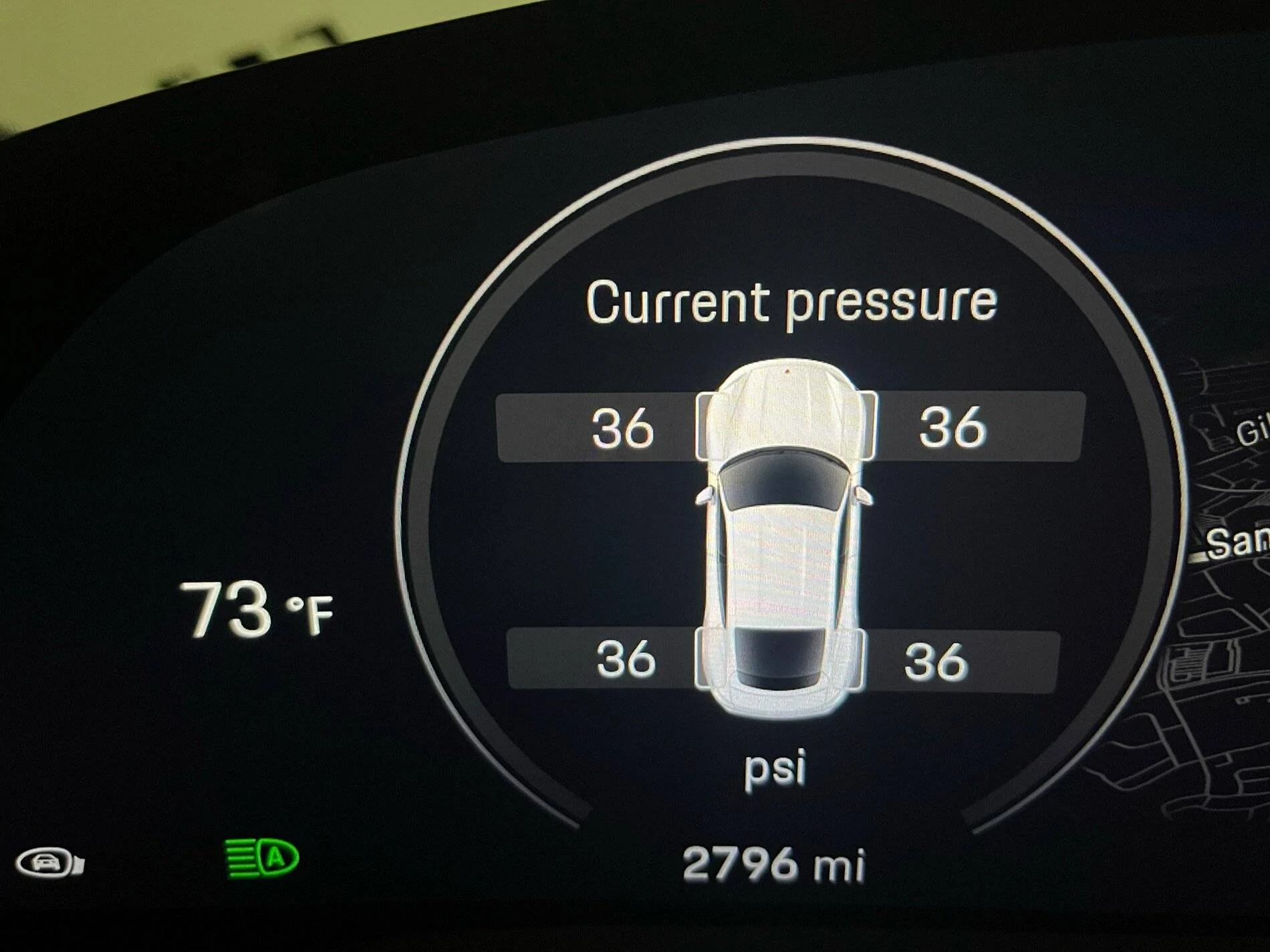

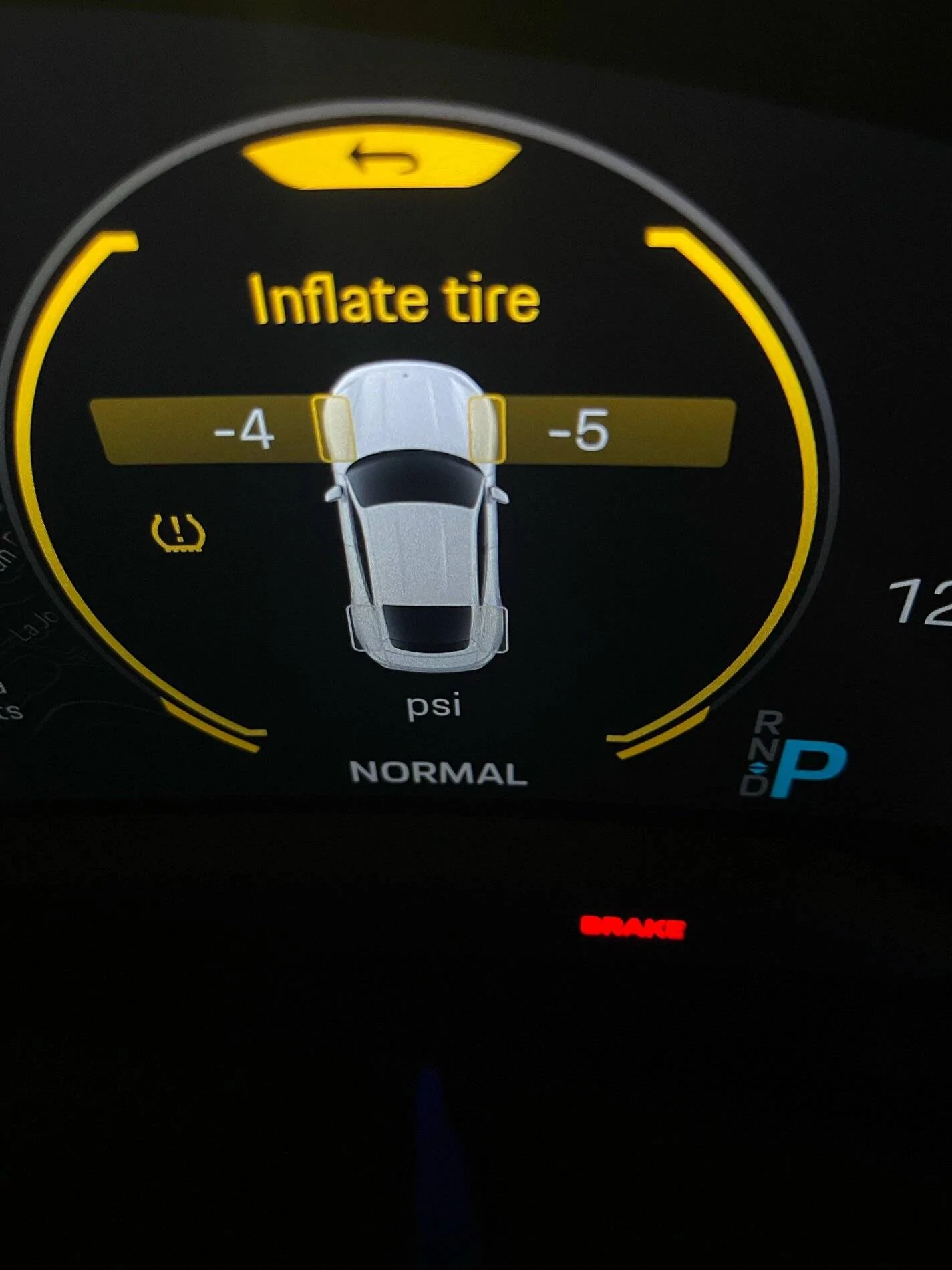

...then got a screenshot of the tire pressure indicator which showed...
Porsche Taycan Ideal Tire Pressure for 2021 Taycan Turbo S thr
...and also found this screen:
Porsche Taycan Ideal Tire Pressure for 2021 Taycan Turbo S two
So it looks like it wants me to put 41 in the fronts and 39 in the rears. Is that actually correct? It doesn't match the recommended tire pressures posted on the door sticker. It's also at odds with some of the material I've read on this forum.
I'm surprised that it wants a higher pressure in the fronts than the rear. Why is that? With my prior car (2015 911 Turbo S), it always seemed to want mid thirties for the front and mid forties for the rear.
Finally, what is "full load" mode? If the "full load" box is checked on one of the tire screens, it demands even more air be put in?
Sorry for the newb-level questions. Just want to make sure I understand what's going on here.

I run my Mission E all-seasons at 42 psi front, 44 psi rear, per door the sticker.
Full load is the rated maximum vehicle gross weight.
Found it: Gross Vehicle Weight Rating (GVWR) 6,349 lb

My dealer said to ignore the door sticker and trust what is listed on the main screen (assuming you have set the correct tire size and type of tire). So going by the dealer’s advice you should inflate all of your tires for everyday use as the screen suggests. Car should probably be more efficient afterwards as well.
I would define partial load as your everyday commute when you are along in the car and full load when you have the entire family in the car and loaded to the gills. Does the sticker not show two values for fully loaded?
And also yes…. First car I own where there is more pressure on the front than the back.

For Tire Pressures:
1) Download Porsche 'Good To Know' app
2) Select your MY21 Taycan in the Car configurator to download the manual
3) On Home Page search 'Tire Pressure'
4) Select 'Tire Pressure Tables'
5) Towards the bottom 1/2 of the document it will give you pressures for every size and summer/winter/allseason tire combinations for all models of the Taycan.
Taycan Turbo S with 2 seat (not 3 seat) with 21" Summer Tires partial load (just you not 4 people in the vehicle) ideally should be at:
Front Axel: 2.7 bar (39 PSI)
Rear Axel: 2.6 bar (38 PSI)
Full Load is:
Front Axel: 2.9 bar (42 PSI)
Rear Axel: 3.1 bar (45 PSI)
